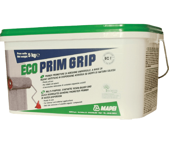

Mulberry View Posted April 22, 2020 Posted April 22, 2020 Firstly, before you flame me, I know this is not ideal but hear me out... I'm trying to put a bathroom together for a relatively low cost, it needs to do 1 year, maybe 2 (at which point the place will either be flattened or sold as a renovation project). It seems a little wasteful as it is, so I'm really trying to keep the costs down and can't contemplate getting a plasterer involved with the current restrictions. I've tried chipping the existing wall tiles off, they are SO SO hard and aren't keen to come off at all. It's against my morals, but I'd like to just go tile-on-tile for this one. I plan to key the surface up with a grinder to give the best chance. What adhesive would be best for this? Not sure if I'll be using Porcelain or Ceramic yet...

dave2878 Posted May 1, 2020 Posted May 1, 2020 what is behind the exisiting tiles , you need to think of weight , plaster takes about 16kg per m2 gyproc about 24 per m2 . double tiling will possibly take you over that , dont overboard existing tiles then tile , unless you can mechanically fix hardie backer to wall . if you do tile over existing tiles , mapie do a primer called ecopirime grip. use that then a powder adhesive like weber set plus or the the likes usually best just to strip out and board again , mostly leaves a better job. hope this helps
Mulberry View Posted May 29, 2020 Author Posted May 29, 2020 In the vein of helping someone else out in the future, we solved this using a fantastic product that I would highly recommend to anyone with the same dilemma. We found a product called Eco Prim Grip by Mapei. We bought it from Toolstation. It is designed for this purpose and is a paint on product with an added grainy aggregate that dries hard leaving it ready to accept a standard tile adhesive of your choosing. No preparation to the original tiles is needed. To validate its performance, I had to remove a couple of wrongly placed tiles after they had dried and I can confirm that the separation occurred between the tile and the adhesive, leaving the Prim Grip fully attached to the glossy surface of the old tiles. This stuff definitely solved our problem. 1
