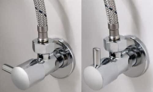

Carrerahill Posted April 17, 2020 Posted April 17, 2020 (edited) I watch an American plumbers YouTube channel, and the same as on the continent I see a lot of nice little wall mounted chome isolator taps that the flexi's come from and go into appliances, taps etc. Things like this: That is listed as a designer isolating valve, on Amazon, king of the cheap import tat (2 people have commented that they "exploded" and flooded properties - I could have told you that simply by the listing and the lack of decent info!), I am not filled with confidence, I want quality, Pegler, Hep, JG etc. at least WRAS approved stuff, I won't even buy the unbranded isolators from Screwfix, for the sake of a few £'s I want the recognised brands. I just feel that when mains water is involved you want to know it will stay in there, you wouldn't buy unbranded electrical kit so I think plumbing is the same. So, these sort of valves are not really done in the UK, we don't really go in for this look it seems which is a shame as I think it is a nice neat option and works well. So has anyone found good little isolators like this? Edited April 17, 2020 by Carrerahill

PeterW Posted April 17, 2020 Posted April 17, 2020 (edited) Popular in Italy and their brassware manufacturers make loads of them. Isolator Valve Edited April 17, 2020 by PeterW URL 1
Russell griffiths Posted April 17, 2020 Posted April 17, 2020 I did exactly this in Australia and intend doing the same again, there is a company called buteline from New Zealand who I think do all the bits as you need to supply a brass threaded wall plate to project through the wall for the isolator to screw to. Let me know now what you find as I’m keen to do the same as I cannot fathom the ad hock way it’s done over here. 1

SiBee Posted April 18, 2020 Posted April 18, 2020 Sure mine are Grohe? Nice feel to them and I too will not use unbranded due to bad experiences. I did get them from a German website though but they came in a couple of days. Will try and find the receipt. If I learn how to post pics I will put some up?....... just pressed attach file so hope that worked.
dpmiller Posted April 18, 2020 Posted April 18, 2020 why are the arrows pointing the wrong way on the cold flexy? 1
SiBee Posted April 20, 2020 Posted April 20, 2020 On 18/04/2020 at 08:46, dpmiller said: why are the arrows pointing the wrong way on the cold flexy? Good spot. Flex is same both ends and I intended to remove the paper label as it won’t last. Never been used since fitted as it’s a spare bathroom only went in to take the pics.
Carrerahill Posted April 22, 2020 Author Posted April 22, 2020 On 18/04/2020 at 08:17, SiBee said: Sure mine are Grohe? Nice feel to them and I too will not use unbranded due to bad experiences. I did get them from a German website though but they came in a couple of days. Will try and find the receipt. If I learn how to post pics I will put some up?....... just pressed attach file so hope that worked. Those are the boys... Looks smart.
