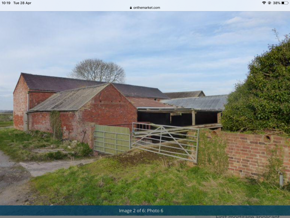

8 minutes ago, gc100 said:
It all depends what your budget is which you havent shared. Looking around my way something like this would fill your need perhaps https://www.rightmove.co.uk/commercial-property-for-sale/property-91578029.html
Budget is circa 450-500K for everything, be that, new build and barn, old farm and barn + refurb, modern AG barn + conversion. Norfolk is doable, as is west country. Really dont want to go north.
Thats quite a good deal on the face of it. Had the whole thing been enclosed that would fit the bill perfectly. As its only actually half the 18x18 its a no go to use as a workshop as well.
If ferdinand numbers are right, conversion would be 60-70K! Given it probably has no services, id guess that could go up quite a bit. Workshop aside on this particular one, it is, otherwise, ideal. What a great place to live.
My numbers were very much estimates, so may be well off, and are several years old.
But ask in the right places and numbers should be relatively easy to find.
