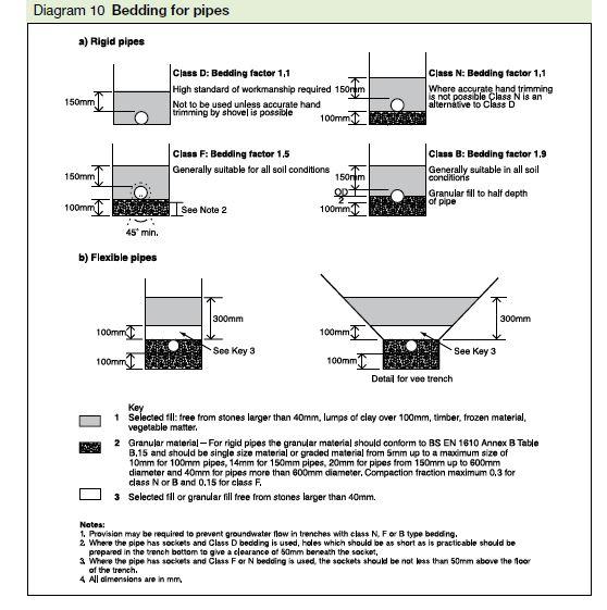

Bedding thickness for foul drainage pipe: how thick?
My recent re-aquaintace with the mark 1 shovel, MOT1, and Glacial Till has made me much more cautious about how deep to dig my foul drain trench.

How much shingle needs to be put under the drainage pipe? The guy from Osma says 100mm; is he right? I can't find any guidance that says it must be 100mm.

100mm by the way.

I am doing 100mm for the drains as in diagram 10 part b in Approved Document H

I really shouldn't be asking questions where the answer is in plain sight.
As penance.... here's  H1 Page 17
and I attach the relevant Approved Document (H1)
H_FoulWater.pdf
The gravel also makes it easier to level the bottom of the trench. I think it would be hard to keep the bottom of the trench flat enough to allow much less than 100mm.
