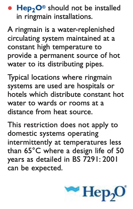

garrymartin Posted March 12, 2024 Posted March 12, 2024 On 24/02/2021 at 11:51, PeterW said: @Russdl That’s not a cast body - it’s a resin body by the looks of it so I would query the model number on the front as a resin body pump is suitable for potable water instead of a bronze body (and Wilo confirm this) And Hep2O can be used as a hot water return circuit. You have (incorrectly) read the guidance and don’t understand the BS/ EN definitions and I have had this confirmed by Wavin. For info the below is the definition they (Wavin) use for a hot water return circuit which you don’t meet on 2 of the 3 criteria so you have no issues. @PeterW Just wanted to add to Peter's excellent advice with the following graphic from the Hep2O Technical Manual as an additional resource for when people come across this thread in the future. It specifically mentions the design differences between locations and that domestic systems operating intermittently at less than 65 degrees are approved. 1 1
