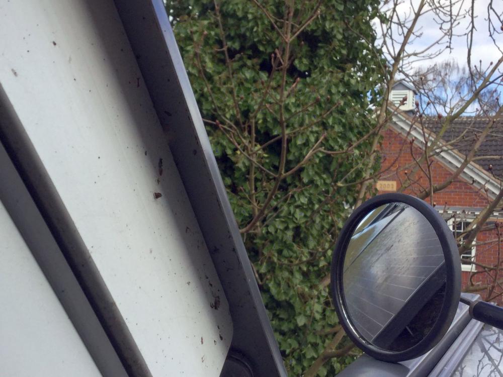

Ferdinand Posted May 23, 2016 Posted May 23, 2016 Some of the trees shading our solar pv have now been removed or pollarded. Now I can see better that some of our panels covered in pigeon productions. How to clean them? What do people here do? Our window cleaner offers a service using an extended wand, but his price is £2 per panel for a warm water clean, and for 35 panels that is a lot - even for the 15 or so with pigeon poo it is a lot. Suspect his prices are set for 8 panels on a house roof - ours are effectively on a bungalow roof and easier to reach. My current thought is for some kind of extending telescopic sponge mop following up a hose or power jet spraying an arc to avoid spraying under the tiles. Ideas would be most welcome. Thanks. Ferdinand

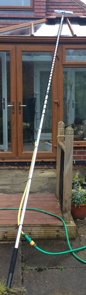

Ferdinand Posted June 4, 2016 Author Posted June 4, 2016 (edited) I don't like toddling about on roofs. The package: Edited June 4, 2016 by Ferdinand
Ferdinand Posted June 4, 2016 Author Posted June 4, 2016 (edited) And here is the pole, with one of the two extensions extended. Quite jury-rigged really - cable ties and hose connections, and the only unusual bits are the extending poll, the sprinkler head, and the 8mm coil pipe. It seems to be reasonably solid, but cumbersome as you would expect. Many people on here could put one together. Cost was about £120, and spares should be easy to come by. Personally I would prefer an extra 3m of hose attached to the handle, so my dodgy hose conenction is not so close to my clothes and feet. Edited June 4, 2016 by Ferdinand

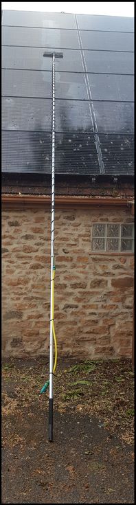

Ferdinand Posted June 4, 2016 Author Posted June 4, 2016 And this is the thing extended. That is 26ft, and tilted away at 50 degrees, albeit without a scale object. Seems to work well, but I think I will need a scrubber and in line detergent to get the first lot of ingrained poo off. Easy to use, though, and I can reach 6 panels up from the ground, which is better than clambering around on a 50 degree roof, which is not my idea of hilarity.

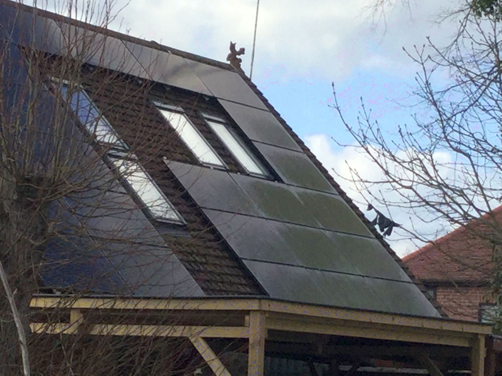

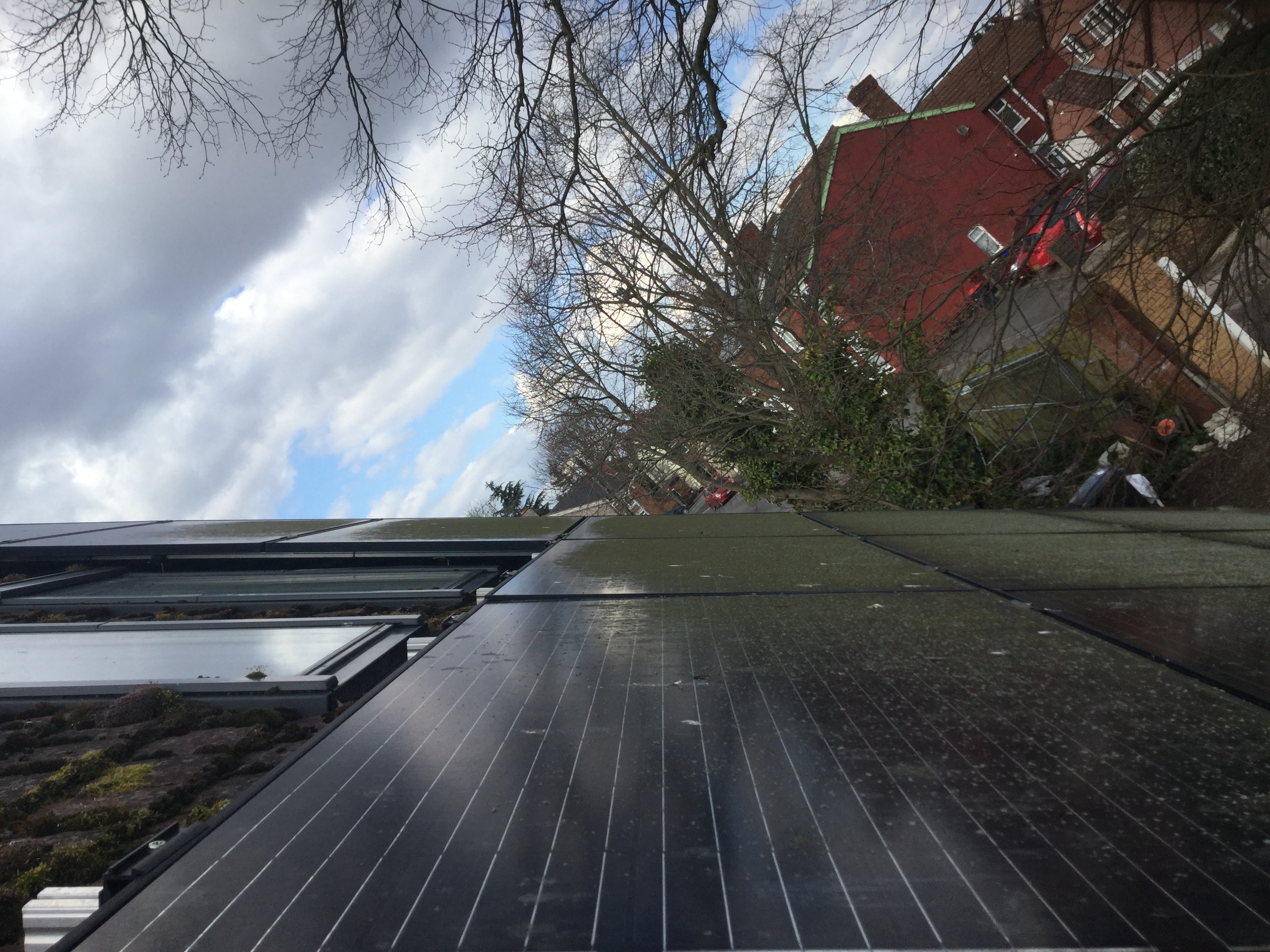

Ferdinand Posted March 26, 2018 Author Posted March 26, 2018 Bumping this thread. A few of my solar panels have now suffered serious attention from lichen and algae. They are under a tree and have got quite a lot worse over the winter. Now that we are nearly back in the serious generation season, they need some attention. There are a couple of photos. The bottom of the array is at about 2.3m from the ground, so access is not that difficult. I may be able to reach most of them by hand with care. Questions: 1 - Is there a cleaning agent I can add to my long hose-connected solar panel cleaning pole (see start of thread)? Mild bleach? Vinegar? 2 - Is there any kind of copper tape that I can add to each panel to help keep then clean in future? I am wondering about either adhesive tape (eg the sort to control slugs) or perhaps copper wire as used on roofs. Thanks
Jeremy Harris Posted March 26, 2018 Posted March 26, 2018 I found a bit of ordinary detergent helped with the aid of a water fed brush. I'd be very wary of using copper, as the frames of PV panels are aluminium, and they are practically at the opposite ends of the electrochemical series, so there is a strong probability that this would induce corrosion of the alloy frames. After cleaning, you could try spraying the panels with a copper sulphate solution. With luck this will kill off any lichen residue and slow regrowth. I've found that copper sulphate can work surprisingly well at killing lichen and moss, although it doesn't last forever. With luck, it may inhibit regrowth for a year or two, and it's safe to re-spray the panels with copper sulphate solution annually if you want to try and prevent regrowth. When sprayed on concrete tiles, copper sulphate solution can keep the tiles lichen and moss free for a few years I've found. It seems that the copper sulphate soaks into the tiles and acts to prevent lichen regrowth for a fairly long time.
