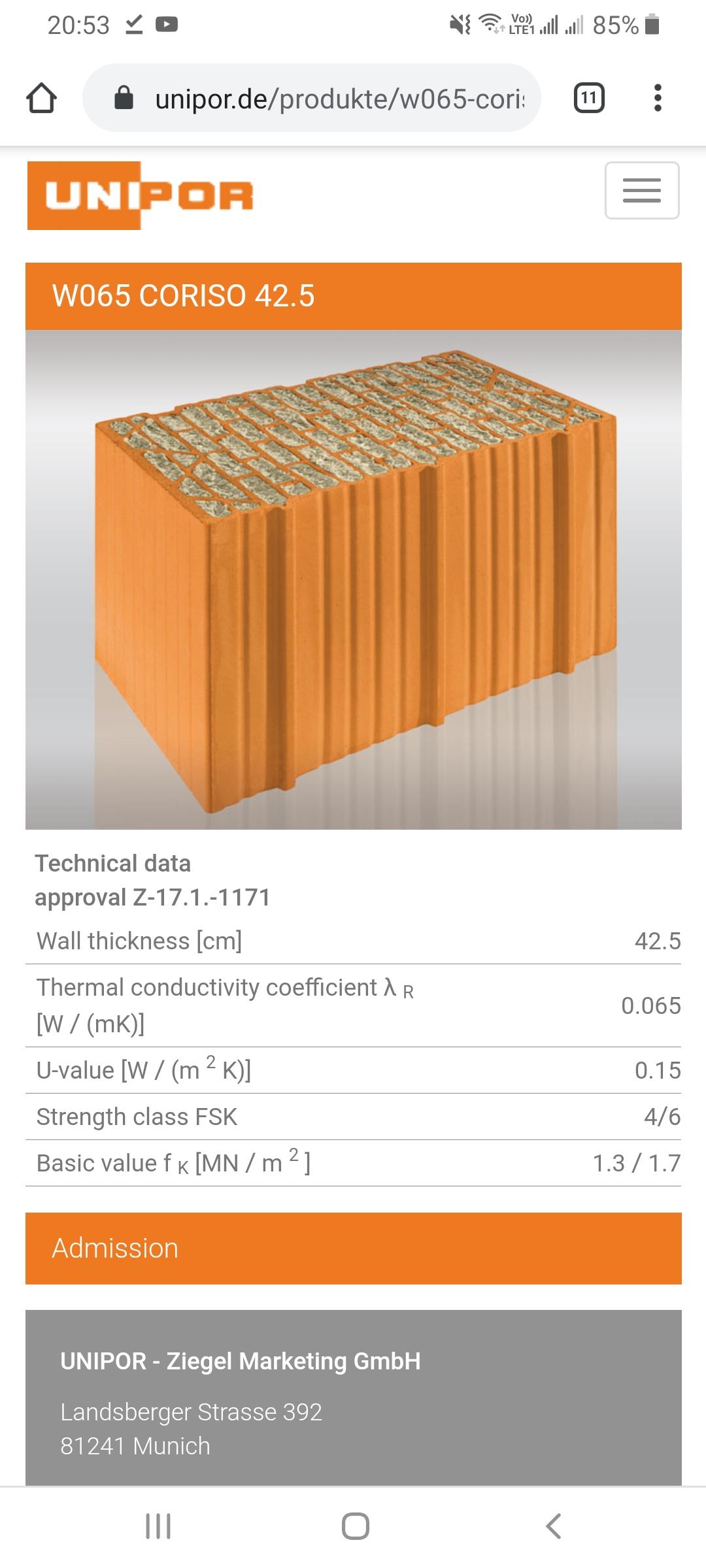

scottishjohn Posted March 29, 2020 Share Posted March 29, 2020 (edited) like this https://www.archiproducts.com/en/products/leipfinger-bader/thermal-insulating-clay-block-unipor-w07-coriso_117261 this one says 0.06W/mk vlaue Edited March 29, 2020 by scottishjohn Link to comment Share on other sites More sharing options...
Torchia Posted March 29, 2020 Author Share Posted March 29, 2020 3 hours ago, scottishjohn said: like this https://www.archiproducts.com/en/products/leipfinger-bader/thermal-insulating-clay-block-unipor-w07-coriso_117261 this one says 0.06W/mk vlaue I believe you took a wrong figure. U value of these are 0.15 Link to comment Share on other sites More sharing options...

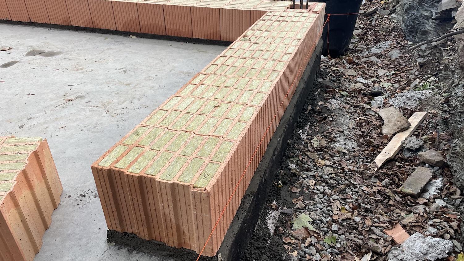

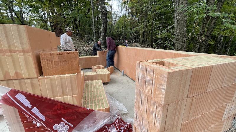

Gary in New York Posted September 21, 2022 Share Posted September 21, 2022 Did you stick with Dan and use the Porotherm blocks? I'm starting to build my home and using their 365mm insulated blocks. Struggling to overcome issues from being the first person in the US to build with them, and to have a monolithic wall when codes all speak about the R value of the 'envelope' and continuous insulation, which my architect thinks they don't qualify for. Looking for anyone with actual experience. Thanks. Link to comment Share on other sites More sharing options...
Lilly_Pines Posted September 23, 2022 Share Posted September 23, 2022 On 21/09/2022 at 22:07, Gary in New York said: Did you stick with Dan and use the Porotherm blocks? I'm starting to build my home and using their 365mm insulated blocks. Struggling to overcome issues from being the first person in the US to build with them, and to have a monolithic wall when codes all speak about the R value of the 'envelope' and continuous insulation, which my architect thinks they don't qualify for. Looking for anyone with actual experience. Thanks. Continuous insulation applies to wood frame walls. From a quick look I think you'd need to use the R-values for mass walls: https://up.codes/viewer/new_york/irc-2018/chapter/11/re-energy-efficiency#N1102.1.2 The requirement is for an R-value of 8-21 depending on your climate zone and whether they consider the wall as having insulation on the inside. Obernburg looks to be zone 6 so R=21 would meet the requirements; Porotherm T7 365mm gives me a US R-value of around 31 with a quick and dirty calculation so you should be fine by the code. With the winters over there being as cold as they are I'd consider thicker blocks as an option if you aren't already committed to 365mm, but even 365mm seems to be 50% more than the minimum requirement. I'm a bit worried about whether your architect is the best choice for the project if they didn't know this (or didn't know how to look it up), and would take care to double-check everything else to make sure they didn't miss other important differences between clay block and stick frame construction. Disclaimer: I don't have actual experience but I've read a lot of https://www.buildingscience.com/ and know how to read technical text like building codes. I've researched clay blocks as one option for my house and I'm happy to answer questions with the aforementioned caveat that I mostly know things theoretically. Link to comment Share on other sites More sharing options...
Gary in New York Posted September 24, 2022 Share Posted September 24, 2022 23 hours ago, Lilly_Pines said: Porotherm T7 365mm gives me a US R-value of around 31 with a quick and dirty calculation so you should be fine by the code. The builder repping Porotherm who is helping me has said the 365mm insulated blocks are between 21 and 22 US R value. Can you show me how you came to 31? Thanks Lili 23 hours ago, Lilly_Pines said: I'm a bit worried about whether your architect is the best choice for the project No question, but too late now. I had my own Rescheck done and the envelope did fine, based on my input of R21 for the walls. We're way above minimums in all other areas. Link to comment Share on other sites More sharing options...

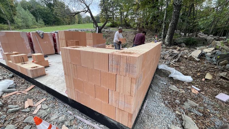

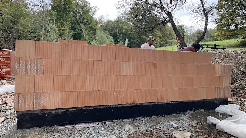

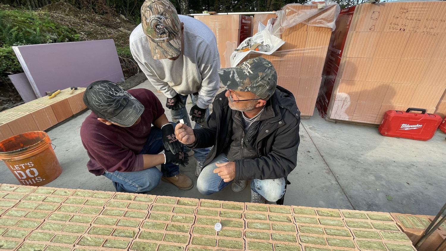

Gary in New York Posted September 24, 2022 Share Posted September 24, 2022 With my French consultant and two experienced (but typical mason helpers- who never saw Porotherm) it took one day to dry set the exterior walls of the garage and will take one and a half days to cement the first course (about 113' linear feet). Because there is no cement between layers (besides the first) the first layer must be absolutely precise. Using too wet cement that might shrink even just the thickness of a piece of paper sends the level far off Link to comment Share on other sites More sharing options...
scottishjohn Posted September 24, 2022 Share Posted September 24, 2022 (edited) 14 minutes ago, Gary in New York said: Because there is no cement between layers (besides the first) the first layer must be absolutely precise. ao how do yhey bond to next layer and is it a viable cost comparison to going timber frame, as with my build I am building another house inside an old granitr building anbody got a link to them in uk Edited September 24, 2022 by scottishjohn Link to comment Share on other sites More sharing options...
Mr Punter Posted September 24, 2022 Share Posted September 24, 2022 @Gary in New YorkI haven't seen the mineral wool infilled Porotherm blocks over here. How much are they per m2 in the US? 365mm is very thick without any finishes. Also the first mortar bed looks really thick. Is that what they specify? I appreciate it is just adhesive from there upwards. Do keep posting as it is interesting to see how it works. Link to comment Share on other sites More sharing options...
scottishjohn Posted September 24, 2022 Share Posted September 24, 2022 6 minutes ago, Mr Punter said: @Gary in New YorkI haven't seen the mineral wool infilled Porotherm blocks over here. How much are they per m2 in the US? 365mm is very thick without any finishes. Also the first mortar bed looks really thick. Is that what they specify? I appreciate it is just adhesive from there upwards. Do keep posting as it is interesting to see how it works. mineral wool --why not PIR foam surely Link to comment Share on other sites More sharing options...
Mr Punter Posted September 24, 2022 Share Posted September 24, 2022 2 minutes ago, scottishjohn said: mineral wool --why not PIR foam surely Well the photos look like mineral wool. Link to comment Share on other sites More sharing options...
scottishjohn Posted September 24, 2022 Share Posted September 24, 2022 21 minutes ago, Mr Punter said: Well the photos look like mineral wool. "Iknow nothing -I.m from barcelona Mr faulty" 2 Link to comment Share on other sites More sharing options...
joe90 Posted September 24, 2022 Share Posted September 24, 2022 (edited) Or beads poured in (as long as it’s not windy eh!). All I know about them is they are glued together in the horizontal but there appears to be no “glue” in the vertical joints, yes they are staggered but not air tight so draughty??? Edited September 24, 2022 by joe90 Link to comment Share on other sites More sharing options...
Lilly_Pines Posted September 24, 2022 Share Posted September 24, 2022 4 hours ago, Gary in New York said: The builder repping Porotherm who is helping me has said the 365mm insulated blocks are between 21 and 22 US R value. Can you show me how you came to 31? Thanks Lili Those blocks look like Porotherm T7 MW which has a lambda value of 0.07 W/mK. Over 365mm this creates a U value of 0.19 W/m2K. The reciprocal of this is a metric R-value of 5.21. Coverting this to US units with 1 K⋅m2/W = 5.56 BTU/(h⋅°F⋅ft2) gives 29. A metric U of 0.18 gives US R value of 31. If they have a lambda of 0.08 W/mK the metric U value would be 0.22, the metric R value 4.54, and the US R value 25. Link to comment Share on other sites More sharing options...
