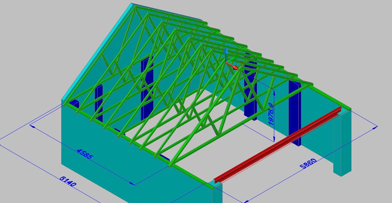

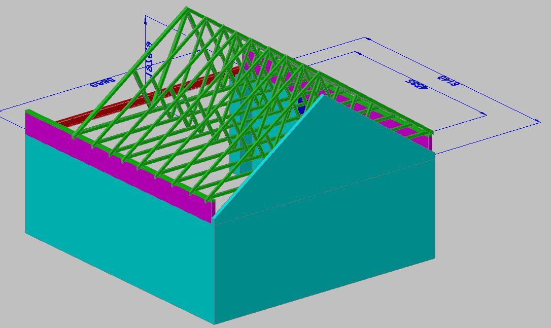

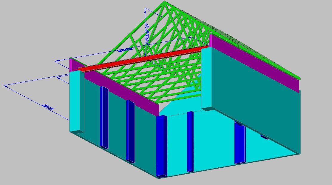

Onoff Posted April 10, 2020 Share Posted April 10, 2020 If I were to raise the walls by say 500mm, like this: I've still only got nom 1976mm from the top of the horizontal truss member to the underside of the apex. Hardly tall enough for a "room in the roof" even for storage: It'd be fun too, building up the 4" block, gable wall: Link to comment Share on other sites More sharing options...
scottishjohn Posted April 11, 2020 Share Posted April 11, 2020 8 hours ago, Onoff said: I've still only got nom 1976mm from the top of the horizontal truss member to the underside of the apex. Hardly tall enough for a "room in the roof" even for storage: you can,t have a room with those sort of trusses anyway Link to comment Share on other sites More sharing options...
