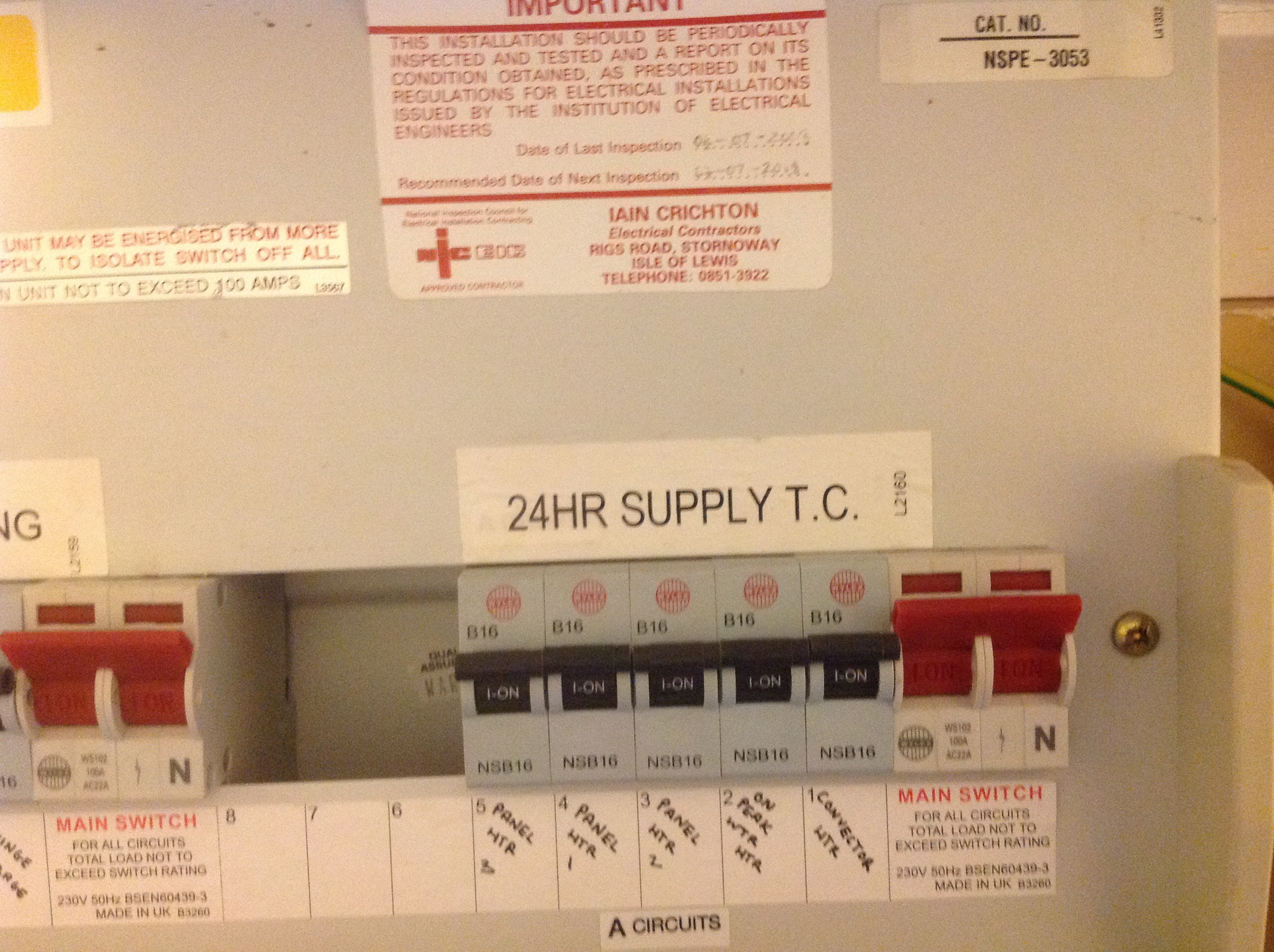

November 22, 20169 yr Our (current) house is all electric, on the 'Total Control' system. This means that we have two rates, one for space and water heating, and one for everything else. Currently we heat DHW using an electric immersion, but this is horribly inefficient as the small tank sits in a cold loft space and loses heat quickly. It also leads go a rather unpleasant showering experience. With SWMBO's words ringing in my ears ('dearest sweetheart, might you perchance be able to put your mind towards installing an electric shower, just when you get the chance.'- OK I'm paraphrasing as her actual words are not printable) I would like to install a basic electric shower. Question is- can I just buy a big enough breaker and stick in the existing CU? In our previous house there was a mini CU especially for the shower. I know these aren't that expensive but just wondering if it's needed or not?
November 22, 20169 yr 48 minutes ago, Crofter said: It also leads go a rather unpleasant showering experience. So could the alternative if it is not sized right and your water pressure is not good/consistent enough. I can't think of any reason why you cannot change the breaker. You will need an RCD (or an RCBO) as it is shower. What power shower where you thinking of fitting?
November 22, 20169 yr Author Even a rubbish little electric shower will be better than what we have, believe me. Water pressure is excellent. Was assuming around 9kW, but whatever the supply allows me to do,

November 22, 20169 yr An RCBO isn't the best option, as for a wylex board they are only single pole, best fit an MCB and an external RCD, Are the main earth bonds in place,? 10mm?
November 22, 20169 yr Author 34 minutes ago, Steptoe said: An RCBO isn't the best option, as for a wylex board they are only single pole, best fit an MCB and an external RCD, Are the main earth bonds in place,? 10mm? Erm, I may need some of this translated What do you reckon I need to buy, and is it expensive? Will probably get the sparky up the road to do the job (legal requirement anyway for this sort of job, no?) but as this is potentially only a temporary setup don't want to be forking out too much...
November 22, 20169 yr I have separate MCB and RCD units fitted on outside of bathroom wall. I seem to remember they were about 40 quid. Then you will need a large cable to the shower unit and probably some trunking to hide it.
November 22, 20169 yr Parts won't be much if you fit something like this. I'm not saying this but it'll give you an idea: http://www.toolstation.com/shop/Electrical/d190/MK+Consumer+Units/sd3134/MK+Shower+Consumer+Unit+IP65/p80581 You need to consider the chosen shower's load, cable length and how it's routed to gauge the cable size required, isolation switch position etc. BUT this really is one where you don't want to be doing it yourself. Leccy + water + kids etc. One of the biggest loads in a house.
November 22, 20169 yr What nobody has picked up yet, is you have "total control" a Tariff I believe unique to Scotland and no longer available to new customers. It's a bit like Economy 10 in that the the storage heaters and the whole house gets cheap rate for 10 hours a day. BUT it has one BIG advantage that the "A circuits" are always on, and always metered at the cheap rate. These are supposed to only be used for "heating appliances" and typically you will find panel heaters in bedrooms connected here. But you are also allowed to connect water heaters and Showers. So all you need is a wylex 40A rcbo and you can have cheap rate showering 24/7. You lucky b%%$$"£$£$£
November 22, 20169 yr Author Thanks, Dave. Something like this? http://www.toolstation.com/shop/p14865?utm_source=googleshopping&utm_medium=feed&utm_campaign=googleshoppingfeed&mkwid=s3Z3fpJI3_dt&pcrid=99808204703&pkw=&pmt=&product=14865&gclid=CPaSkKXtvNACFcsV0wodTSQMUg
November 22, 20169 yr Is he on a TT supply? Agree with Steptoe, a 40A mcb in the CU and a 2 pole 2 module rcd in a separate enclosure would be better.
November 22, 20169 yr 40 minutes ago, Crofter said: What's a TT supply? Sorry, we're interested in your earthing system as it can impact on the new circuit. Likely to be one of 3 types. Rather than go in to chapter and verse and on the basis a picture says a thousand words you have a pm

November 23, 20169 yr 6 hours ago, Crofter said: Oh by the way the only real alternative that I am considering is to fit an inline water heater rather than an electric shower. But I assume that this makes no odds to the electrics side of things? It would usually mean putting a 50a breaker and a 10mm cable minimum, bigger if the run is long. Some of the higher flow units are up at between 12 and 15kw, with the baby units around 9kw. Wattage divided by voltage gives you the current ( as a rough guide ), then allow diversity factor. 1 hour ago, Onoff said: I have a pumped shower and it runs off a 25gal cws tank. Says so in the instructions that this is the minimum size. Seems to work alright. Your supposed to add to the volume of CWS storage when you add a point of consumption The main problem is when your shower empties most, but not all, of the water from the tank and then the splashing water entering the tank stirs up the silt etc at the bottom of the tank. That then gets pulled into the filters of such devices and causes premature failure / excessively high maintenance intervals. The hot water cylinder requires a min of 25 gal and the shower the same, so running off one 25 gal tank will work if you don't shower excessively long or no one is using hot water at the same time, but is not recommended as it doesn't allow any redundancy / for the CWS not to be regularly depleted.
