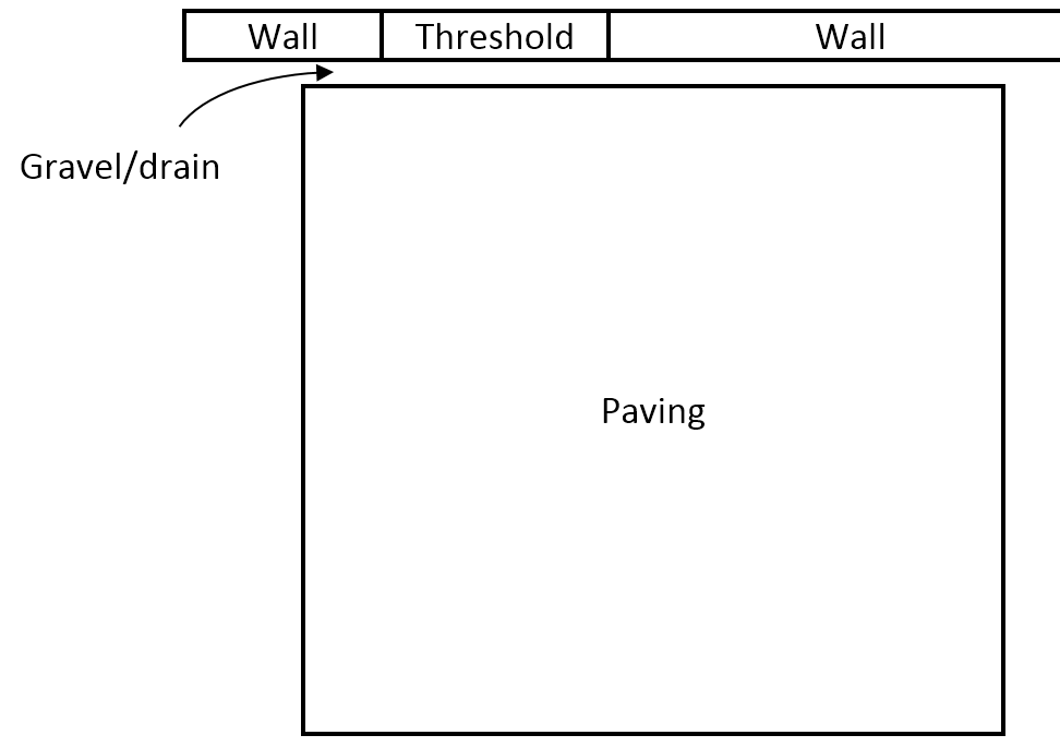

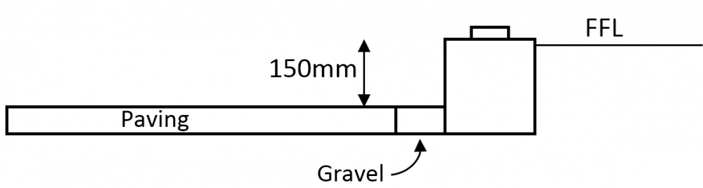

jack Posted November 20, 2016 Share Posted November 20, 2016 Hi all Slowly working my way through our remaining to-do list for sign-off and have hit the access requirements of Part M. To be honest, I've been putting off dealing with this, as I know we're going to at least incur some annoying costs. My preference would be to have a collapsible ramp that we can put in front of our step if anyone in a wheelchair ever comes to our house, but I suspect our (private) building inspector won't go for that! So before I talk to him about this, does anyone have any experience in this area? Quick explanation of what we have at the moment: there's a large, flat paved area that a car can drive up onto, with plenty of space for a wheelchair user to exit the car. I believe that satisfies the approach requirements. The paved area is about 150mm below the highest point of the threshold, which in turn is about 10mm above the finished floor level. There's an 80mm gap filled with gravel between the threshold and the paving that allows any water making it near the door (there's quite a large overhang) to drain away. Here are some very rough not-even-close-to-scale drawings (plan followed by section): I clearly need some sort of ramp to allow a wheelchair user access. Looking at, eg, the NHBC's guidance document, I should be building a 3m long ramp at 1:20, but that would be ridiculous in the circumstances. There are alternatives given for steeper ramps with landings, which would shorten the necessary ramp, although then I'd need to include a landing just outside the threshold which will leave me not much short of a 3m approach anyway! So what options are realistically available? The simplest one would be a temporary ramp made out of, eg, wood. That would strictly satisfy the requirements, although I suppose the inspector could argue that it's clearly a temporary structure and refuse to sign it off. I know someone (Jeremy?) knew of someone who cast a temporary ramp out of weak concrete and demolished it after completion, but that seems a lot of work and waste. Before I talk to the inspector, does anyone have any thoughts or ideas? Many thanks Link to comment Share on other sites More sharing options...

Stones Posted November 20, 2016 Share Posted November 20, 2016 34 minutes ago, Sensus said: My first and usual solution would be to grade the level of the drive/hardstanding up to meet the internal floor level, and address bridging of the DPC by other means (eg. a channel drain with a cover grille, or even just keep the level of the gravel 150mm below that of the paving and threshold). That's what we have done. I didn't like the idea of the access requirements when they came in (primarily I think because of the truly horrific looking efforts being constructed in the early days), however, having lived with level access in a number of houses now, I have grown used to the practicality of them Great when the kids were young, and casting my mind back seeing my parents struggling to get a wheelchair bound relative out of the house down just one step,convinced me that it really is a small price to pay. If you really want the visual appearance of a grand stepped entrance, put the level access at an alternative door. 1 Link to comment Share on other sites More sharing options...
Guest Alphonsox Posted November 20, 2016 Share Posted November 20, 2016 52 minutes ago, Sensus said: My first and usual solution would be to grade the level of the drive/hardstanding up to meet the internal floor level, and address bridging of the DPC by other means (eg. a channel drain with a cover grille, or even just keep the level of the gravel 150mm below that of the paving and threshold). Pretty much what we're intending. Some ramps look ugly but if the rise is spread over a large enough area the it isn't noticeable Link to comment Share on other sites More sharing options...
ProDave Posted November 20, 2016 Share Posted November 20, 2016 It amazes me just how many new houses I see around here where the whole ground level at the front has been raised to floor level to give level access. It clearly must be bridging the DPC as there is seldom any effort to separate the ground from the wall. In my case I have left a large French Drain. I did talk to my BCO about putting the ramp at the back but he referred me to the "access to principle entrance not reasonable" bit. Just because you don't like the look of a ramp is not justified reason to put it around the back, there has to be more of a technical issue at the front before you can do that. 1 Link to comment Share on other sites More sharing options...

MrP Posted November 20, 2016 Share Posted November 20, 2016 You can get away with a ramp not exceeding 1:15 as long as it is less than 5m long and you have a 1200mm x 900mm flat platform in front of the door. However if a ramp is not practical due to the level differences or geography of the site then a max 150mm step in to the property at the door is also an reasonable and acceptable solution. The building regs is a guidance document only and the part m list a heirarchy of preferred options with a level approach at the top, then ramp then step, then flight of steps. However as long as the approach meets one of the solutions in the before mentioned NHBC document then it still complies - your BCO can advise and give their preference but can not insist on one solution over another. 1 Link to comment Share on other sites More sharing options...

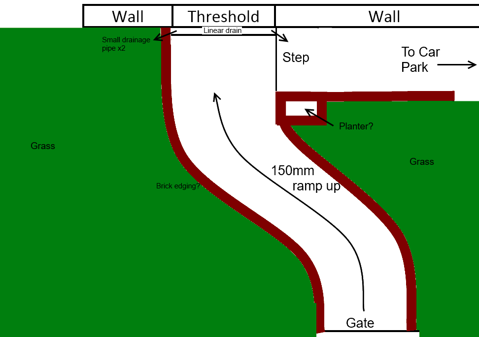

Temp Posted November 21, 2016 Share Posted November 21, 2016 Would something like this work.. Hide the ramp in the garden path. It's only 150mm... Link to comment Share on other sites More sharing options...
