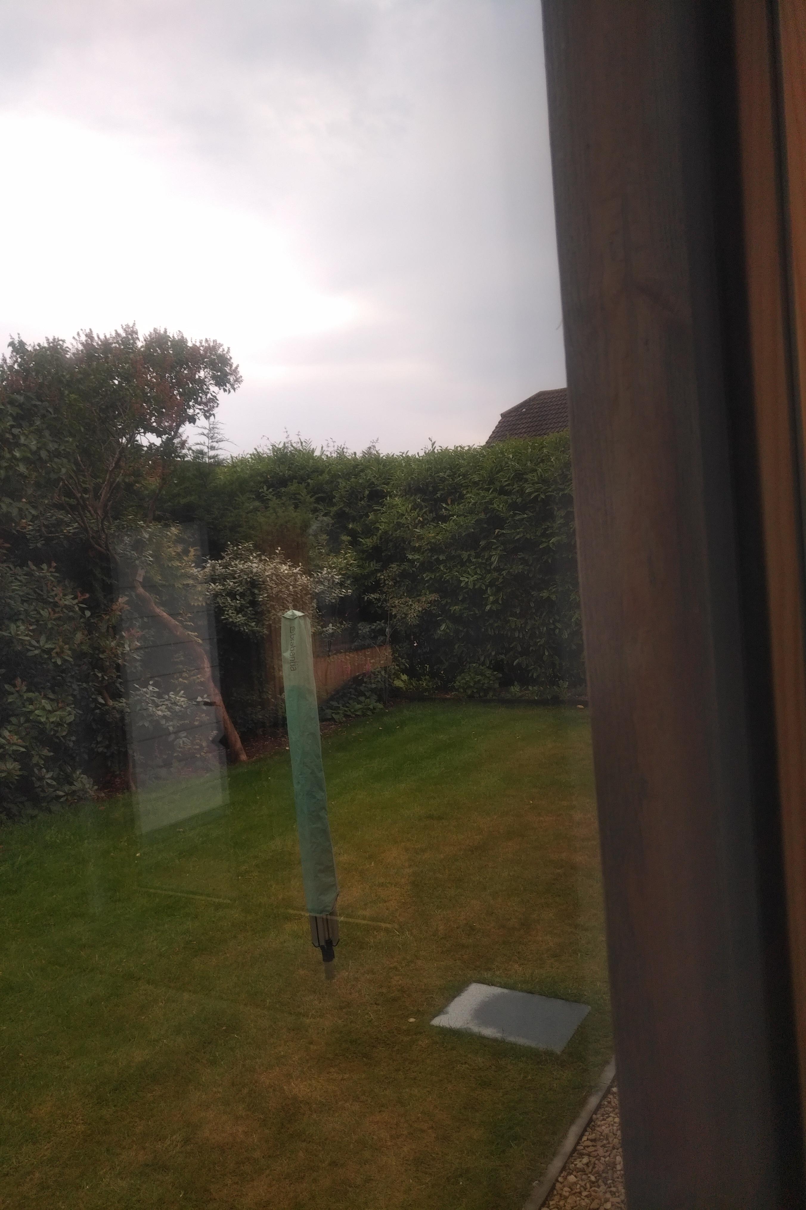

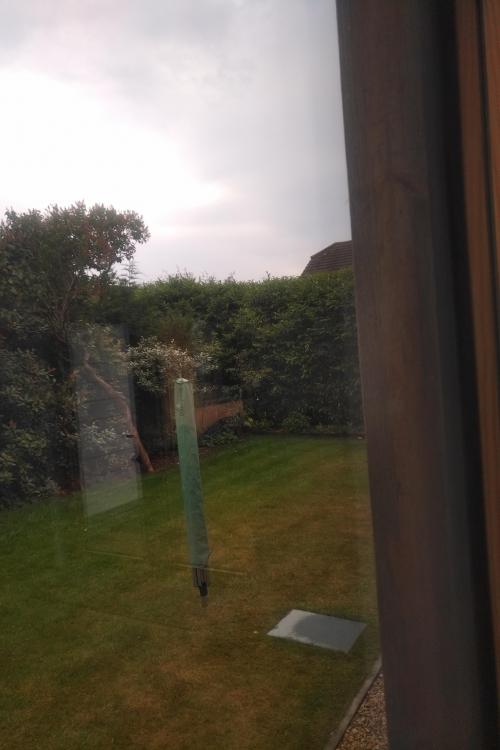

tanneja Posted June 3, 2020 Share Posted June 3, 2020 @NSS, I spoke with an internorm distributor this week, and asked about sage glass. They remarked that when when clear, if you try to look through the glass at an angle (i.e. not perpendicular), then view starts to get obscure, to the point of totally obscure as you get closer to parallel. Is this your user experience? His stance was that it was a product not suited to house external windows. Link to comment Share on other sites More sharing options...
tanneja Posted June 3, 2020 Share Posted June 3, 2020 @canalsiderenovation yes please if you are happy to share it would be reassuring Link to comment Share on other sites More sharing options...
NSS Posted June 3, 2020 Share Posted June 3, 2020 6 hours ago, tanneja said: @NSS, I spoke with an internorm distributor this week, and asked about sage glass. They remarked that when when clear, if you try to look through the glass at an angle (i.e. not perpendicular), then view starts to get obscure, to the point of totally obscure as you get closer to parallel. Is this your user experience? His stance was that it was a product not suited to house external windows. Then I can only tell you that he's talking out of his anal orifice. Just taken this with camera held virtually parallel to the glass. Link to comment Share on other sites More sharing options...
tanneja Posted June 3, 2020 Share Posted June 3, 2020 @NSS what is the guy smoking?! It must be a different product, despite me saying sage glass specifically. Thank you for the clarification. I have asked about an integrated tint (SKN 176 II) but that comes with the dull weather drawback, I want to see how they price relative to each other. Even with Sage Glass, and presumably good insulation throughout the house (and MVHR?), do you think active cooling is necessary for you to feel totally comfortable? Link to comment Share on other sites More sharing options...
NSS Posted June 3, 2020 Share Posted June 3, 2020 28 minutes ago, tanneja said: @NSS what is the guy smoking?! It must be a different product, despite me saying sage glass specifically. Thank you for the clarification. I have asked about an integrated tint (SKN 176 II) but that comes with the dull weather drawback, I want to see how they price relative to each other. Even with Sage Glass, and presumably good insulation throughout the house (and MVHR?), do you think active cooling is necessary for you to feel totally comfortable? Yes, and we have used it on odd occasions (for example last year when we had temps hitting 30C+). Reasonably well insulated (circa 0.14 floor, wall and roof, and 0.7 glazing) and Paul Novus MVHR. Also, bear in mind that we have relatively modest glass areas - more than you might find in a typical developer built home but we don't have huge glazed walls. Using SG for the latter would not only be expensive but may not be as effective in reducing overall solar gain so I would suggest active cooling may be essential. Link to comment Share on other sites More sharing options...
