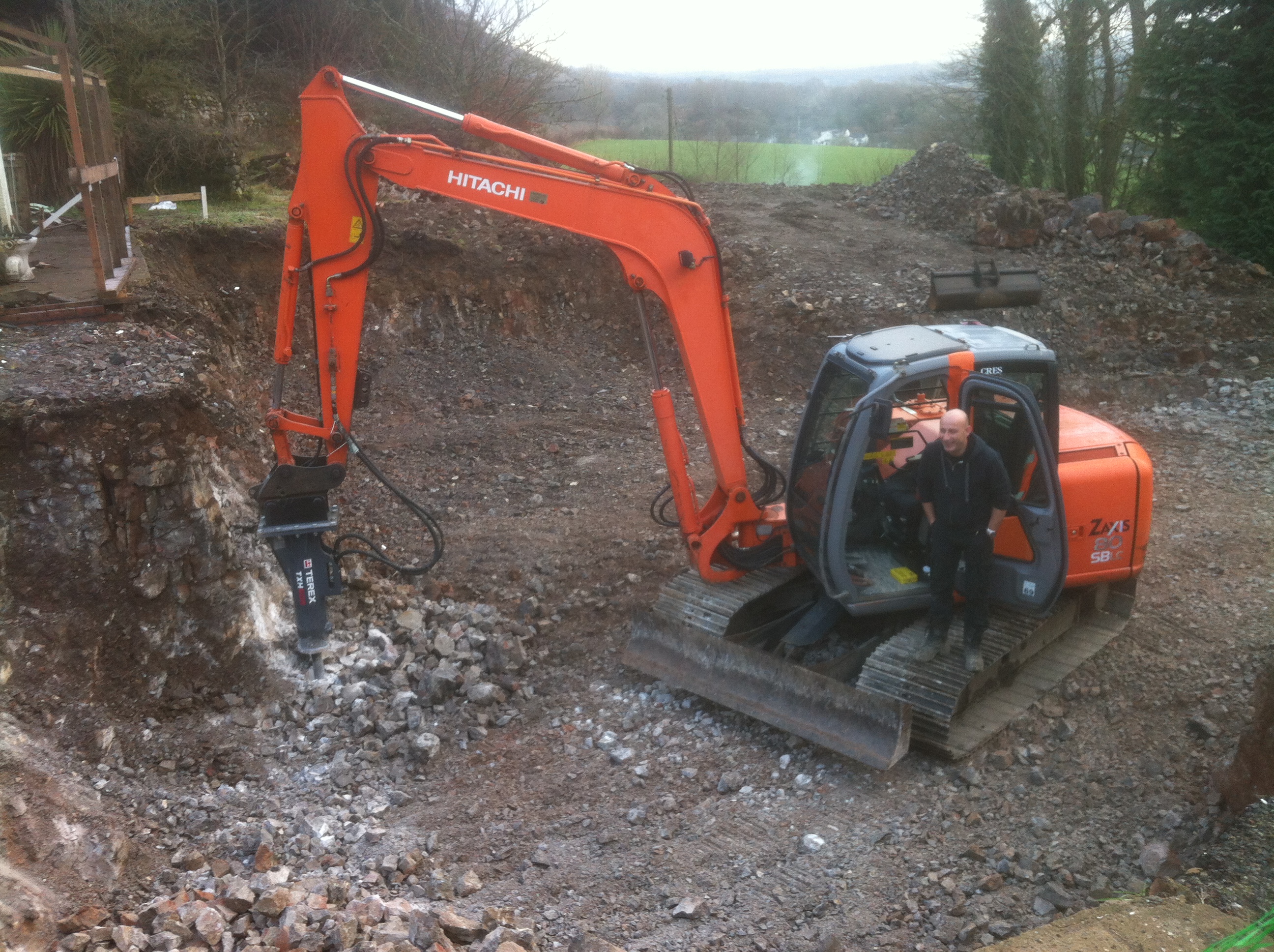

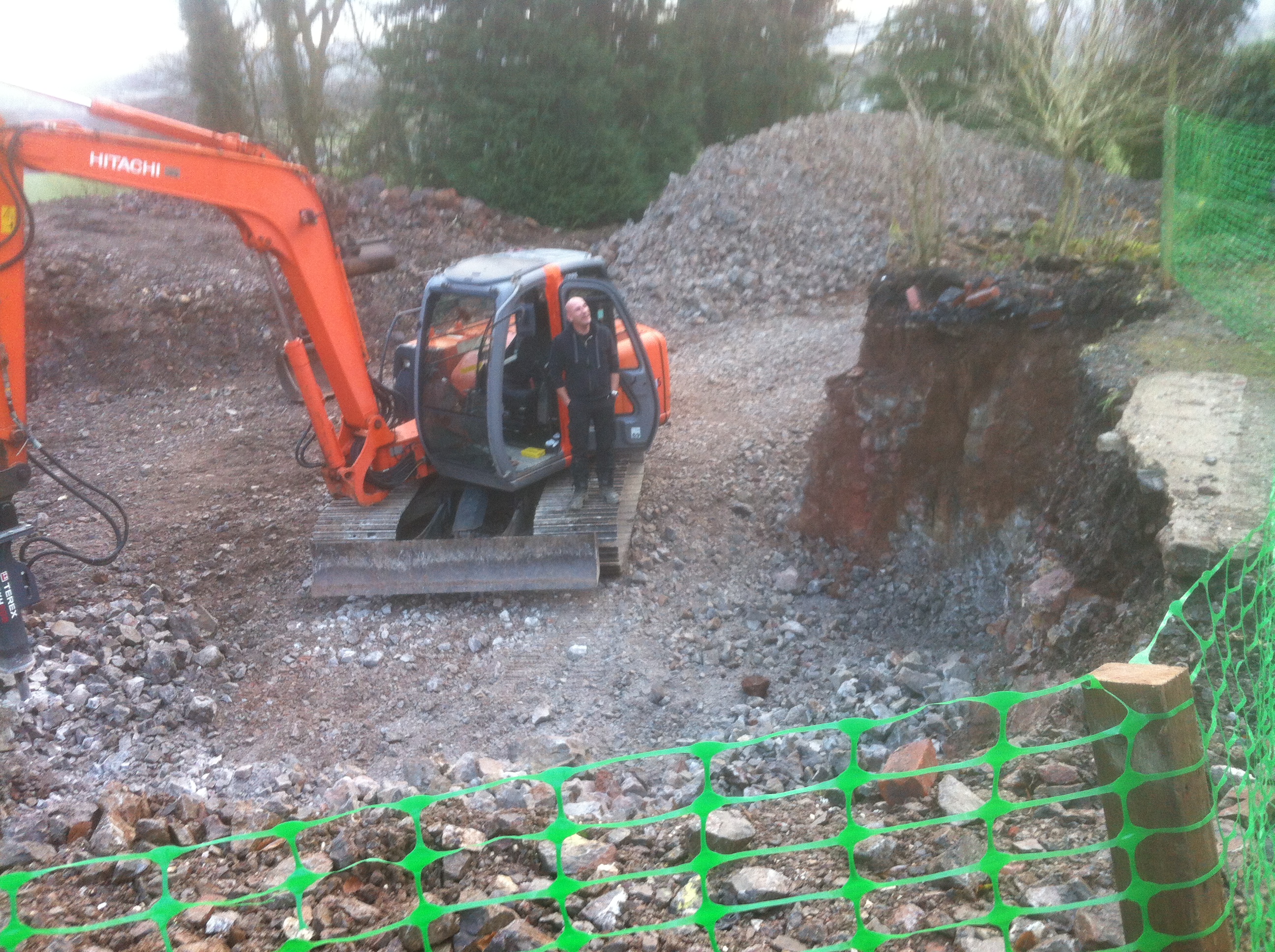

Triassic Posted January 28, 2018 Share Posted January 28, 2018 (edited) In the end I’ve decided to go with Amvic. They were a bit of a late entry into my selection process, the decision was mainly down to price, they were significantly cheaper than everyone else. For or those who like to see progress, here’s a photo of the hole for the walk in basement. Edited January 28, 2018 by Triassic 4 Link to comment Share on other sites More sharing options...
