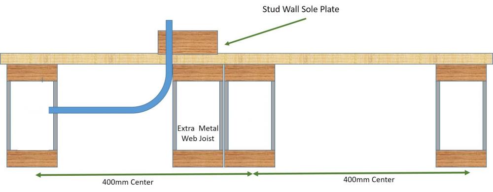

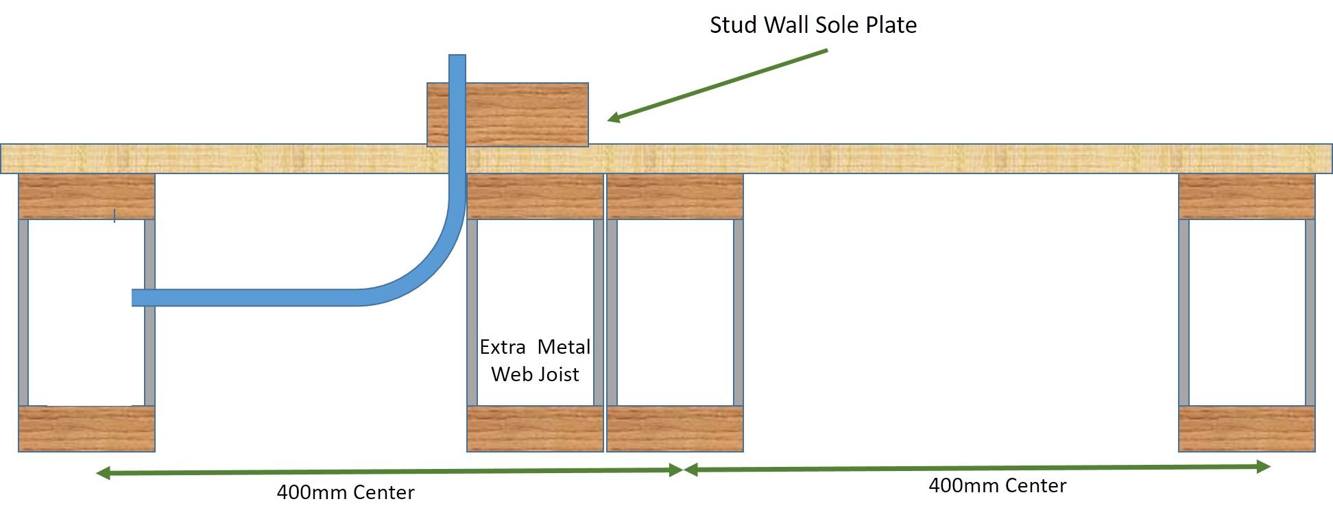

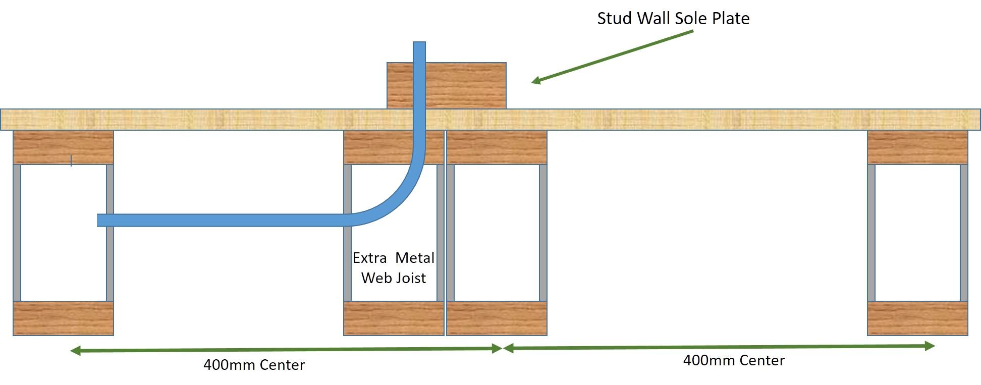

wozza Posted February 22, 2020 Posted February 22, 2020 (edited) Hi All, I have a narrow room that has metal web joists at 400mm centres - they span 2300mm - the floor is covered with Egger protect (glued with D4) - so the floor is very solid, the joist supplier calculated that 600mm centres would be fine but I wanted 400mm to ensure that it was solid. When constructing the floor, the builder doubled up with an extra joist to support the non load bearing stud wall above, this seemed a bit overkill to me at the time, but he said we always double up the joists when putting a stud wall above (he had never used Metal webs before and was very set in his ways) I need to get 15mm hot and cold water supplies into the stud wall from below for a shower. I am aware that you must not drill / cut etc any part of a metal web joist. My original idea was to place the stud wall sole plate over the edge of one of the joists so the majority of it is over the joist, then drill up through the floor and through the sole plate without touching the top chord of the metal web joist. My new idea is, that as I have an extra reduced centre metal web joist, could I drill through the top chord of the extra Metal web joist as shown below Your thoughts? Edited February 22, 2020 by wozza
ProDave Posted February 22, 2020 Posted February 22, 2020 I would drill the joist but then never admit to doing it. You are after all just drilling the "spare" one.
Russell griffiths Posted February 22, 2020 Posted February 22, 2020 Try and keep your two holes as far apart as you can so they don’t act together. I don’t think 15mm is going to hurt, try and do the hole in the centre not on the edge.
JFDIY Posted February 22, 2020 Posted February 22, 2020 It'll be fine, the wall and sole plate above it will also brace it.
