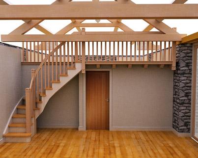

DevilDamo Posted June 19, 2020 Posted June 19, 2020 Having only just seen this and read through some of the posts, is the issue the headroom from about the 3rd/4th riser? If so, could you not push the staircase further back into the room so it clears the headroom which will take you to a landing and then turning left or right up to the first floor... if that makes sense?
DevilDamo Posted June 19, 2020 Posted June 19, 2020 Something similar to the attached? Obviously taking into account the headroom or clearance required under the stair soffit in order to access the rear area(s).
