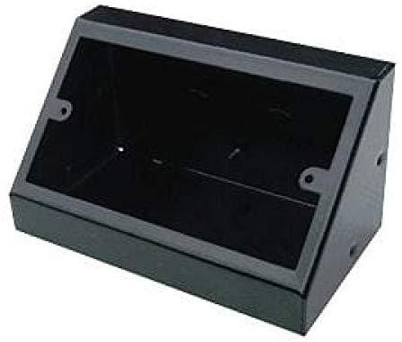

Onoff Posted February 28, 2020 Share Posted February 28, 2020 9 minutes ago, PeterW said: so they are exempt from Part M If they are above the work surface they can be any height. I would fit them at 1150 which puts them 250-300 above the top of a standard workbench. I quite like the lab/bench type boxes so you can mount sockets up under wall cupboards and facing downward. For example: https://www.amazon.co.uk/Double-Worktop-Station-Socket-Pedestal/dp/B07VXRKN78/ref=asc_df_B07VXRKN78/? Link to comment Share on other sites More sharing options...

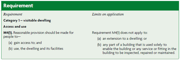

MJNewton Posted February 28, 2020 Share Posted February 28, 2020 (edited) 1 hour ago, zoothorn said: Anyway my electrician just popped by, & said yes effectively Onoff correct about new extention not needing to comply with 450mm.. but said a 'grey area' plus its just best to go 'safe' in case a grumpy BCO he said. There's nothing grey about it - Approved Document M clearly states, for the mandatory section where minimum/maximum heights for sockets are prescribed, it does not apply to extensions: I'd still go for the 450mm minimum though as, personally, I like it. Edited February 28, 2020 by MJNewton Link to comment Share on other sites More sharing options...
Dreadnaught Posted February 28, 2020 Share Posted February 28, 2020 Interesting. (b) any part of a building that is used solely to enable the building or any service or fitting in the building to be inspected, repaired or maintained" Would that excision apply to: A plant room? A utility room or laundry? Link to comment Share on other sites More sharing options...
MJNewton Posted February 28, 2020 Share Posted February 28, 2020 (edited) I think the implication of the exception is that a wheelchair user would not be expected to be involved in repair and maintenance, but I would expect laundry-related sockets/switches to be in-scope. Edited February 28, 2020 by MJNewton 1 Link to comment Share on other sites More sharing options...
