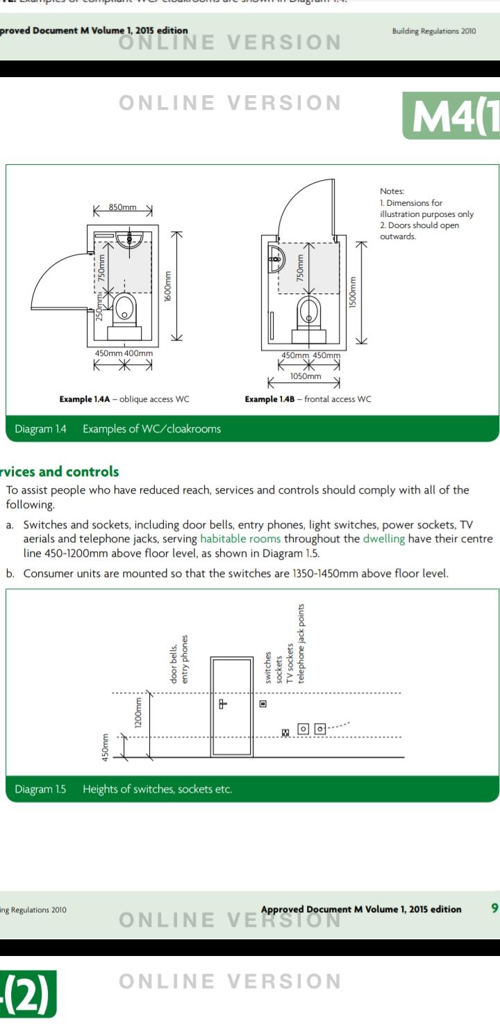

zoothorn Posted February 27, 2020 Author Share Posted February 27, 2020 Coming along well, I'm 2/3rds into job.. godawful dust/ I cannot believe this stuff's allowed, I feel bad just brushing off outside after Ive sawn it up inside.. I could never cut outside with all the plastic on the news (& I find on my walks, & stop to p/u along our stunning b-roads here). Anyway, can anyone confirm for me the minimum B.Regs height for sockets off the floor? I was told "450mm to bottom of socket", by my electrician, for my upper room. But the lower ground floor room.. is it the same figure? thanks- zoot Link to comment Share on other sites More sharing options...
MJNewton Posted February 27, 2020 Share Posted February 27, 2020 7 minutes ago, zoothorn said: Anyway, can anyone confirm for me the minimum B.Regs height for sockets off the floor? I was told "450mm to bottom of socket", by my electrician, for my upper room. But the lower ground floor room.. is it the same figure? Yes, although note that it is 450mm to 1200mm to the centre line of the socket. (Ref: Section 1.18 of Approved Document M) Link to comment Share on other sites More sharing options...
zoothorn Posted February 27, 2020 Author Share Posted February 27, 2020 22 minutes ago, MJNewton said: Yes, although note that it is 450mm to 1200mm to the centre line of the socket. (Ref: Section 1.18 of Approved Document M) Hi MJN. Sorry I'm not understanding "..to 1200mm to the centreline of the socket". All I can understand from your reply is one sole word "yes".. but the rest is incomprehensible. All I know, is my electrician has said the sockets need to be a certain minimum distance off the floor. I'm just tring to establish what this is to concur with his figure of 450mm. Surely there is just one answer (one figure) to the question-? Link to comment Share on other sites More sharing options...
Onoff Posted February 27, 2020 Share Posted February 27, 2020 1 hour ago, MJNewton said: Yes, although note that it is 450mm to 1200mm to the centre line of the socket. (Ref: Section 1.18 of Approved Document M) Except Part M 1.18 is contradictory! Says to the centre line but shows the lower sockets with the bottom edge at 450mm! Just put bottom edge of sockets no lower than 450mm, top edge of switches no higher than 1200mm. Link to comment Share on other sites More sharing options...
Dreadnaught Posted February 27, 2020 Share Posted February 27, 2020 How is "adequate provision" interpreted for sockets within that height range? As I read it, not all sockets have to be in that zone, just an adequate number. But what does that mean? Does that in practice mean all of them? Link to comment Share on other sites More sharing options...
Onoff Posted February 27, 2020 Share Posted February 27, 2020 Just now, Dreadnaught said: How is "adequate provision" interpreted for sockets within that height range? As I read it, not all sockets have to be in that zone, just an adequate number. But what does that mean? Does that in practice mean all of them? No, not all. Think a high level tv socket, fan isolator switch etc. Not a lot of point in saying you need a fan switch at low level for a person in a wheelchair to isolate the fan that they couldn't get to anyway. Link to comment Share on other sites More sharing options...
MJNewton Posted February 27, 2020 Share Posted February 27, 2020 (edited) 18 minutes ago, Onoff said: Except Part M 1.18 is contradictory! Says to the centre line but shows the lower sockets with the bottom edge at 450mm! You're reading too much into the diagram. It is showing the minimum and maximum heights, that's all. The fact the socket shown happens to have its bottom edge just above the minimum line is neither here nor there. It could equally have been half way up. Similarly with the lightswitch it is shown some inches below the maximum height but is not to be taken literally. Edited February 27, 2020 by MJNewton Link to comment Share on other sites More sharing options...
Dreadnaught Posted February 27, 2020 Share Posted February 27, 2020 5 minutes ago, Onoff said: No, not all. OK I see. I was also thinking of floor sockets (adjacent to a sofa located in the middle of the living room). I assume they are allowed. Link to comment Share on other sites More sharing options...
MJNewton Posted February 27, 2020 Share Posted February 27, 2020 (edited) 49 minutes ago, zoothorn said: Hi MJN. Sorry I'm not understanding "..to 1200mm to the centreline of the socket". All I can understand from your reply is one sole word "yes".. but the rest is incomprehensible. All I know, is my electrician has said the sockets need to be a certain minimum distance off the floor. I'm just tring to establish what this is to concur with his figure of 450mm. Surely there is just one answer (one figure) to the question-? The one word answer is 'yes'. I was just explaining that there is also a maximum height too, and the arguably minor detail that it is measured to the centre of the socket and not the bottom as your electrician said. Edited February 27, 2020 by MJNewton Link to comment Share on other sites More sharing options...
