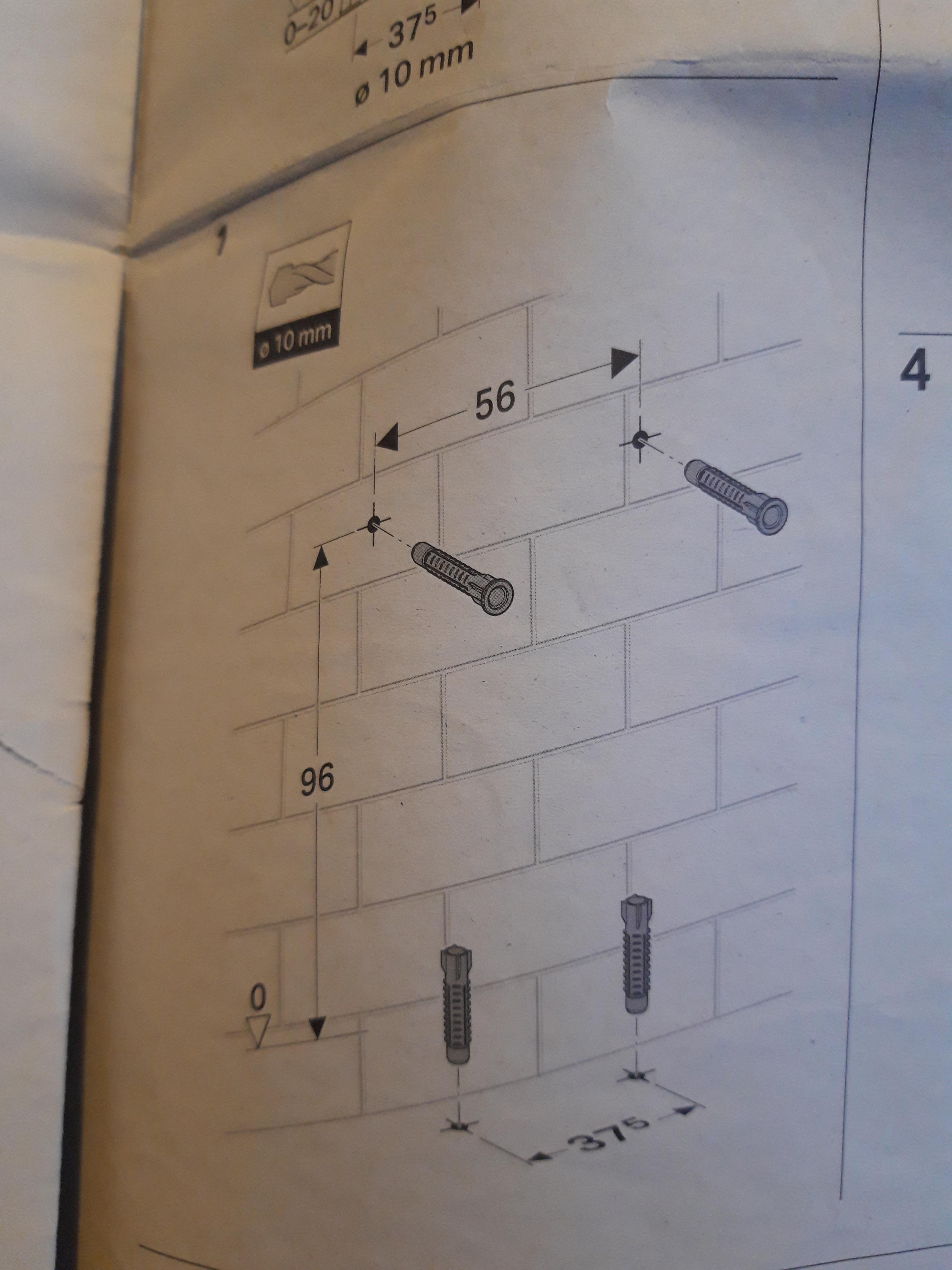

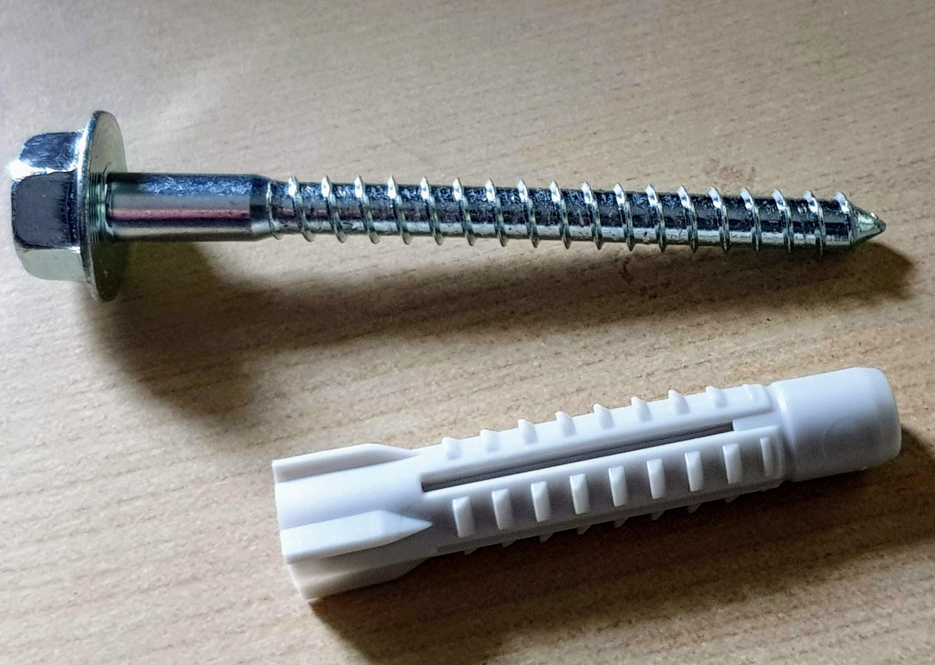

ToughButterCup Posted February 18, 2020 Posted February 18, 2020 Putting my Geberit Sigma base unit in today, and I'd like to get this - to adapt Gerry Rafferty's words - Right First Time. A tall order because usually, its two steps forward and one or more back. The feet are meant to be bolted to the ground (concrete) with a hex-head structural screw marked 8.8, and they provide a Rawlplug - well its a Rawlplug on speed really .... (invented by a German I think ? but the inventor call it a Duebel) Is there a simple table somewhere which for each screw size, gives hole diameter, the size of plug need and the depth to drill the hole? Since this is for a loo, should I use some resin in the holes? I'd be most grateful if anyone could post a link. Thanks.
Onoff Posted February 18, 2020 Posted February 18, 2020 Usually there's a number in a circle on the plastic and that's the drill size for the plug.
ProDave Posted February 18, 2020 Posted February 18, 2020 If in doubt drill smaller and try it. Plug won't go in, open up to next size.

Onoff Posted February 18, 2020 Posted February 18, 2020 Hang on...the drill size for that plug is on the Geberit instruction sheet! 2

ToughButterCup Posted February 19, 2020 Author Posted February 19, 2020 14 hours ago, PeterStarck said: This might be of some use next time. http://www.ultimatehandyman.co.uk/how-to/fasteners-fixings/wall-plugs Thanks Peter. The table given there is helpful: in the table 10mm drill size takes a blue plug, whereas Geberit uses a light grey. Of course it helps if members who post here read the instructions. ?

dpmiller Posted February 19, 2020 Posted February 19, 2020 38 minutes ago, AnonymousBosch said: Thanks Peter. The table given there is helpful: in the table 10mm drill size takes a blue plug, whereas Geberit uses a light grey. Of course it helps if members who post here read the instructions. ? Standard sized cheapo British plugs are coloured, efficient European ones tend to be plain grey. Cf Fischer, Lidl etc.
ToughButterCup Posted February 19, 2020 Author Posted February 19, 2020 Just now, dpmiller said: [...]efficient European ones tend to be plain grey. Cf Fischer, Lidl etc. I can see the difference in design - does it really make that much difference? I'll pop into Lidl and see if there are any for sale
dpmiller Posted February 19, 2020 Posted February 19, 2020 Tongue slightly in cheek there, Ian. But I do prefer the extra barbed doodahs of the more modern plugs.
Gone West Posted February 19, 2020 Posted February 19, 2020 54 minutes ago, AnonymousBosch said: The table given there is helpful: in the table 10mm drill size takes a blue plug, whereas Geberit uses a light grey. I think this is just a UK semi standard. I've bought boxes of plugs which follow that rule but some manufacturers make their own for specific uses.
