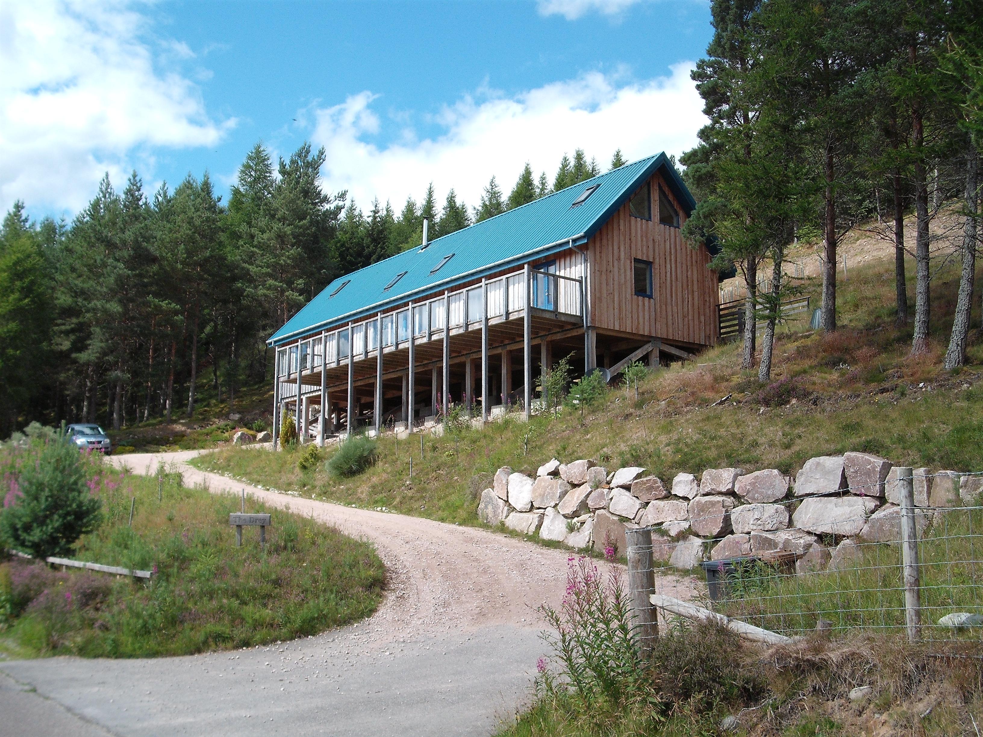

Ed Davies Posted February 10, 2020 Share Posted February 10, 2020 Like this? It's somewhere between Oban and the Perth area, I think, but it's been a while. Link to comment Share on other sites More sharing options...
davejura Posted February 10, 2020 Author Share Posted February 10, 2020 Aye, something like that, possibly more using steel. We are cladding the whole building with Cedral. Link to comment Share on other sites More sharing options...

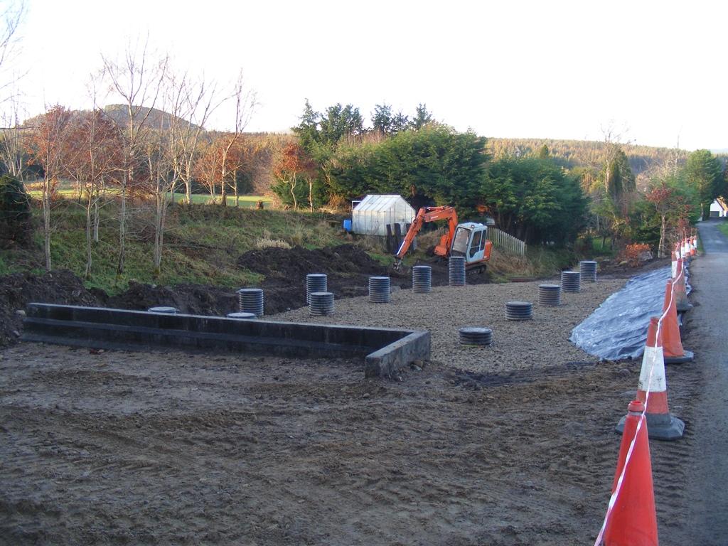

ProDave Posted February 10, 2020 Share Posted February 10, 2020 This is how a neighbour built his house on very poor ground with a steep slope. Each pillar sits on a 1 metre square concrete pad. Cast on top of that are concrete pillars cast inside some large plastic drainage pipe. Timber joists then span side to side and the timber floor spans length ways. The wall in the foreground is a retaining wall to hold back the ground for the parking area and to anchor that end of the building. In this case the tallest pillar is about 1.5 metres out of the ground. Link to comment Share on other sites More sharing options...

Crofter Posted February 10, 2020 Share Posted February 10, 2020 I built on pillars. I had a few factors that pushed me in this direction: - sloping site - driveway was already going to be very steep, so lowering the house even further by flattening the site was not an option - house is a monolithic box structure, compliant with portable building definition- so not need for continuous support around perimeter - desire to make the building aesthetically low-impact on the site - budget! The concrete that went into the pillars is a fraction of what a complete underbuild would have needed. The biggest downside of building in this way is that you will get significant wind scrubbing underneath the building. This makes draught-proofing and insulating the floor absolutely vital, and this is an area where certain trades might not appreciate the importance of airtightness. Alsol, think carefully about all the service penetrations that you'll need. 1 Link to comment Share on other sites More sharing options...
