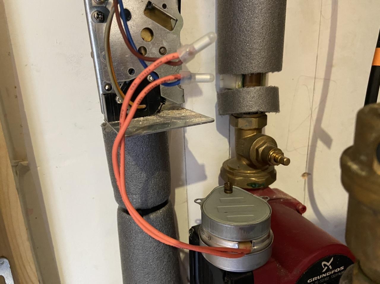

H F Posted February 5, 2020 Author Share Posted February 5, 2020 Regarding polarity, both cables coming from the motor are peach... does it matter which one goes to live and neutral respectively? Link to comment Share on other sites More sharing options...

Nickfromwales Posted February 5, 2020 Share Posted February 5, 2020 2 hours ago, Home Farm said: Regarding polarity, both cables coming from the motor are peach... does it matter which one goes to live and neutral respectively? AC electricity is not polarity conscious. You’ll get the same reading either way. Link to comment Share on other sites More sharing options...
H F Posted February 5, 2020 Author Share Posted February 5, 2020 The new motor is in and guest what? We have underfloor heating again. Yay. Thanks for the help and suggestions everyone. 3 Link to comment Share on other sites More sharing options...
