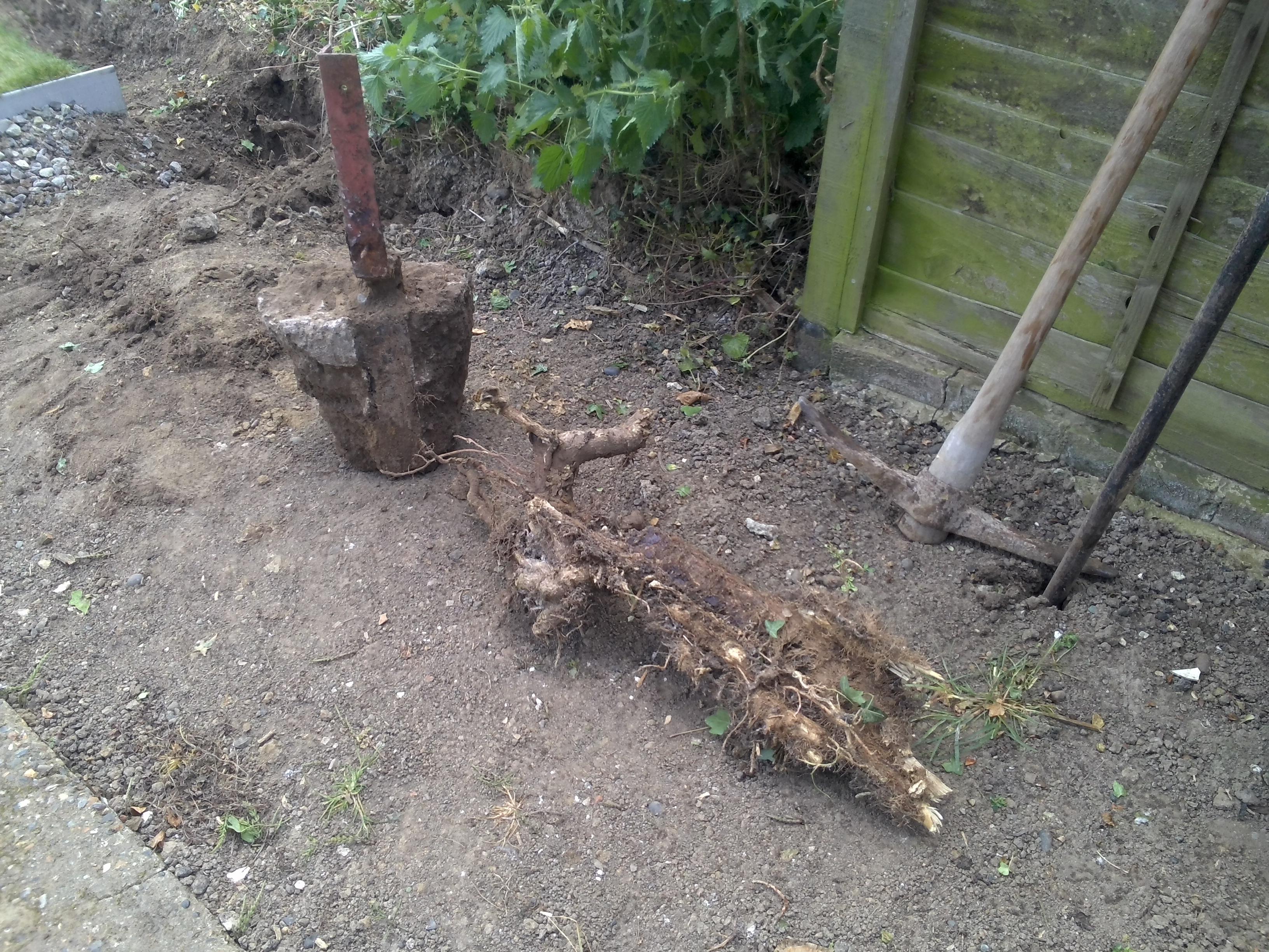

Gone West Posted January 25, 2020 Posted January 25, 2020 We had a similar problem when we replaced one of the fences. The installers had kindly put the posts in 600mm deep and put around 150mm of concrete at the bottom of the hole. When the posts broke at a later date they didn't replace them, instead they concreted a chunk of angle iron to the post and strapped the two together. As a result we had to dig out two lumps of concrete for every post. The only way we could do it was with a spade which was a real pain for 25m of fencing.

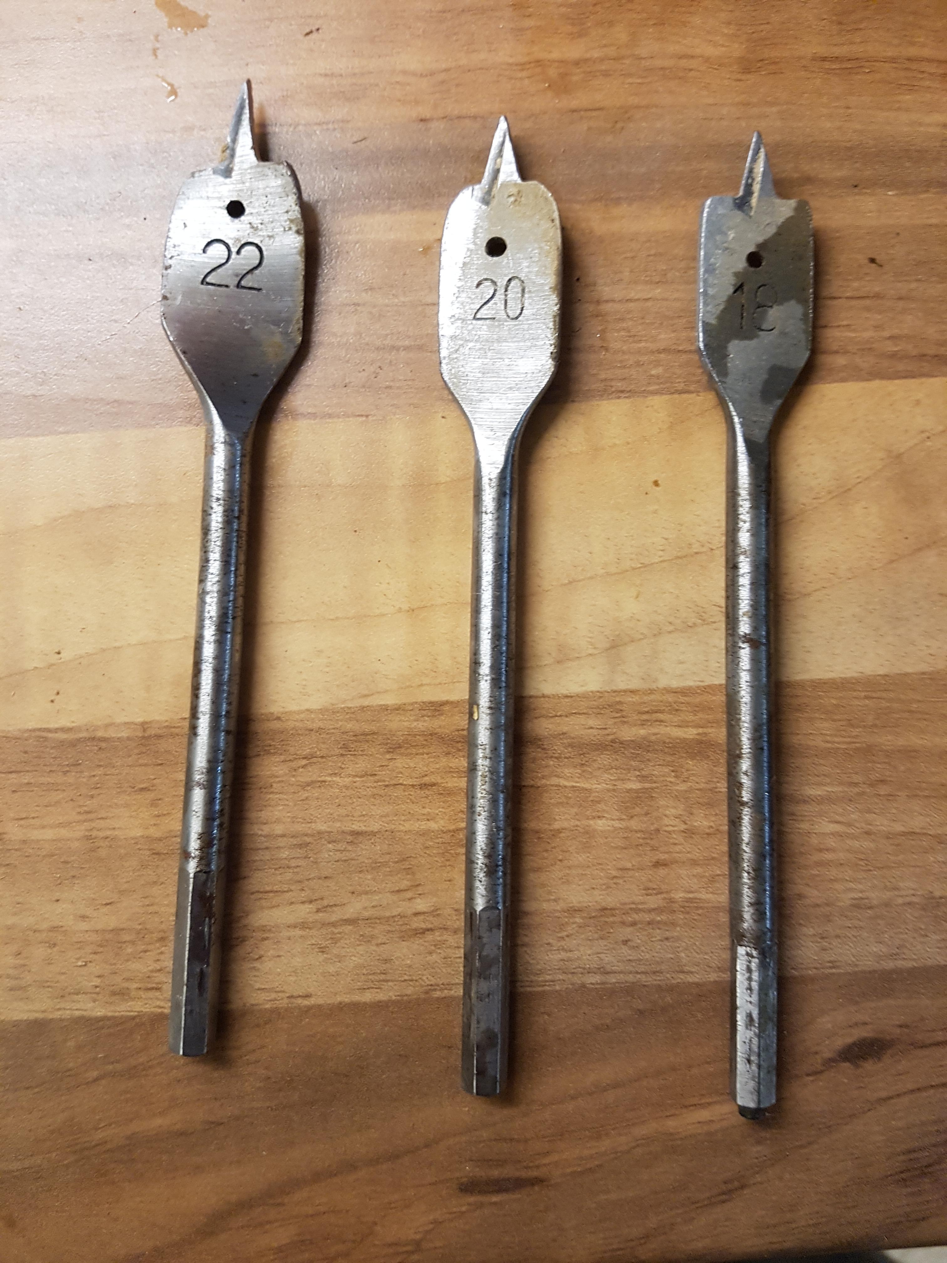

Moonshine Posted January 25, 2020 Author Posted January 25, 2020 (edited) Cheers for the advise, I ended up drilling the post out, down as far as I could go, approx. 1 foot. What a pig of a job, 3 hours to put up a single chuffing fence post! I have put an extra layer of post Crete on top of existing concrete. There was damage Edited January 25, 2020 by Moonshine
Randomiser Posted January 25, 2020 Posted January 25, 2020 10 minutes ago, Moonshine said: Cheers for the advise, I ended up drilling the post out, down as far as I could go, approx. 1 foot. What a pig of a job, 3 hours to put up a single chuffing fence post! I have put an extra layer of post Crete on top of existing concrete. There was damage Was it a concrete post you drilled out ?
