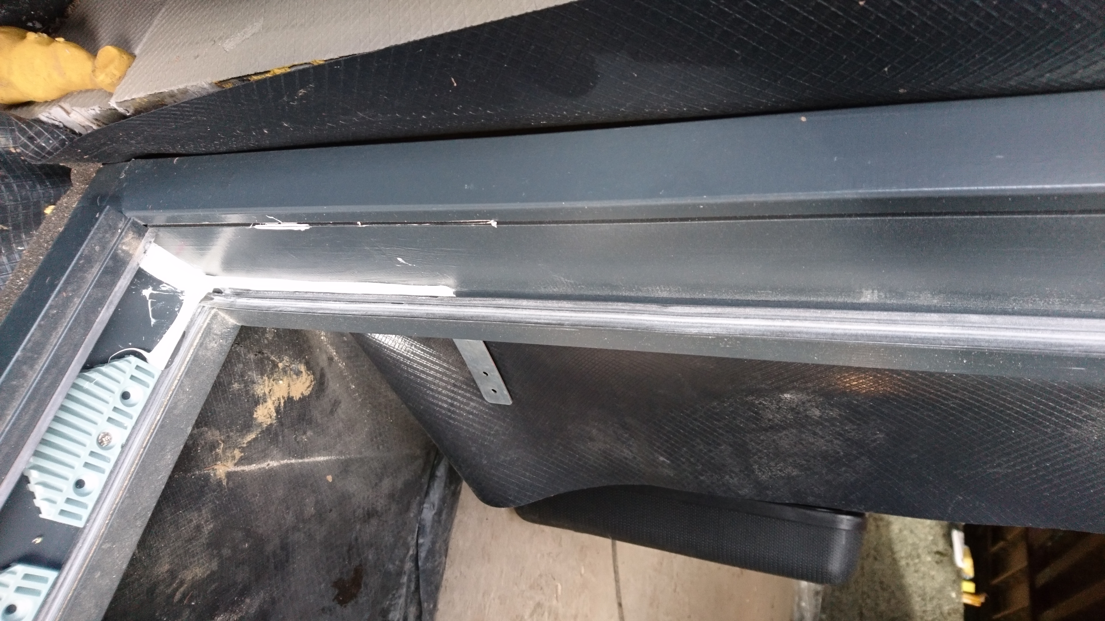

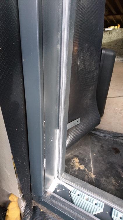

jamiehamy Posted November 6, 2016 Posted November 6, 2016 (edited) Hi all, Without going into too much detail - if it's possible to remove glass from a unit that is sold and labelled 'Secure by Design' with only a flat bladed tool and a suction cup - that's can't surely be SBD? In our long running saga, some glass was replaced yesterday - and on some of the units, this was all that was needed to get the glass out - from the outside. No extreme force required to pull the glass out once the beading was removed. Glazier was not familiar with the SBD standard per se, but said he would have expected my type of unit to have the glass secured by a special double sided tape which would make it extremely hard to pull the glass out. As it is - it's a rubber seal and silicon type seal at each corner to hold it in place then a bead presses into the side of the frame. . Can anyone offer any insight to this? Thanks, J (Added pic - the bead slots into the groove on the left, the glass presses against the grey seal - and is held in place with the white silicon type seal on each corner. ) Edited November 6, 2016 by jamiehamy

jamiehamy Posted November 7, 2016 Author Posted November 7, 2016 I first became curious when the glass fell out the kitchen window during transit - two beads had come loose and the glass partially came out. It was only when I watched the glazier remove the glass from a side panel I realised something was simply not right. I will see what the window company say, but also have contacted my BCO for his view - my architect told me ages ago he was quite a stickler for windows and he in theory is my ultimate decision maker as to whether the current install is acceptable. If he wouldn't approve, then really the windows are not fit for purpose. I'll update when I have more.

iSelfBuild Posted November 8, 2016 Posted November 8, 2016 I can't quite make out the photos. My aluminium clad windows are externally glazed, when I spoke to competitors about how they remove the glass they all said you smash it out... yet the way we do it allows achievable removal - but only when the opening sash is tilted/turned inside the room or ideally removed off the hinges. Still... on a fixed pane that has been installed it's pretty tough and on these we have an internal timber bead that can in practice be removed without damaging the window and the beads. But I would reckon if any of the glazing ever did fail I would have to send out new beads on these ones as they would need persuading out and it's easier to just tap out the beads and damage them and keep well clear of the surrounding frame because that can't be easily replaced. Interesting regarding the security sealant/tape though... I must start specifying this for future projects. It shows it pretty well on this video https://www.youtube.com/watch?v=KppeWfx-ZXA 4 minutes in.
jamiehamy Posted November 18, 2016 Author Posted November 18, 2016 Quick update - spoke to my Bro and he advised that it is my responsibility to ensure the windows meet the required spec - however he would expect externally glazed units to have tape and that I should insist on this. He also told me if I was struggling to get the window company to do this he could write me a letter. The window company have now said they will remove all the glass and install the tape. Not sure when - biggest glass panels needs replaced and as I suspected, all the cladding is the wrong colour and they can't get a match for the sills... What are people's thoughts on a company supplying units labelled 'Secure by Design' when the blatantly are not?
