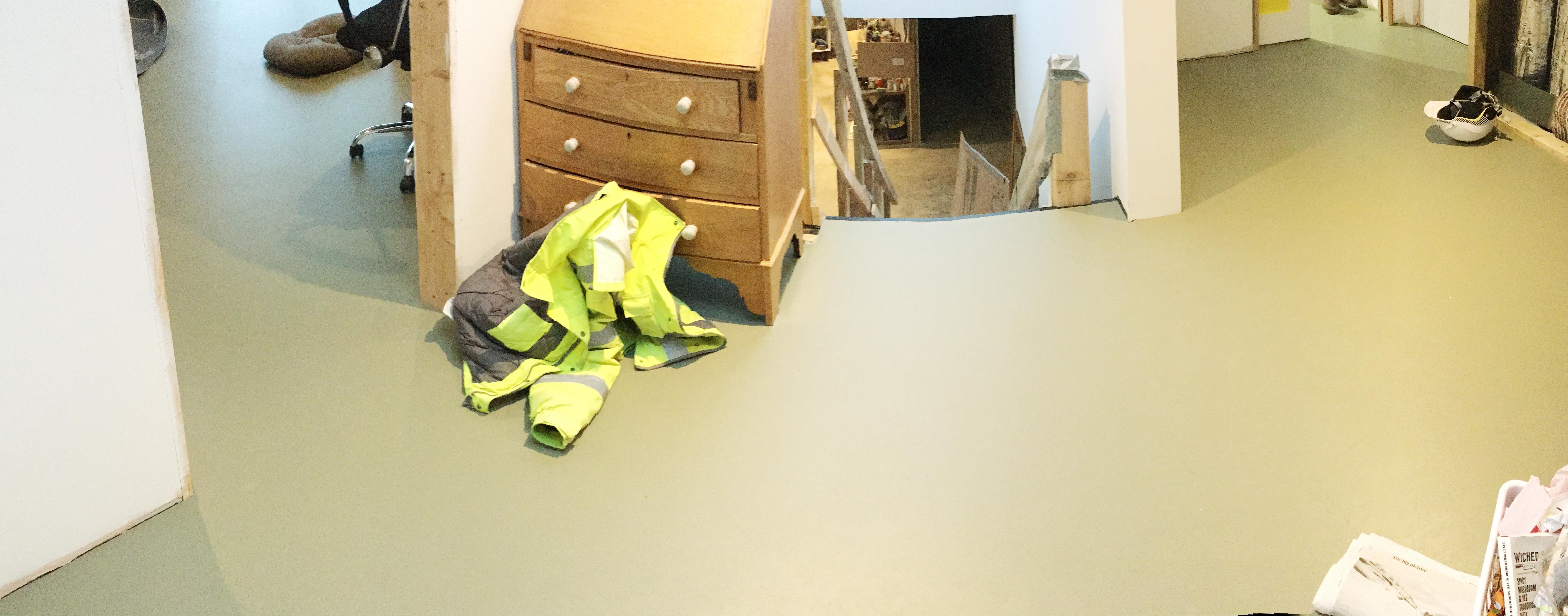

mvincentd Posted January 23, 2020 Share Posted January 23, 2020 Forbo Marmoleum...it's basically good old fashioned lino...linseed oil. 2m wide rolls, stick down, mine worked out at £66sqm fitted. Definitely NOT a diy job and very important to use a fitter experienced with it, joins MUST be scribed to achieve 'near invisible' seams (i know this to my cost). Link to comment Share on other sites More sharing options...

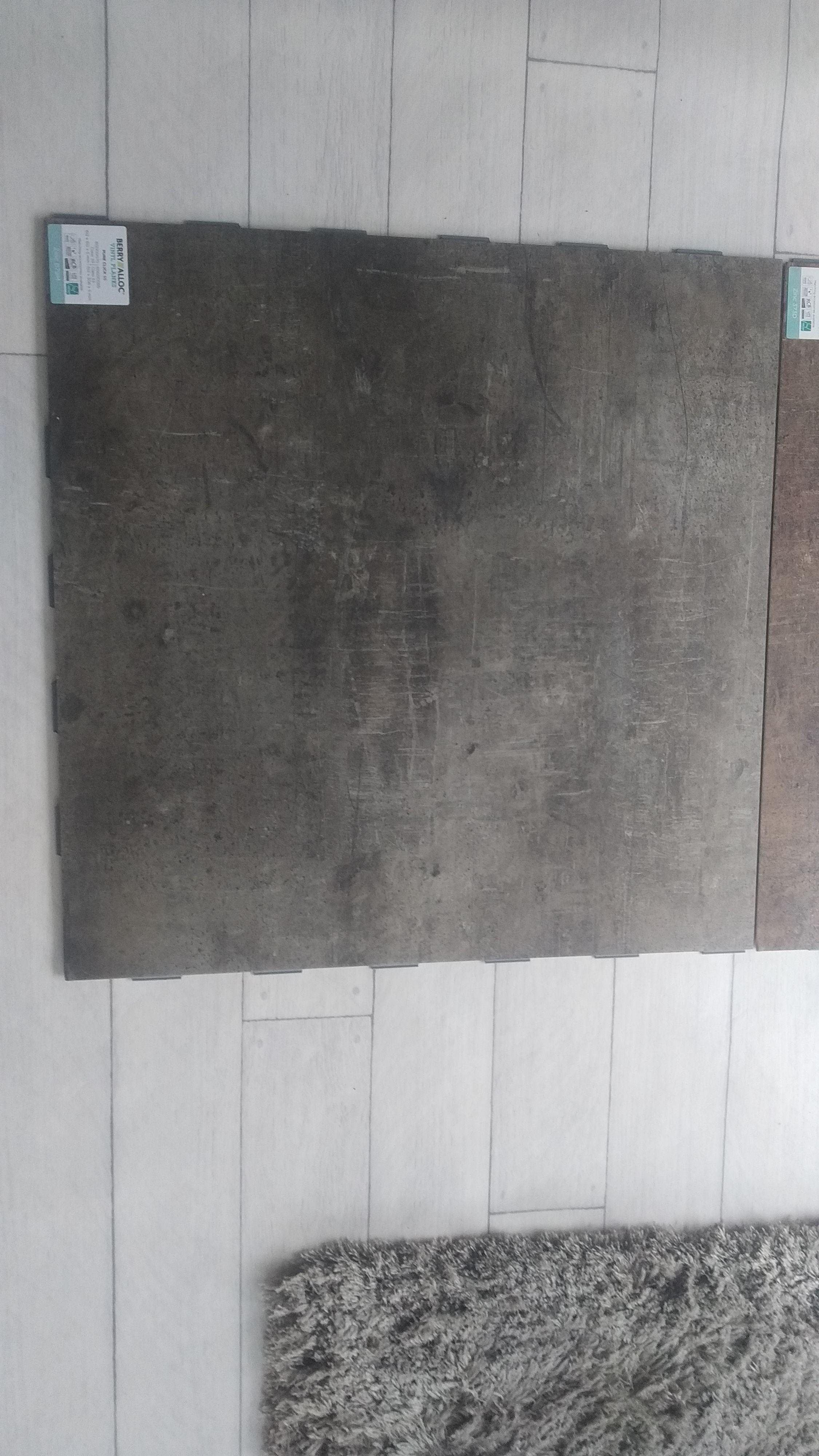

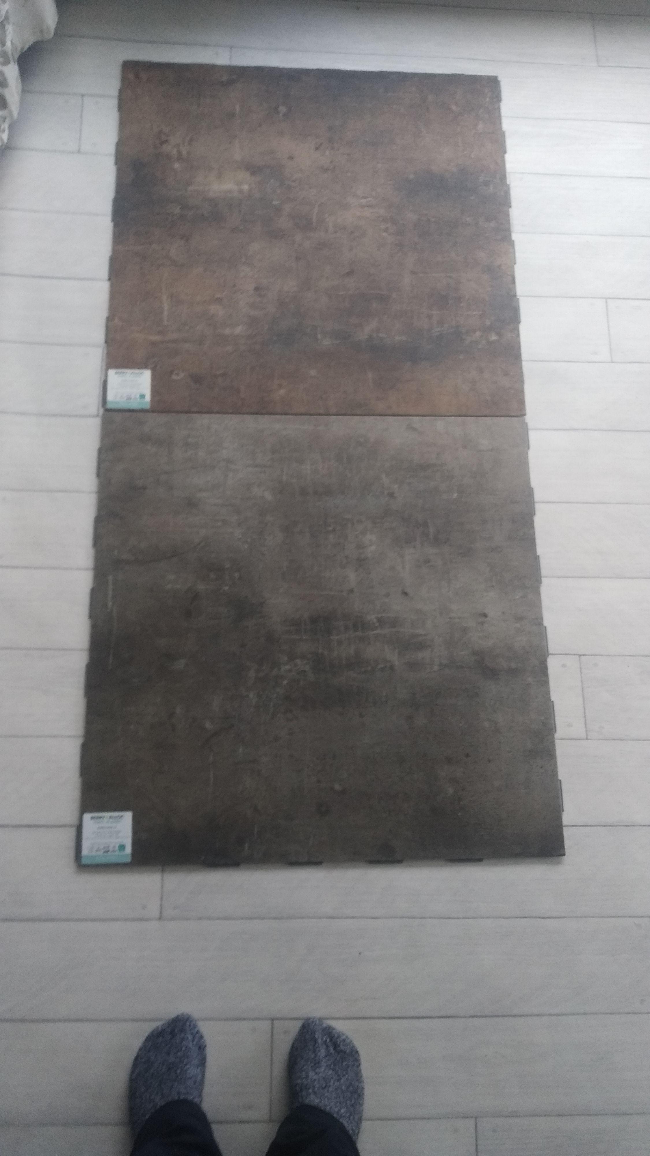

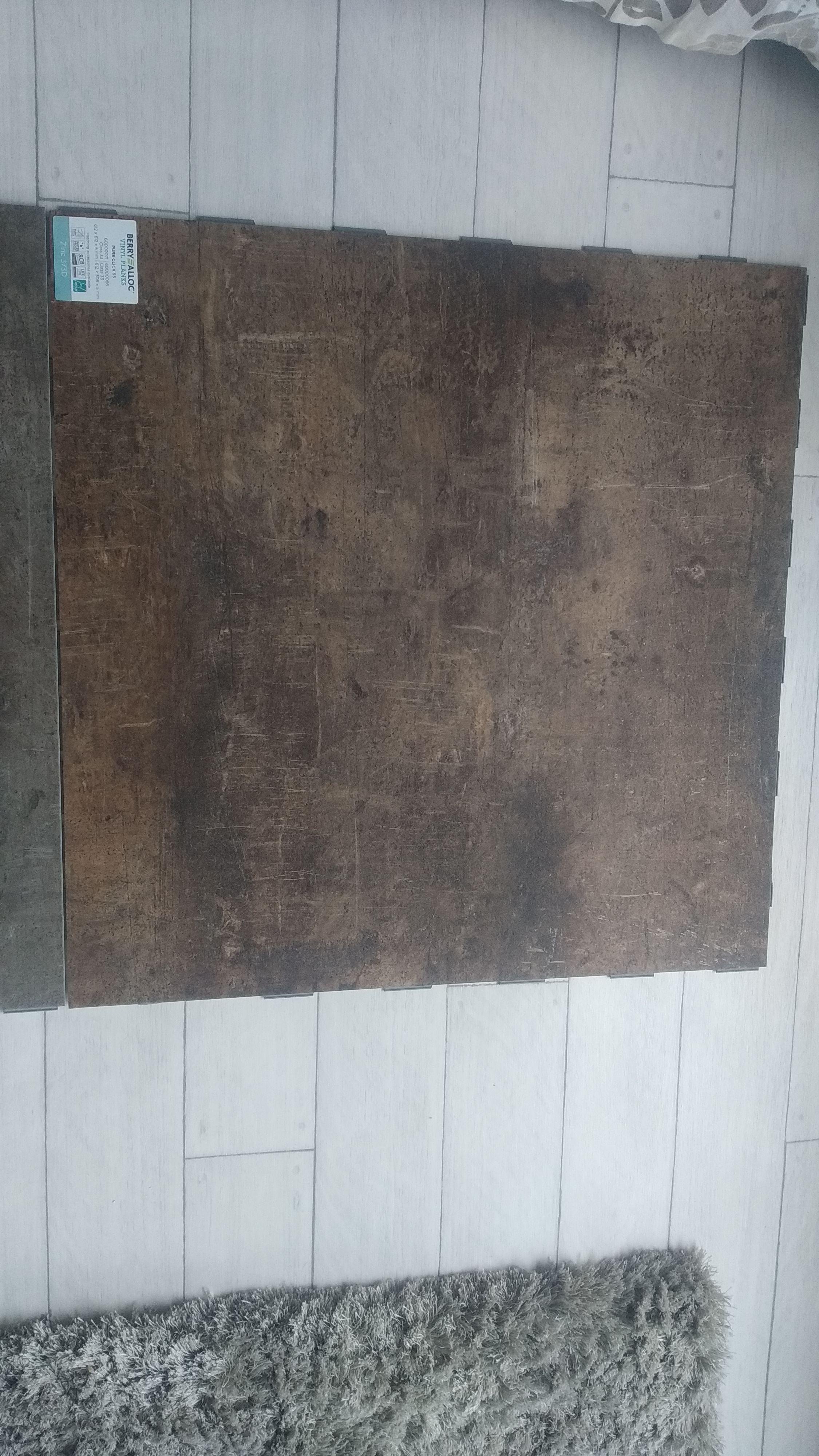

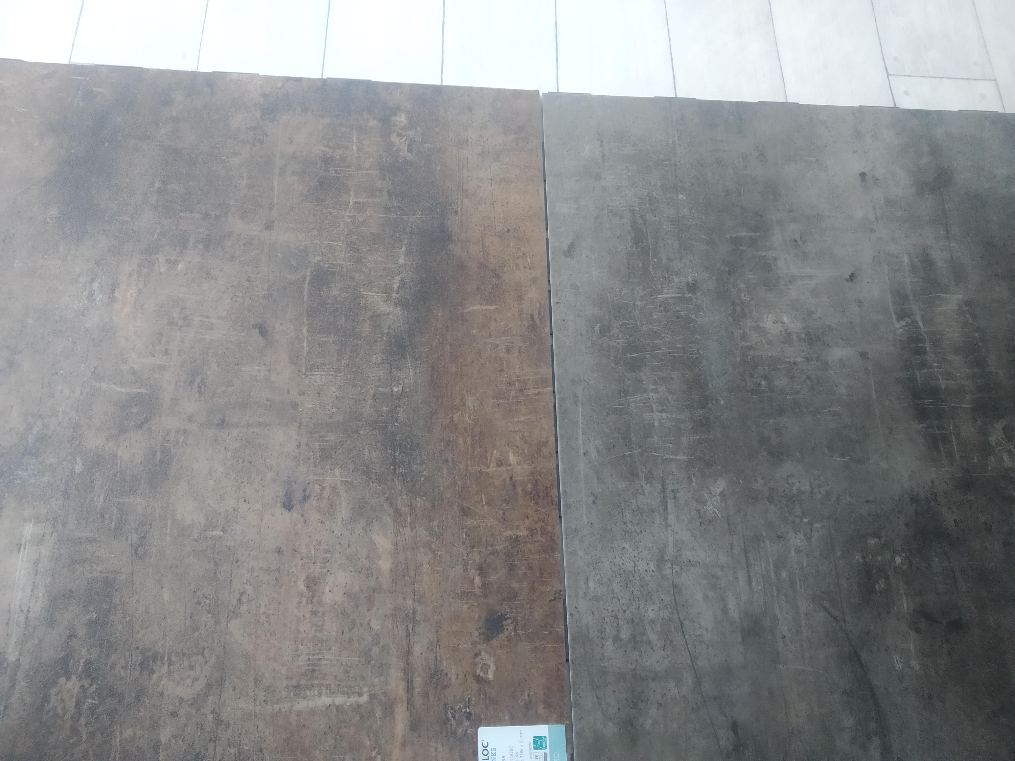

canalsiderenovation Posted January 23, 2020 Author Share Posted January 23, 2020 I have just had two samples. These are the click tiles as oppose to the glue down ones (which are a bit larger). I'm in love with them both. Link to comment Share on other sites More sharing options...
canalsiderenovation Posted January 23, 2020 Author Share Posted January 23, 2020 They are both a zinc effect. Link to comment Share on other sites More sharing options...
