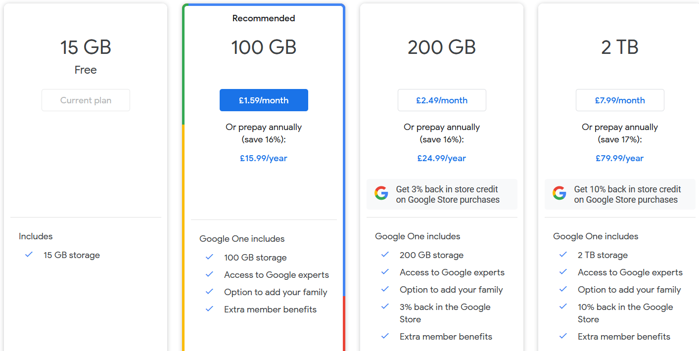

ragg987 Posted January 21, 2020 Share Posted January 21, 2020 If all you are sharing is static files would a cloud service not fit the bill? e.g. free google storage up to 15Gb or £16 per year for 100Gb. The advantage is that data is available from any device anywhere in the world, also backed up. Link to comment Share on other sites More sharing options...

AliG Posted January 21, 2020 Share Posted January 21, 2020 (edited) Office365 comes with 1TB of cloud storage for free if you have it. Can I try and persuade you on the Cloud. We have just moved to the Cloud at work, a couple of people used to say what you said, but it doesn't stand up to scrutiny. Why would stuff in your house be safer than stuff managed by a multi billion dollar corporation. People can get into your network and I think their networks may be safer. Microsoft, Google and Amazon are not going bust. They aren't selling the data you store in the Cloud, that would be corporate suicide. It is not social media. Finally the US Department of Defence uses an Amazon Cloud System now, if it is good enough for them it is good enough for me. I looked into a NAS a while back but they are surprisingly expensive and not simple to manage. If your local storage breaks and you have not invested in a more expensive RAID system them you will lose everything. This is not a problem in the cloud. Connection issues is a fair worry if your internet connection is problematic. I doubt this is an issue for most people. A lot depends on what you want to put on the storage. I used to think I would build a NAS storage system for video and music, but frankly the availability of cheap streaming services makes this a waste of time. Now you might want to store some pictures and files. I really do think the cloud is the best solution for this as you will be able to easily access it from multiple devices. You can also access it whilst not at home. One last thing, do you actually need it. A lazy way of sharing files is just to email them to yourself. I backed up my laptop hard drive onto One Drive by copying all the files there a while back just in case it broke. But files that I regularly need I just email to myself, then I can access them anywhere that I have email. Edited January 21, 2020 by AliG Link to comment Share on other sites More sharing options...
SteamyTea Posted January 21, 2020 Share Posted January 21, 2020 2 minutes ago, AliG said: Microsoft, Google and Amazon are not going bust. True, but they may discontinue the service at short notice. I use some cloud services, usually for transferring large files. I zip and encrypt the data. What would be nice is a method that allows me to create an encrypted folder that I have full access to, and can sent a link to others to view, or download, a file. It is the encryption that seems to be problematic as it would need two passwords, mine and the recipients. There must be a way of doing it as it is basically the same as PGP that my email uses. Link to comment Share on other sites More sharing options...
