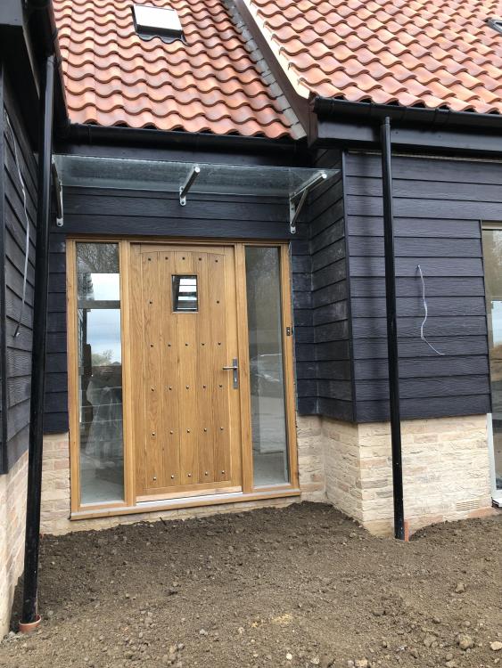

K78 Posted January 19, 2020 Share Posted January 19, 2020 On 18/01/2020 at 11:52, Temp said: I'd be concerned about water pouring through the gap between house and glass? I’d be more concerned about it looking like a bus stop or smoking shelter ? Link to comment Share on other sites More sharing options...

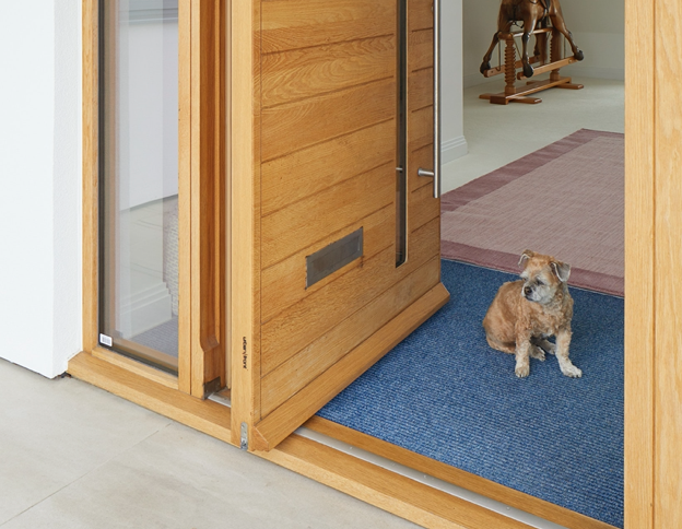

Dreadnaught Posted January 20, 2020 Share Posted January 20, 2020 (edited) @vivienz, regarding water creeping-in under your front door, does your front door have a bottom drip detail (a.k.a. a weatherboard, rain deflector, or rain deflector)? Could you post a photo of the bottom section of your front door? I recall that @mvincentd had an issue with such a detail. This door has one as an example: Edited January 20, 2020 by Dreadnaught Link to comment Share on other sites More sharing options...
vivienz Posted January 20, 2020 Author Share Posted January 20, 2020 1 hour ago, Dreadnaught said: @vivienz, regarding water creeping-in under your front door, does your front door have a bottom drip detail (a.k.a. a weatherboard, rain deflector, or rain deflector)? Could you post a photo of the bottom section of your front door? I recall that @mvincentd had an issue with such a detail. This door has one as an example: I will add a photo later, but the door has exactly the same thing as the one in the photo. Without the letter box and the pooch. 1 Link to comment Share on other sites More sharing options...
Ferdinand Posted January 20, 2020 Share Posted January 20, 2020 Local steel fabricator, or potentially aluminium veranda specialist. You imo want more than just a roof. Could the sides be in something interesting like glazed bricks, or a sheet material? F Link to comment Share on other sites More sharing options...

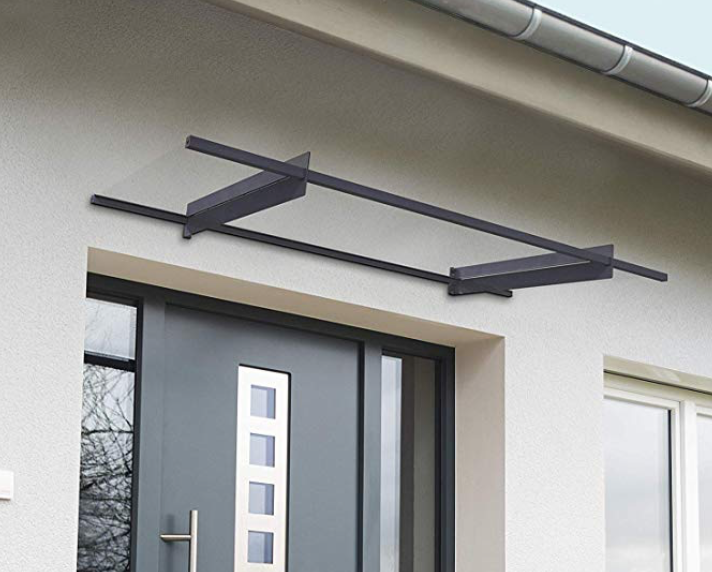

Dreadnaught Posted January 20, 2020 Share Posted January 20, 2020 @vivienz, spotted on Amazon … https://www.amazon.co.uk/Palram-NANCY-1500-GREY-CANOPY/dp/B07KZVV54F/ref=asc_df_B07KZSMJP2/ 1 Link to comment Share on other sites More sharing options...
vivienz Posted January 20, 2020 Author Share Posted January 20, 2020 You splendid fellow! That may well be arriving soon - thanks! Link to comment Share on other sites More sharing options...
Jeremy Harris Posted January 20, 2020 Share Posted January 20, 2020 42 minutes ago, vivienz said: You splendid fellow! That may well be arriving soon - thanks! Just a word of caution. It seems that the "glass" panel is only 4mm thick, so that means it won't be glass, but some type of plastic, as there's no way a 4mm thick glass panel would be OK in that configuration. It's a cleverly worded advert, as it seems to avoid using the word "glass", yet sort of implies it is. 2 Link to comment Share on other sites More sharing options...
joth Posted January 20, 2020 Share Posted January 20, 2020 2 minutes ago, Jeremy Harris said: Just a word of caution. It seems that the "glass" panel is only 4mm thick, so that means it won't be glass, but some type of plastic, as there's no way a 4mm thick glass panel would be OK in that configuration. It's a cleverly worded advert, as it seems to avoid using the word "glass", yet sort of implies it is. I found this: https://palramapplications.com/product/nancy-door-awning/ POLYCARBONATE PANEL – 4mm 1 Link to comment Share on other sites More sharing options...
vivienz Posted January 20, 2020 Author Share Posted January 20, 2020 3 minutes ago, Jeremy Harris said: Just a word of caution. It seems that the "glass" panel is only 4mm thick, so that means it won't be glass, but some type of plastic, as there's no way a 4mm thick glass panel would be OK in that configuration. It's a cleverly worded advert, as it seems to avoid using the word "glass", yet sort of implies it is. Ah, good spot, Jeremy. I shall consider further. I have the details of a place in Southampton that I will ring tomorrow. They do all things balustrade and of that nature. Link to comment Share on other sites More sharing options...

mvincentd Posted January 20, 2020 Share Posted January 20, 2020 15 hours ago, Dreadnaught said: I recall that @mvincentd had an issue with such a detail. Yes, and on 1st complaint the door people proposed adding a drip bar to the bottom of the door, much like that pictured example. I argued this circumvented rather than solved the inadequate seal between door and threshold (as well as introducing an aesthetic I didn't want). Eventually they fitted a different threshold which works fine...the essential difference being it's solid unlike the original one which dished, bowed and otherwise deformed. @vivienz if you want a canopy fine, but it does sound like your door/threshold is underperforming. Link to comment Share on other sites More sharing options...
vivienz Posted January 21, 2020 Author Share Posted January 21, 2020 (edited) Thanks, chaps. All in hand - Norrsken are here as I type, they have replaced the seal and are tweaking the door. It seems that the seal put on the door during manufacture was less than ideal but it should be fine now. As has been said so many times, it's not so much that problems happen but how they are dealt with and Norrsken's customer service has been excellent. But I still want a canopy. Edited January 21, 2020 by vivienz Link to comment Share on other sites More sharing options...
