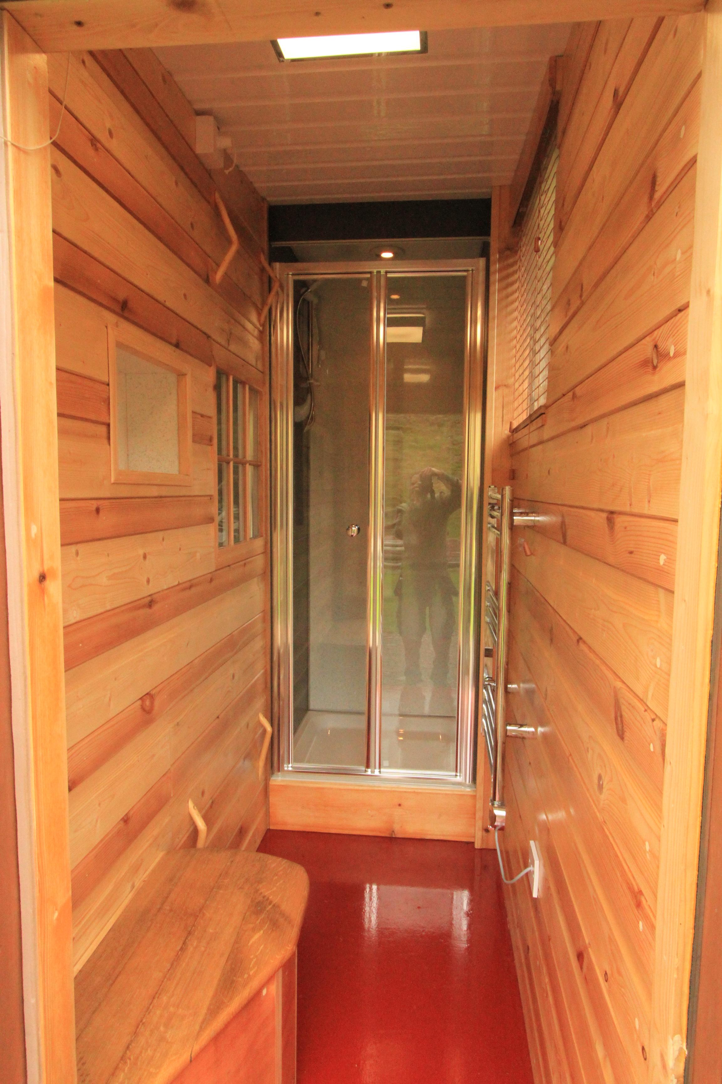

I installed a small 800 or 900mm shower in my cabin, 2 bar water pressure, 10.5 kw electric shower. Guests really like it and even leave positive comments in the  reviews! The step down should have been designed out but it was my first shower build and nobody has complained. I have another 2 showers to build in the next few years and will make then a bit bigger but staying well away from the wet room design, personal preference.
Link to comment
