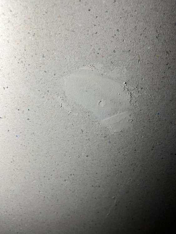

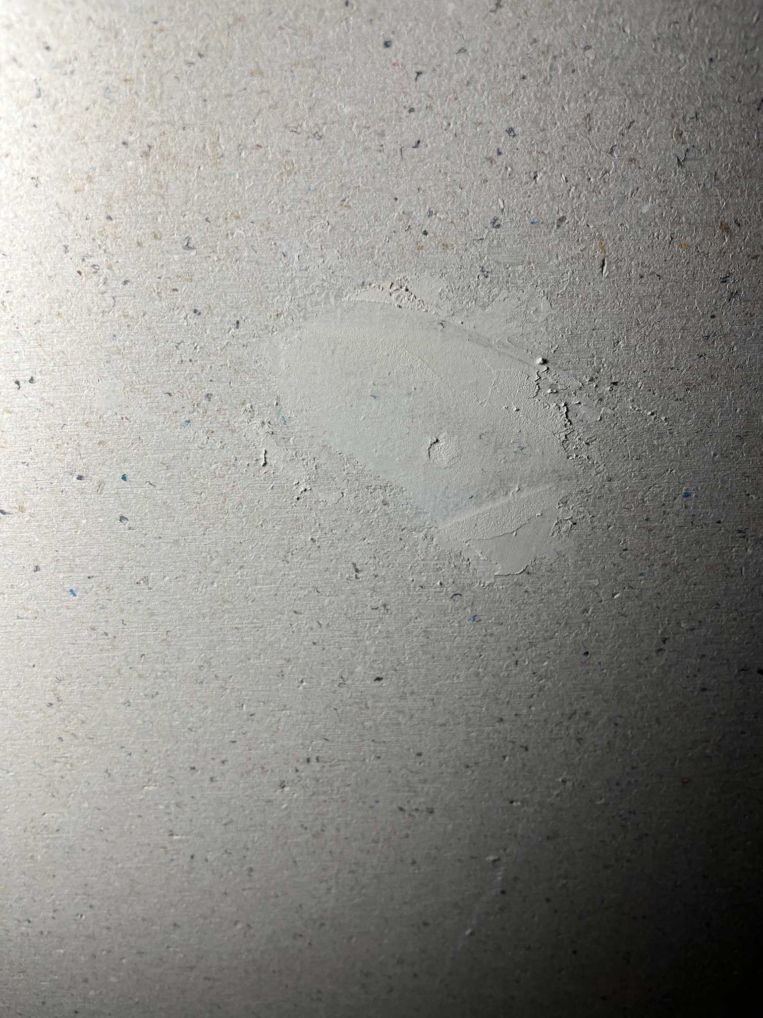

Is there a knack to filling the screw holes? I either seems to have to use quite a thick layer of compound to dome over the hole (which will need more sanding) or else if I scrape the trowel hard to smooth off the excess it tends to leave the filled hole a little concave which isn't ideal.
Any tips on this welcome.

It's a two-stage process - even says so in the Fermacell guides on filling. It's nigh on impossible to do it in one go without excess sanding afterwards. But once done, as you say, it's bulletproof. My entire garden room (including the ceilings!!) is full board 12.5mm, and it's as solid as anything. When the boards are glued together, there's also zero movement, and there are no cracks visible anywhere after at least eight years.

 That's interesting - I don't recall reading this guidance. Where did you find that?
So just to be clear, is this 2 stages with the joint filler? Before the Fine Surface Treatment skim?

The 2 stages are the edges and the screw holes with joint filler, then the FST skim. It's difficult to tell from your photo, but is the problem related to slumping on the initial fill? If so, the FST should cover this; however, you may want to check your mixing on the edge filler.
