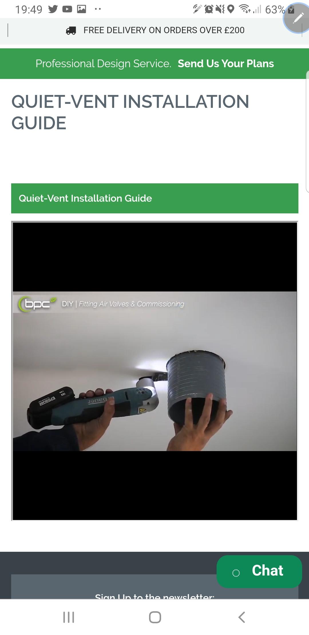

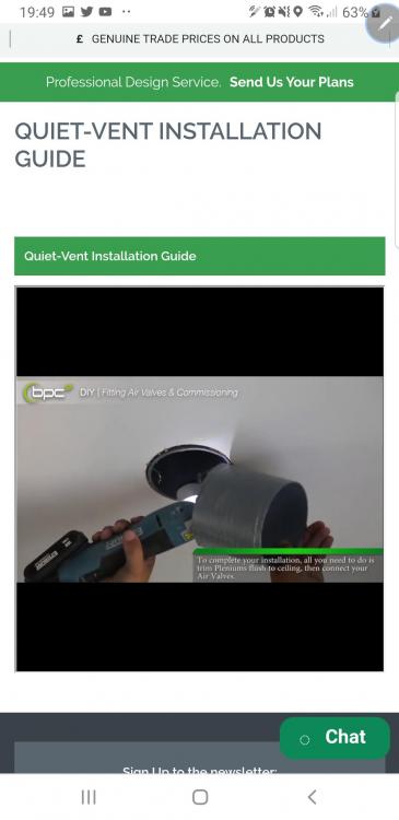

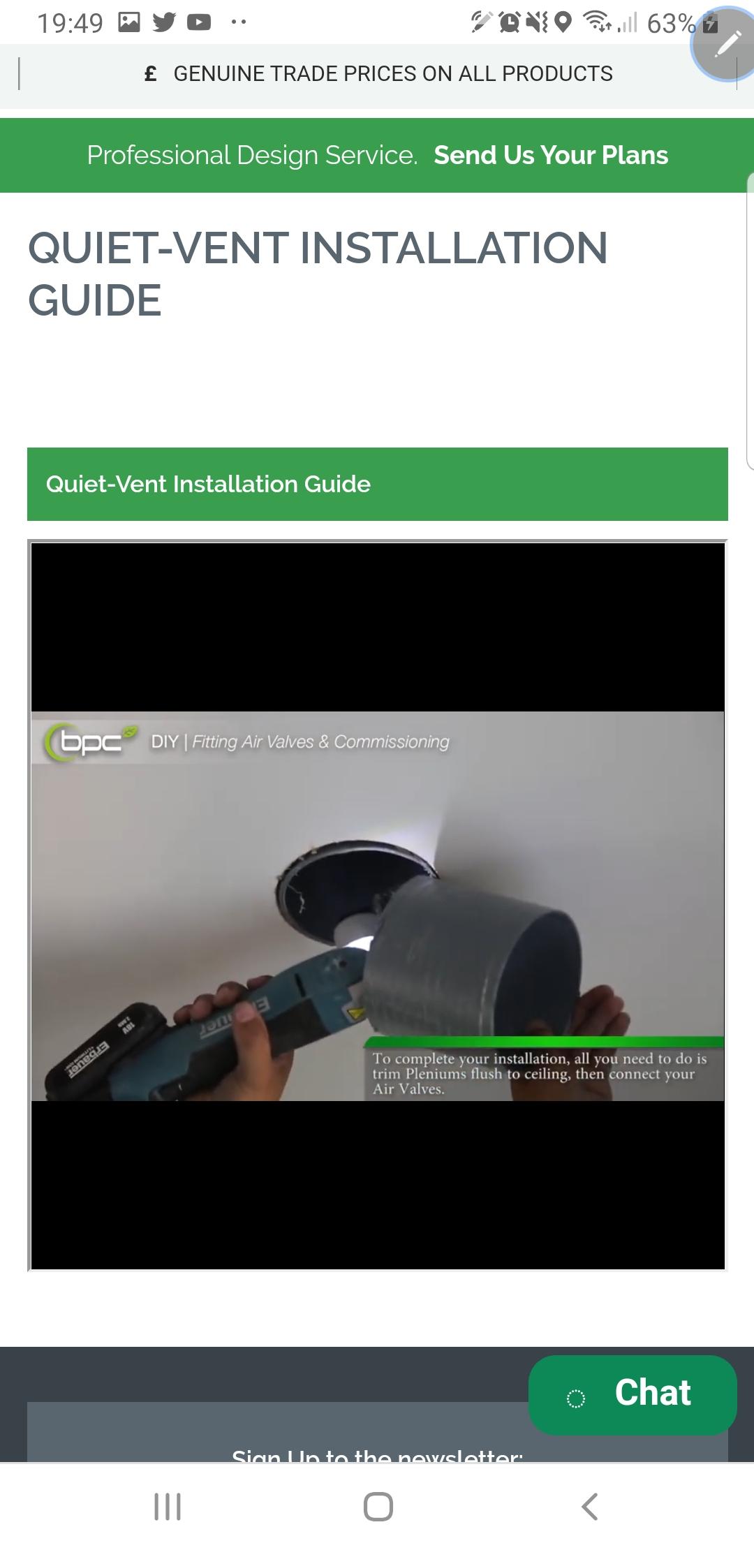

Oz07 Posted December 15, 2019 Posted December 15, 2019 Good video. Missing a bit of detail. Has he worked those plenum heights out to finish bang on ceiling height or cut them pre boarding? Would be a bit of a pig to cut afterwards. How come he's halfway between first and second fix. Ceilings taped and jointed but studs exposed elsewhere. I presume it's also important to cover plenums while plastering and decorating?
Danny68 Posted December 15, 2019 Posted December 15, 2019 (edited) 1 hour ago, Oz07 said: Good video. Missing a bit of detail. Has he worked those plenum heights out to finish bang on ceiling height or cut them pre boarding? Would be a bit of a pig to cut afterwards. How come he's halfway between first and second fix. Ceilings taped and jointed but studs exposed elsewhere. I presume it's also important to cover plenums while plastering and decorating? Watched the video this morning then watched half a dozen others on YouTube, different video but see them cutting the plenum with a multi tool , made it look easy. Edited December 15, 2019 by Danny68 1
Bitpipe Posted December 15, 2019 Posted December 15, 2019 I left my plenums proud of the ceiling for boarding and skimming. Should have trimmed them after boarding as the plasterer found them tricky to navigate round, especially when close to the edge of walls in a few rooms. Doesn't really matter as the cowls have a large lip so hide any roughness at the edges.
