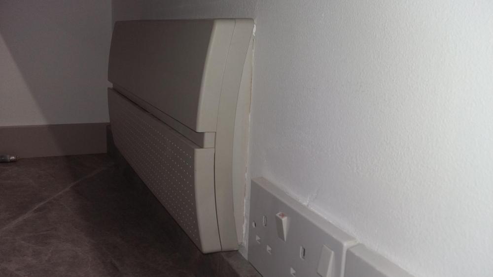

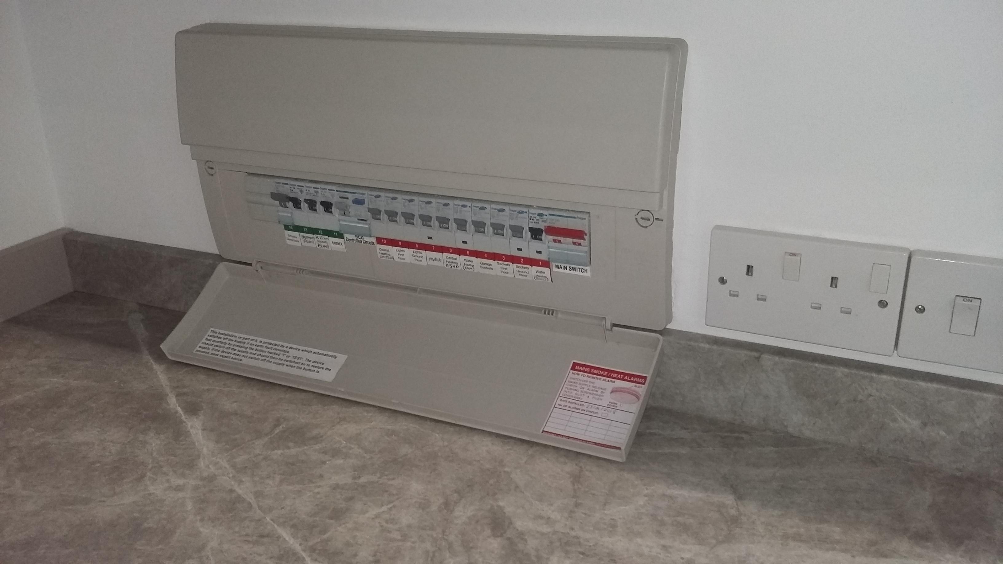

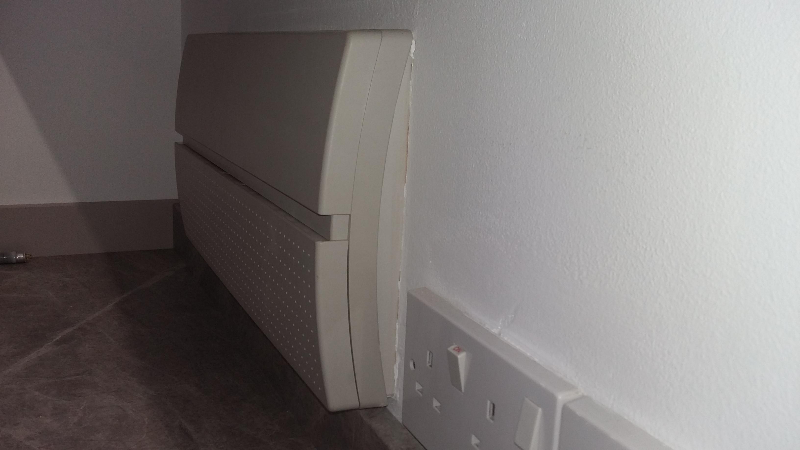

ProDave Posted December 9, 2019 Posted December 9, 2019 4 hours ago, AnonymousBosch said: That sounds really smart Dave ~ Photo please! I don't have any pictures of it before it got boxed in unfortunately. But it was the standard metal case CU (in this case with a plastic front) screwed to the OSB that covers the frame. The wall was then battened with 45mm battens to make the service void, and then 12mm plasterboard and skim. That was just about the right depth for the front to go on and makke it look like it was designed all along to be flush mount. All the cables exit the top or bottom cable entries and run up or down the wall behind the plasterboard in the service void. Except for the incomer which is SWA and that enters from the side and is glanded into the metal CU again hidden behind the plasterboard now. I did have to be accurate cutting the plasterboard as not being a proper flush mounting CU there was no flange to cover any imperfections in cutting the hole. I bought all the rcbo's from ebay and I didn't pay more that £10 each but you can't always do that if you are in a hurry. I bought them over a period of time when they came up. The CU was fitted as soon as the house had a roof so I have plenty of time to populate it. 1

Temp Posted December 10, 2019 Posted December 10, 2019 Not sure a CU that low down is allowed now? Part M? 1
Mr Punter Posted December 10, 2019 Posted December 10, 2019 30 minutes ago, Temp said: Not sure a CU that low down is allowed now? Part M? I think it may be at worktop height.
ToughButterCup Posted December 10, 2019 Author Posted December 10, 2019 I would like ours to be installed at about 900 mm. Hope thats Ok?
Onoff Posted December 10, 2019 Posted December 10, 2019 1 hour ago, AnonymousBosch said: I would like ours to be installed at about 900 mm. Hope thats Ok? No. Part M says 1350-1450mm to the centre line of the switches (even for wheelchair users). p22 & p49: BR_PDF_AD_M1_2015_with_2016_amendments_V3 (1).pdf
ProDave Posted December 10, 2019 Posted December 10, 2019 15 minutes ago, Onoff said: No. Part M says 1350-1450mm to the centre line of the switches (even for wheelchair users). p22 & p49: BR_PDF_AD_M1_2015_with_2016_amendments_V3 (1).pdf 1.66 MB · 1 download That's odd. I will have to see what the Scottish regs say. It would be strange to have it that high. What is the logic in saying a light switch can be no more than 1200mm high, then insisting the consumer unit has to be higher? I installed mine above the utility room worktop, but below the utility room wall cupboards. If I had to put it a minimum of 1350mm to the centreline of the mcb's, then I would have had to cut a dirty great big notch out of the bottom of the wall unit for the consumer unit to intrude into.
Onoff Posted December 10, 2019 Posted December 10, 2019 13 minutes ago, ProDave said: That's odd. I will have to see what the Scottish regs say. It would be strange to have it that high. What is the logic in saying a light switch can be no more than 1200mm high, then insisting the consumer unit has to be higher? I installed mine above the utility room worktop, but below the utility room wall cupboards. If I had to put it a minimum of 1350mm to the centreline of the mcb's, then I would have had to cut a dirty great big notch out of the bottom of the wall unit for the consumer unit to intrude into. I agree but I don't write the regs. I half recall it comes from BEMA to place the cu out of reach of children and avoid them messing with it. Pity the poor wheelchair user who wants to reset an rcd etc. Especially when other controls are recommended lower (see page 49) than 1200mm.
