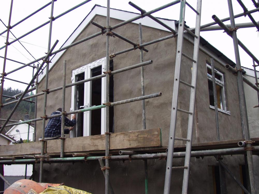

zoothorn Posted December 22, 2019 Author Posted December 22, 2019 Ok I have a number of things to tie up before the wretched builder is gone (let alone what's on the final bill, 1/3rd overall cost). 1) the galvanised lintels (3 of) I mentioned to him I was unhappy about seeing one bowing when built (not supported in middle/ alot of block weight above one in particular bowing the most), have been left as is after rendering around. They're lintels visible/ not covered over by render. It was mentioned on here not to worry as will be rendered over anyway, so reassured by this I didn't press builder harder.. & waited. When I quizzed builder as they were made & noticeably bowing he said "oh fine" (walking off in a huff), & later "will be covered/ rendered over anyway so don't see it" when I asked again about them being seen (hoodwinking me, yet again). When renderer said "all done" & I quizzed lintels, he said "was not aked to do".. & off he went. He also said "its not that they can't be done, just I was not asked to do" (implying its bit of a tricky job). So its not a Q of getting builder to come back & finish off (which he won't, refusing it was ever mentioned they'd be covered/ lying).. its a Q of what should I expect, as a client (not having the finer details of a "render job" broken down into specific minutiae, doors, windows, reveals, the constitution of the mix, the depth of finish.. because I'm a client & as such I expect certain things like roof batons, nails fixing my tiles down to them for eg without it being specifically written down they are to be included).

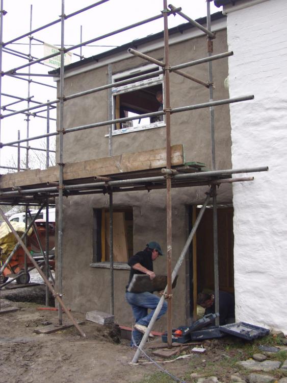

zoothorn Posted December 22, 2019 Author Posted December 22, 2019 Can anyone help here. I have been quoted for rendering. Its been done, but the galvanised lintels (undersides of) have been left un-rendered. The advise on here (when I quizzed the lintels bowing, clearly under too much weight above & not supported in midpoints whilst cured it seems) was that I shouldn't worry as they'll be covered by render anyway so the bow not visible. The plasterer has not rendered them/ the lintel undersides are exposed. He said its not that they cannot be done, just that he was not told to do them by the builder. I could not tell him just to do them please, as he was not the builder. On the estimate "render to exposed galvanised lintel undersides" was not put on (& I would not have expected such fine detail to be put on either). So what I should expect as a client-?
PeterW Posted December 22, 2019 Posted December 22, 2019 You render the face of the lintel, you can paint under it if you want but they don’t normally get rendered.
zoothorn Posted December 23, 2019 Author Posted December 23, 2019 17 hours ago, PeterW said: You render the face of the lintel, you can paint under it if you want but they don’t normally get rendered. Ah hi PeterW, but previous posts just said the lintel bow (i was 1st worried about) "not to worry you won't see it/ will be rendered over". So just the face then.. but the bow is as prominent as before (& galv undersides do look unfinished & 'raw'). Anyway another Q if I can: what are my insulation options in ceiling of lower floor? (IE the timber frame dividing floor, many wood joists the sides of each one strengthened by alu 'zzz' shaped brackets). Assuming this dividing floor is the least-insulating section of the two rooms (I think this is what the BCO said) I know I can go typical orange loft stuff up in these ~10" gaps. But as I'm concerned with noise from this lower room going UP & out the roof (noisy router for eg) would this "sound rockwool" slab stuff be an good option?

PeterW Posted December 23, 2019 Posted December 23, 2019 1 hour ago, zoothorn said: Ah hi PeterW, but previous posts just said the lintel bow (i was 1st worried about) "not to worry you won't see it/ will be rendered over". So just the face then.. but the bow is as prominent as before (& galv undersides do look unfinished & 'raw'). Anyway another Q if I can: what are my insulation options in ceiling of lower floor? (IE the timber frame dividing floor, many wood joists the sides of each one strengthened by alu 'zzz' shaped brackets). Assuming this dividing floor is the least-insulating section of the two rooms (I think this is what the BCO said) I know I can go typical orange loft stuff up in these ~10" gaps. But as I'm concerned with noise from this lower room going UP & out the roof (noisy router for eg) would this "sound rockwool" slab stuff be an good option? Sound isn’t your problem here - you need proper insulation as below is an unheated space. It will need PIR of 130-140mm plus the remainder filled with a sound insulation such as a Rockwool batt at 80-100mm. Odd question though, if you’re the only one there, you won’t hear the sound ..???? You can only be in one room at once ..??? On the lintel, I would have expected the guy rendering to run the bead horizontal and make the bow less noticeable.
Declan52 Posted December 23, 2019 Posted December 23, 2019 Bond a strip of plasterboard to the underside. Then fill the front edge to form a straight clean edge.
PeterW Posted December 23, 2019 Posted December 23, 2019 14 minutes ago, Declan52 said: Bond a strip of plasterboard to the underside. Then fill the front edge to form a straight clean edge. Would need to be cement board as it’s external, but yes you could do that.

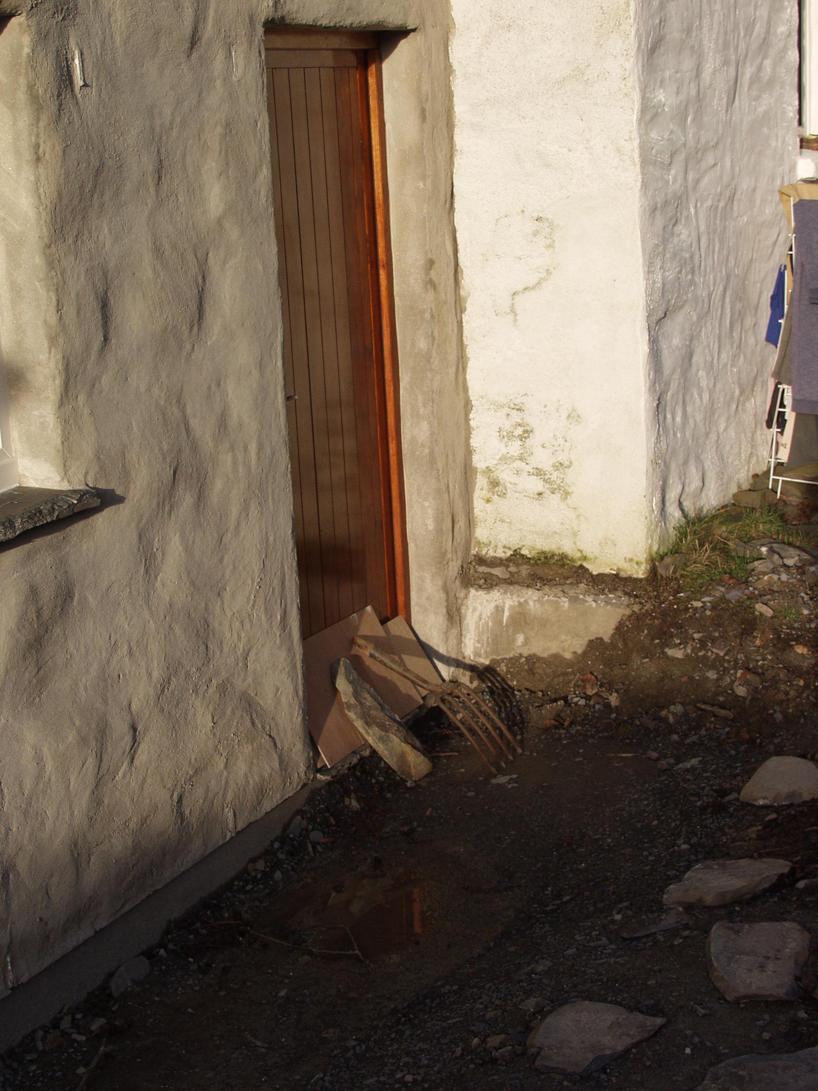

zoothorn Posted December 23, 2019 Author Posted December 23, 2019 Ok another thing I need to clarify/ opinions please. Here is the exposed foundation 'coin' on the corner of existing white wall (just to the RHS of new door here): a big block of grey slate, below which the earth/ clay is visible (one reason I didn't want to go down this low!). Is there any structural issues with this situation? should the builder have left this corner like this? I can see erosion of the soil below this block which is highly alarming, to me.
