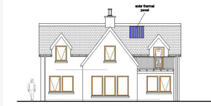

a friend drew up these designs for me on the basis of designing a straightforward cheap to build house, what does everyone think? any suggestions welcome, thanks
New House - Ground Floor.pdf 147.99 kB · 1 download New House - First Floor.pdf 110.28 kB · 1 download New House - Elevations.pdf 101.98 kB · 3 downloads
I'm sure others will offer comments here. But one point on the elevations which way is south, north etc
Also if cost is a factor are four bathroom/ensuite/wc required?

A few observations:
If the FRONT (which I take to be the bottom on the plans) faces south, then you have put the most important rooms, facing north where they will get no sun.  I wold put Family / kitchen /diner down one side of the house with dual aspect to get the sun at the front and open out to the garden at the back.  I would put the lounge at the front the other side to get the sun, and utiliy and bedroom at the back.
We had a very similar staircase in the middle with a gallery landing.  It certainly gave a wow factor but it uses up a LOT of space. That does not fit with cheap to build?  I am not saying change it, as it was a feature we liked, but I was always conscious of just how much space it used up.
I suspect you are going to have to do a LOT more work than you are expecting to get down to your price.

Ok ...
make all the windows the same size - it will look better and also give more symmetry and potentially save cost.
get rid of the utility door - you will never use it. You will use the front door or the patio doors.

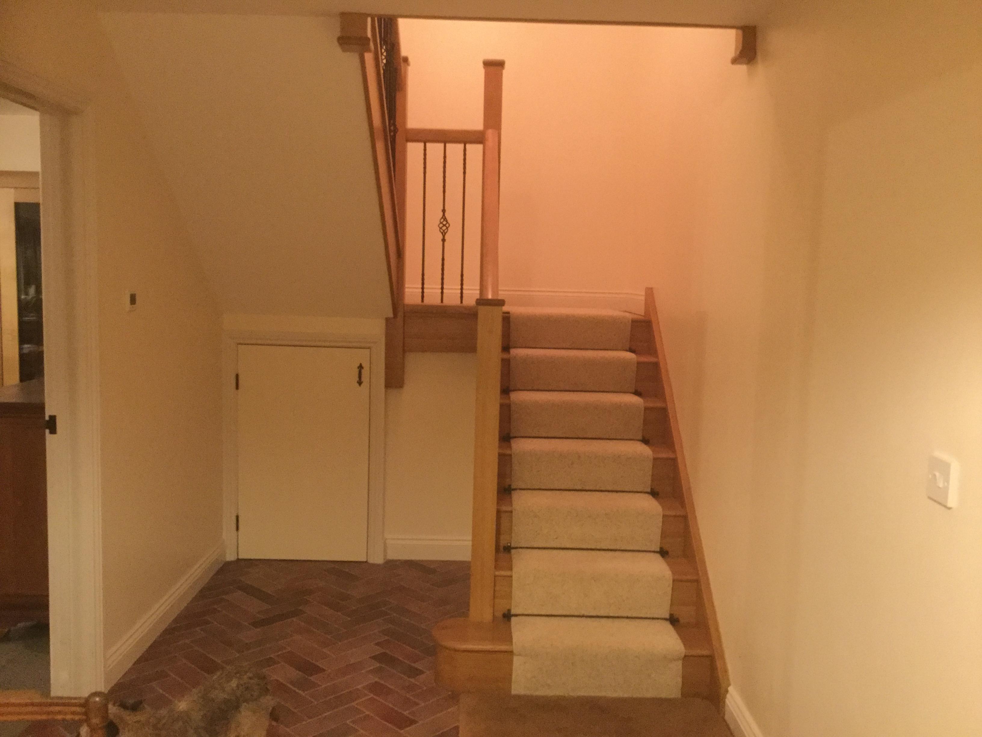

move the downstairs toilet into the end of the utility off study / bed 5. Will make it more useable as bedroom and also look at how you would add a shower to it. This will open up the hallway and make more of a feature.
keep the bathroom and en-suite and change those to have velux windows. Nice detail and cleans that back wall up from having 2 small windows.
turn the stairs 90 degrees anti clockwise so they face the front door - make them a feature
you will struggle to do this with a main contractor at £220k - plenty of ways to save money but they mean making the place smaller.

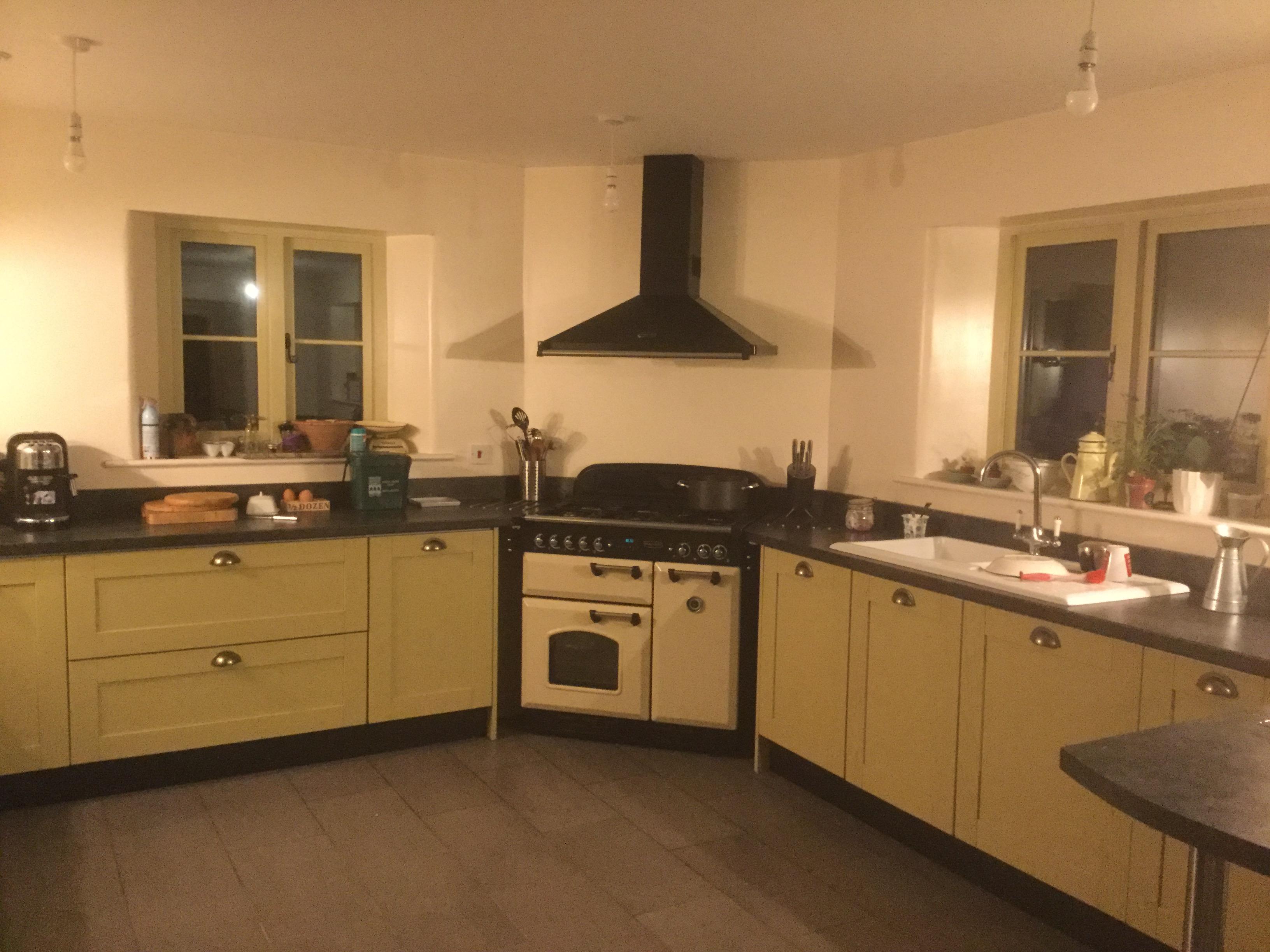

Yes, our kitchen is dual aspect (actually triple aspect with dining room end) but again budget may prevail, also more windows means less wall space for cupboards, wardrobes etc. (My wife did not want wall cupboards as she is fairly short) I had to find a solution to fit the range cooker somewhere without it being in a corner because of the windows and I did this;- a little waste of space but brilliant (IMO) and works very well, corners in kitchens can be a pain.

@Amateur bob

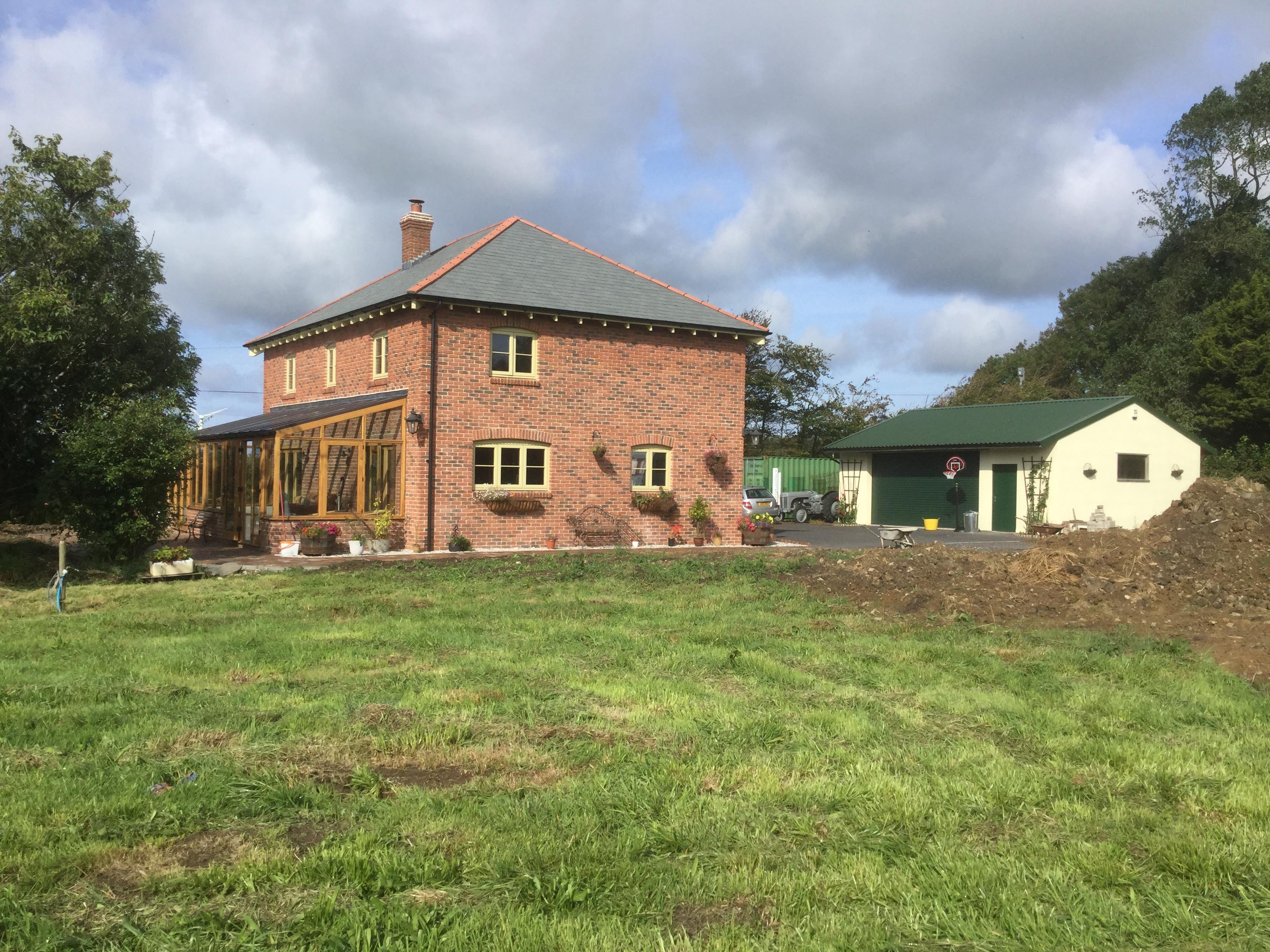

I started off with a bit that jutted out at the front. This can add to the cost of the project as you have knock on costs in pretty much all trades later. Seems a bit pointless as you appear to be gaining hardly any extra space. Below is what we started off with.
Also for the roof prehaps its different where you are, but it would appear that you have two full height rooms and then a loft space (why not just store in a shed if you live in a farm)? What about building a room in the roof design, with the roof trusses forming the structural walls of the upstairs as well, there are many different ways of doing this.

For what my input is worth, I would be a touch concerned that the Family / kitchen room along the back could end up looking quite long and narrow - I think @ProDave raises an interesting point about its location, given the orientation of the house.
I also agree with @Thedreamer regarding the front elevation and the benefits of that bit jutting out. If budgets are tight, then the fewer angles and corners etc the better I would have thought.
Again, it is difficult to advise as we do not know your specific requirements - do you need 5 bedrooms and 3 bathrooms upstairs?
If so great, if not, then a re-configure might be able to save some money.
If you can get away with fewer bedrooms then layouts such as mine, @ProDave,@Thedreamerand perhaps @joe90might assist.
Finally, we have a utility room / boot room with a door and have found it to be the most useful thing ever. That said, it ties in with the outside car port and drive etc, so again, as @PeterWsays, a door may or may not be useful depending upon how it fits in with the outside space.

On 22/11/2019 at 20:12, Thedreamer said:
@Amateur bob
Just out of interest what do you keep on the farm?
i understand what your saying about the bit that sticks out at the front, the only thing i would say is that it adds character although there could mabye be a cheaper way that doesnt involve it tying into the full height of house/roof, a loft room may be a possible consideration but again would add costs, i do have sheds on farm which is why i dont need garage we are mainly cereals
