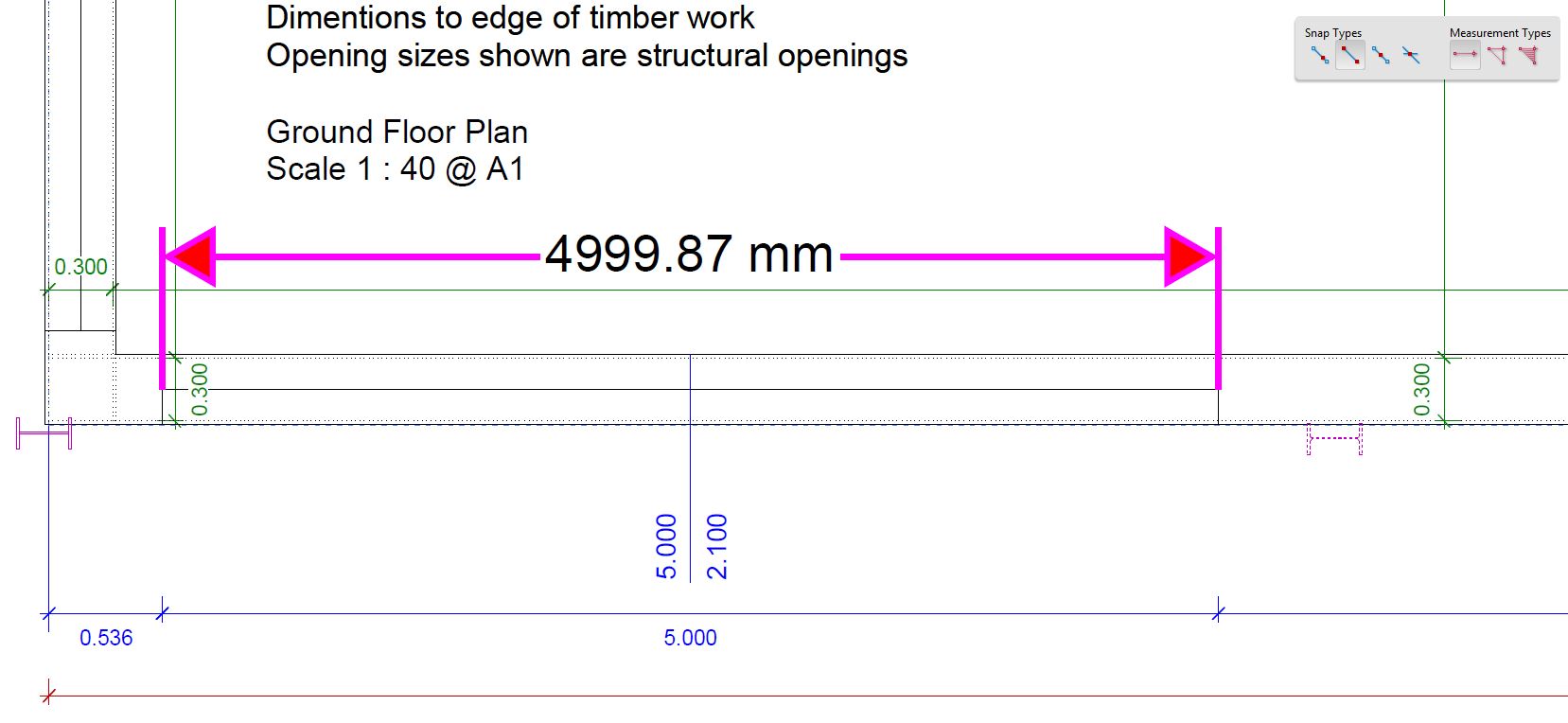

Vijay Posted October 23, 2016 Posted October 23, 2016 Hi, Is there any easy to use software that will allow me to get accurate dimensions off plans from either PDF or CAD files? Basically I want to highlight 2 points and get an accurate dimension. Cheers Vijay
IanR Posted October 23, 2016 Posted October 23, 2016 The free acrobat reader from Adobe has a measure option under analyse. You just need to select it then right mouse click and set the scale to what the drawing is.
TerryE Posted October 23, 2016 Posted October 23, 2016 @Vijay, I use Draftsight, but it can run like a dog if you use it on a typical laptop. AFAIK, it really needs a PC with decent CUDA graphics card to get responsive performance. Also try the VariCAD Viewer. This will open DRW files and you can zip around them, take measurements and print off extracts fast. Be aware that it also the creating package renders the PDF file. This might be using vector graphics but many generate diagrams at a give BPI for the target page size; so if you zoom in then drawing starts to look pixelated. Hopefully your diagrams include a scale rule to validate scaling, but as Sensus says you can't guarantee accuracy as you can with a CAD viewer's measure function. 1

IanR Posted October 23, 2016 Posted October 23, 2016 27 minutes ago, Sensus said: although as previously discussed, an accuracy of 'less than a millimetre' becomes an accuracy of 'less than half a metre' at 1:500 scale That's not what I'm saying Say a Ground Floor Plan at 50:1, correctly printed to PDF, will be able to be measured, within Acrobat Reader, to within 1mm of its Full Scale dimension.
IanR Posted October 23, 2016 Posted October 23, 2016 1 minute ago, Sensus said: And as I said, it depends on the software used to generate the PDF whether it preserves the native CAD accuracy. Some does, some doesn't. Are you suggesting that there is CAD software that is not able to print to scale? While errors can occur, as Ferdinand points out, with physically printing on to paper, not such errors occur when the file is electronically printed to PDF, as long as the Architect knows the basics.
IanR Posted October 23, 2016 Posted October 23, 2016 13 minutes ago, Sensus said: I'm suggesting that there is PDF creator software that doesn't. See TerryE's comments, above. Many CAD programs 'print' to CAD creator software (eg. CutePDF writer) as though they are sending the data to a printer or plotter. It's the creator software that then generates the actual PDF file, and no, no all of them create files that preserve the dimensions to the level of decimal-point accuracy that you gent in the native CAD format. Some don't even preserve vector dimensions at all. Surprisingly, it's a fairly recent addition to AutoCAD that it can print directly to PDF with a native 'driver'/PDF creator. There are some CAD packages that still don't, some people still running old enough versions of AutoCAD that they don't have the built-in functionality, and some who just prefer using PDF creators like CutePDF writer, out of habit. There are also cases where someone has manipulated or recreated a PDF file outside of CAD (for example, by editing in Photoshop or other graphics software - commonly used to add colour to AutoCAD generated drawings for presentational purposes as AutoCAD's colouring capabilities are limited). Well, I can vouch for CutePDF, although I generally use the Acrobat drivers. It's probably worth you getting familiar with the print options, you may be more successful with your printing.

IanR Posted October 23, 2016 Posted October 23, 2016 (edited) 3 hours ago, Sensus said: I am successful with my printing, thanks very much. That's not evidenced by your opinion on the capabilities of printing to PDF. @TerryE with all due respect, that's a poorly "printed", PDF and if it were part of the delivery for a paid-for Service I would have refused it. It looks like the result of a "PrtScn". @PeterW The quote of mine you have used is attempting to say that the accuracy of "within 1mm" that I'm suggesting is of the true 1:1 length. Here's one I did not do earlier. This is the corner of the GA drawing for my frame. It's received directly from the Frame designers and I've just opened it up, selected measure and set the 1:40 drawing scale: The opening I've measured using the free Acrobat Reader application is 5000mm wide, as shown by the CAD dimensions, the dimension that the measure tool puts on the drawing is the one that reads 4999.87mm So, accurate to 0.13mm in 5000mm on an A1 formatted drawing that is drawn at a 1:40 scale. I'm zoomed in to 200% to take the measurement. Any fuzziness of the image is due to JPeg compression. There is nothing special about the PDF, it's printed in colour at the correct A1 Size and is 121Kb filesize. I could have picked any of the drawings I have received from the frame designers, or the original Architect that helped with the Design & Appearance Condition, or the Architect I used for some "Passive House" detailing work or the drainage guy that specified the land drains, or even any of my own. CAD Authoring, digital collaboration and digital archiving got its act together years ago to ensure that when the paper-less society does eventually arrive, original drawings archived in digital format can be relied upon to not require legacy CAD systems to remain functioning in order to interpret a drawing. Adobe are at the fore-front of this for 2D data and are pushing hard to do the same for 3D. Edited October 23, 2016 by IanR

IanR Posted October 23, 2016 Posted October 23, 2016 OK, back to the OP: Quote Is there any easy to use software that will allow me to get accurate dimensions off plans from either PDF or CAD files Answer: Yes there is, the free acrobat reader application that's installed on the majority of PCs and laptops. All discussion beyond this regarding level of accuracy is due to an incorrect assertion that PDFs cannot be relied upon, I'm not suggesting that the level of accuracy achievable is required by the builder on site. 9 minutes ago, PeterW said: It would be interesting to compare that dimension on your plan with what has actually been built and I'd expect it's +/- 10mm. That dimension measures 5003mm on the built frame, all openings are within a few mm of their design size . Touchwood have a pretty good process for hitting the opening sizes "spot on". But I understand your point if it were a masonry build.
