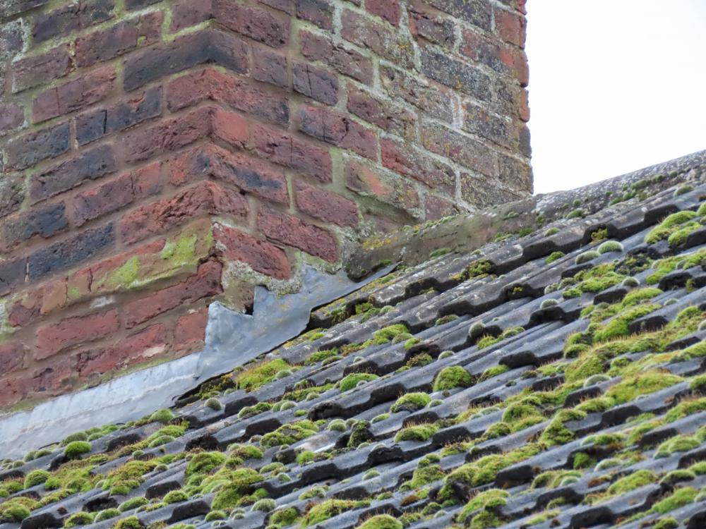

H F Posted November 17, 2019 Author Share Posted November 17, 2019 (edited) We had a roofer come out yesterday that looked up at the chimney from the ground - he also thought the brickwork looked saturated and wet, and has quoted us £1900 + VAT to rebuild the chimney - we would need to supply the bricks. Given that we’ve not had a leak or any water making its way into the house via the chimney before (and we’ve endured heavy rains before) I’m not sure whether this required, and whether the water making its way into the house is coming via a potential hole or shoddy lead flashing. We’re going to have that inspected tomorrow morning by a pro. On a closing point is there any other threats a damp/porous chimney poses to the rest of the house in terms of damp, mould, etc? Edited November 17, 2019 by Home Farm Link to comment Share on other sites More sharing options...

H F Posted November 17, 2019 Author Share Posted November 17, 2019 (edited) Right now I’m just trying to figure out whether wet, porous bricks can pose any further damage to the house in general... that’ll make up our minds. There’s also always the option of waterproofing/treating the bricks to prevent the water from penetrating them as mentioned earlier. I guess that the rebuild is the better fix. thoughts? Edited November 17, 2019 by Home Farm Link to comment Share on other sites More sharing options...
Onoff Posted November 17, 2019 Share Posted November 17, 2019 1 hour ago, Home Farm said: We had a roofer come out yesterday that looked up at the chimney from the ground - he also thought the brickwork looked saturated and wet, and has quoted us £1900 + VAT to rebuild the chimney - we would need to supply the bricks. Given that we’ve not had a leak or any water making its way into the house via the chimney before (and we’ve endured heavy rains before) I’m not sure whether this required, and whether the water making its way into the house is coming via a potential hole or shoddy lead flashing. We’re going to have that inspected tomorrow morning by a pro. On a closing point is there any other threat a damp/porous chimney poses to the rest of the house in terms of damp, mould, etc? Eventually your chimney could become structurally unsound. Link to comment Share on other sites More sharing options...
H F Posted November 17, 2019 Author Share Posted November 17, 2019 8 minutes ago, Onoff said: Eventually your chimney could become structurally unsound. Hmmm. Not what I wanted to hear. So it might be worth getting done. Sigh. Link to comment Share on other sites More sharing options...
Temp Posted November 17, 2019 Share Posted November 17, 2019 (edited) A lot of new bricks are porous. I once filled a bucket with our house bricks then filled all the space with water. They fizzed and popped and absorbed the lot. Next day almost no water in the bucket and individual bricks felt really heavy. A new chimney or rebuild should have a DP to stop ingress through damp bricks. https://www.labcwarranty.co.uk/blog/how-to-ensure-your-chimney-is-constructed-correctly/ Edited November 17, 2019 by Temp Link to comment Share on other sites More sharing options...

PeterW Posted November 17, 2019 Share Posted November 17, 2019 Also worth when doing a new chimney to keep it out of the attic / internal wall space. Couple done recently have used an external build up so for a significant part the chimney is outside the main structure -reduce potential damp to a minimum. Link to comment Share on other sites More sharing options...
H F Posted November 17, 2019 Author Share Posted November 17, 2019 5 minutes ago, Ferdinand said: Is it a thing that can be scheduled for better weather next year? Ask roofer? That would be a consideration... maybe if we can temporarily plug the cause of the water making its way into the house, then that buys us time for the summer, and get more second opinions. Link to comment Share on other sites More sharing options...

joe90 Posted November 17, 2019 Share Posted November 17, 2019 I have recently “bodged” my son in laws chimney that was leaking slightly, looks a lot like yours. A bit of flash banding and mortar did the job. Reason for the bodge is he is having a loft conversion in the next two years and the chimney might go or be rebuilt as part of that work so no point in a proper job now. His is three stories but access via a two story extension was not too bad (plus I used to be a mountaineer/rock climber). Link to comment Share on other sites More sharing options...

H F Posted November 18, 2019 Author Share Posted November 18, 2019 19 hours ago, Temp said: A new chimney or rebuild should have a DP to stop ingress through damp bricks. Agreed. We have someone coming today. They’ll get on the roof and look for the cause. When we rebuild, a DP will definitely go in. Link to comment Share on other sites More sharing options...
