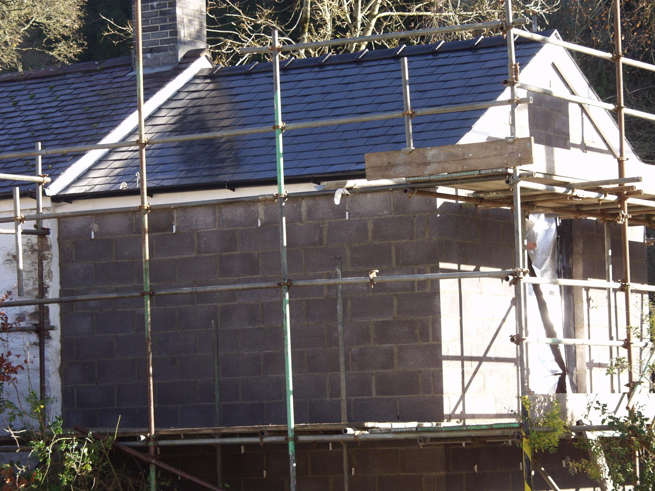

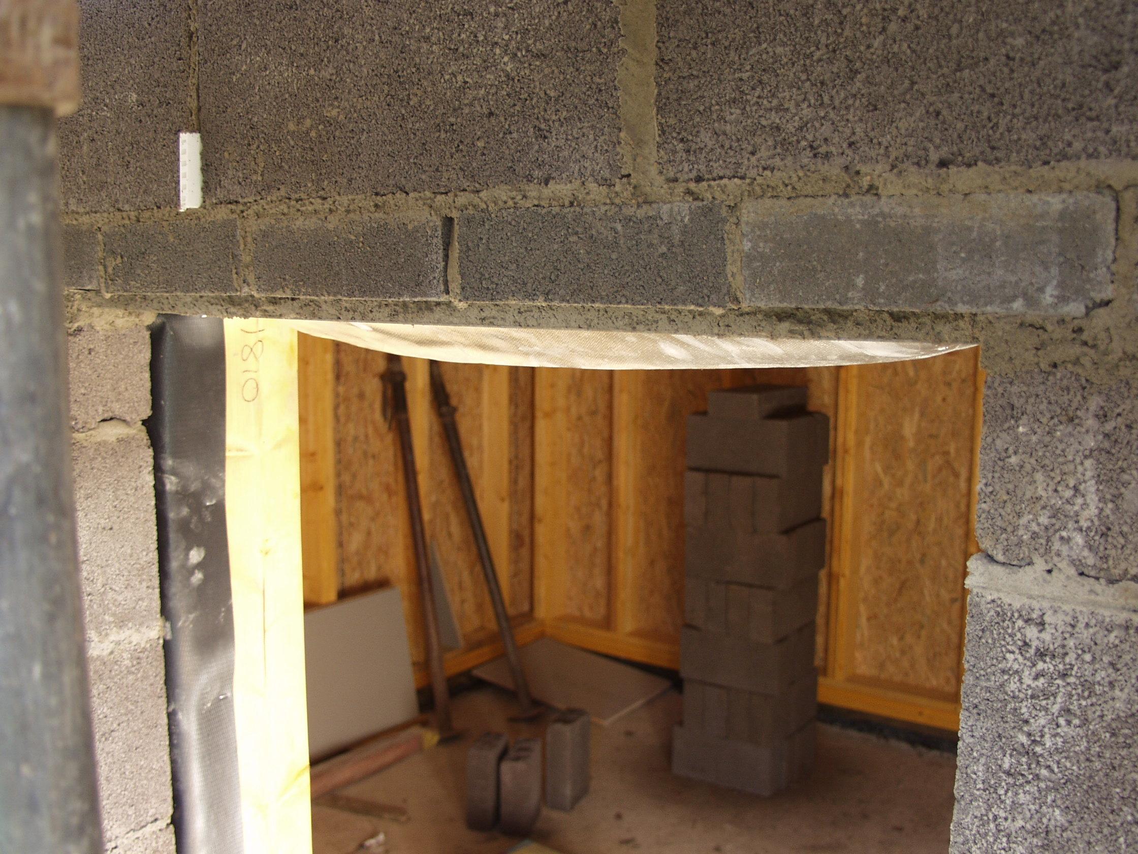

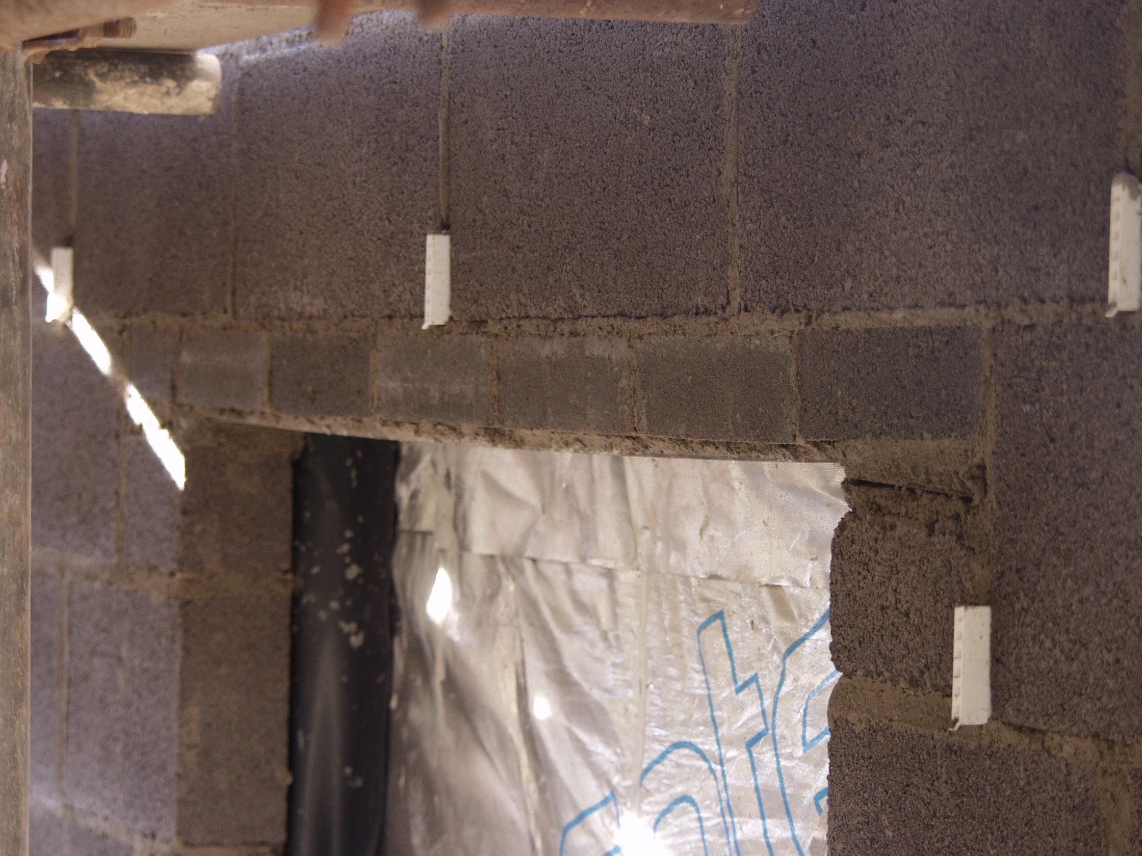

zoothorn Posted November 18, 2019 Author Share Posted November 18, 2019 Temp camera fix/ no idea how. 1. window lintel bow (the 1150mm W window which will be 'packed out LHS only with timber to 920mm.. whether I can solid-up this open timber area I still don't know, I got my figure wrong at 2150mm before which c*cked that question up) 2. Door next to it, entry to lower room Link to comment Share on other sites More sharing options...
PeterW Posted November 18, 2019 Share Posted November 18, 2019 Struggling to see the bow... I wouldn’t be worried Link to comment Share on other sites More sharing options...
Declan52 Posted November 18, 2019 Share Posted November 18, 2019 Seriously you need to take a breath and relax. You have got yourself all worked up over nothing and are only adding more stress which you can't handle. Strike the window bow of your list of things to confront the builder with and move on. Link to comment Share on other sites More sharing options...

Declan52 Posted November 18, 2019 Share Posted November 18, 2019 No once the window is in and it's plastered up you won't see any of it. In the famous words of the ice Princess Elsa just let it go. Your worrying over nothing. You have been told numerous times it's nothing to be concerned about so just file it away and move on to the next dilemma. The piece of slate is just there to help them bed the lintel up so it sits level. No big deal. Happens every day on every site. Link to comment Share on other sites More sharing options...
Danny68 Posted November 18, 2019 Share Posted November 18, 2019 You've got breeze block ,so it's going to be rendered / clad ? It will be corrected then ,On a one off let it go . In future pull em soon as you see it or change your brickie Link to comment Share on other sites More sharing options...

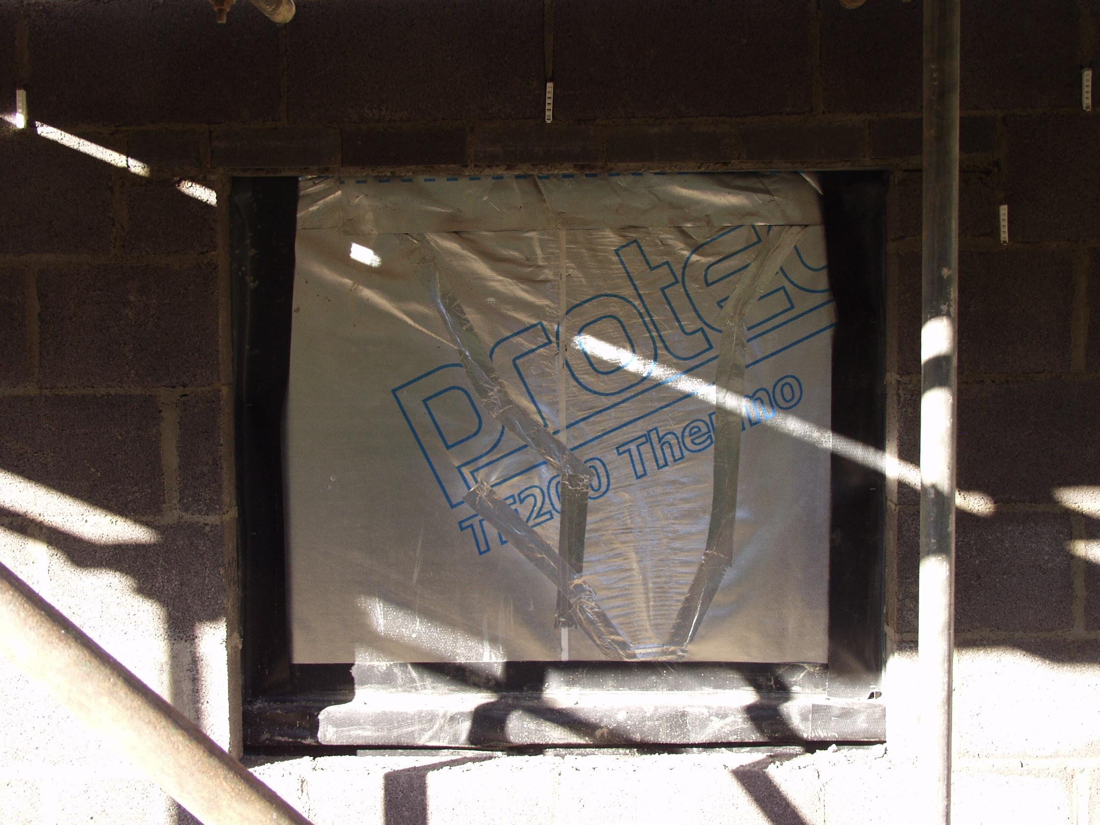

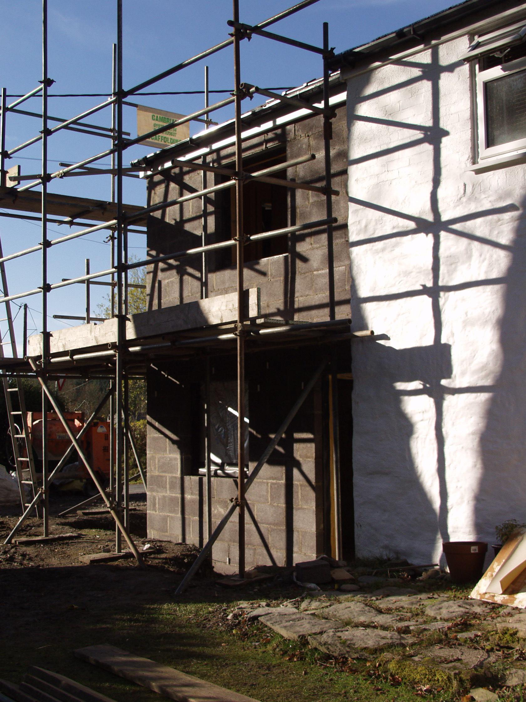

zoothorn Posted November 18, 2019 Author Share Posted November 18, 2019 @Declan52 could I get your opinion on what I might do with this window, re. minimising the opening W? I got in a pickle before saying opening 2150mm. Its not that wide, its 1150mm. The last pic above is the window. Its position & width determined by/ to coincide with vertical TFrame studs behind. I was told 'you dont have to have this wide, you can have it narrower'.. but little did I know this meant timber packing either side, or just one side as I'd prefer (symmetry reasons).. I just naturally thought 'block/ brick' pretty simple. But I can't do this apparantly & it has to be timber. So we're going to minimise W to 920mm, packing the LHS. I expect the fastest way possible, wood then, but this will mean a hollow area (sound escaping).. so I want to explore ways to solidify it up prior to mesh/ plaster over. Or anyone any ideas? thanks, zoot. Link to comment Share on other sites More sharing options...

Declan52 Posted November 18, 2019 Share Posted November 18, 2019 23 minutes ago, zoothorn said: @Declan52 could I get your opinion on what I might do with this window, re. minimising the opening W? I got in a pickle before saying opening 2150mm. Its not that wide, its 1150mm. The last pic above is the window. Its position & width determined by/ to coincide with vertical TFrame studs behind. I was told 'you dont have to have this wide, you can have it narrower'.. but little did I know this meant timber packing either side, or just one side as I'd prefer (symmetry reasons).. I just naturally thought 'block/ brick' pretty simple. But I can't do this apparantly & it has to be timber. So we're going to minimise W to 920mm, packing the LHS. I expect the fastest way possible, wood then, but this will mean a hollow area (sound escaping).. so I want to explore ways to solidify it up prior to mesh/ plaster over. Or anyone any ideas? thanks, zoot. Just leave it as it is. Why try to make it smaller by altering it when it will just be a bodge. If you use timber no matter what you do it will move different from the blocks so will crack. It's only 200mm wider. If you go for a thicker frame uPVC 3g unit most of that extra will be ate up by the frame width so you will have the actual glass near enough what you want. Link to comment Share on other sites More sharing options...

Gone West Posted November 18, 2019 Share Posted November 18, 2019 26 minutes ago, zoothorn said: Ive moved on then.. but still on same window/ got this opening to remedy. I think you would probably lose less sound through the opening if the window is kept to the original size. You can reduce sound loss by secondary glazing or shutters. Link to comment Share on other sites More sharing options...
zoothorn Posted November 18, 2019 Author Share Posted November 18, 2019 1 minute ago, Declan52 said: Just leave it as it is. Why try to make it smaller by altering it when it will just be a bodge. If you use timber no matter what you do it will move different from the blocks so will crack. It's only 200mm wider. If you go for a thicker frame uPVC 3g unit most of that extra will be ate up by the frame width so you will have the actual glass near enough what you want. Too late Declan, its been agreed @ 920mm. I just need to do what I can to address this timber 'packing' area that'll now happen here on the LHS. If I went with a window as per this opening (I never agreed to being this large width- it was just rush/ done as its intention was only to be a blank, me to utilise it 5 yrs away not not, plaster over the blank now: the BCO suddenly wants it done now only 4 days ago) it'll be totally incongrous to the adjacent smallish cottage windows. The design is to blend in, contoured render etc. Link to comment Share on other sites More sharing options...

PeterW Posted November 18, 2019 Share Posted November 18, 2019 Ok - you need to ask the builder to use concrete bricks or cut down blocks to slim down BOTH SIDES OF THE OPENING, as I have a cunning plan.. No.1, you cannot render over timber, or it will crack. No.2, if you just get them to slim the opening by 120mm each side, then you can create an inside “splay” so that the window is equally wider both sides and it looks correct by just joining the edge of the frame to the edge of the blockwork. This will look like it was meant to be done this way. Link to comment Share on other sites More sharing options...
