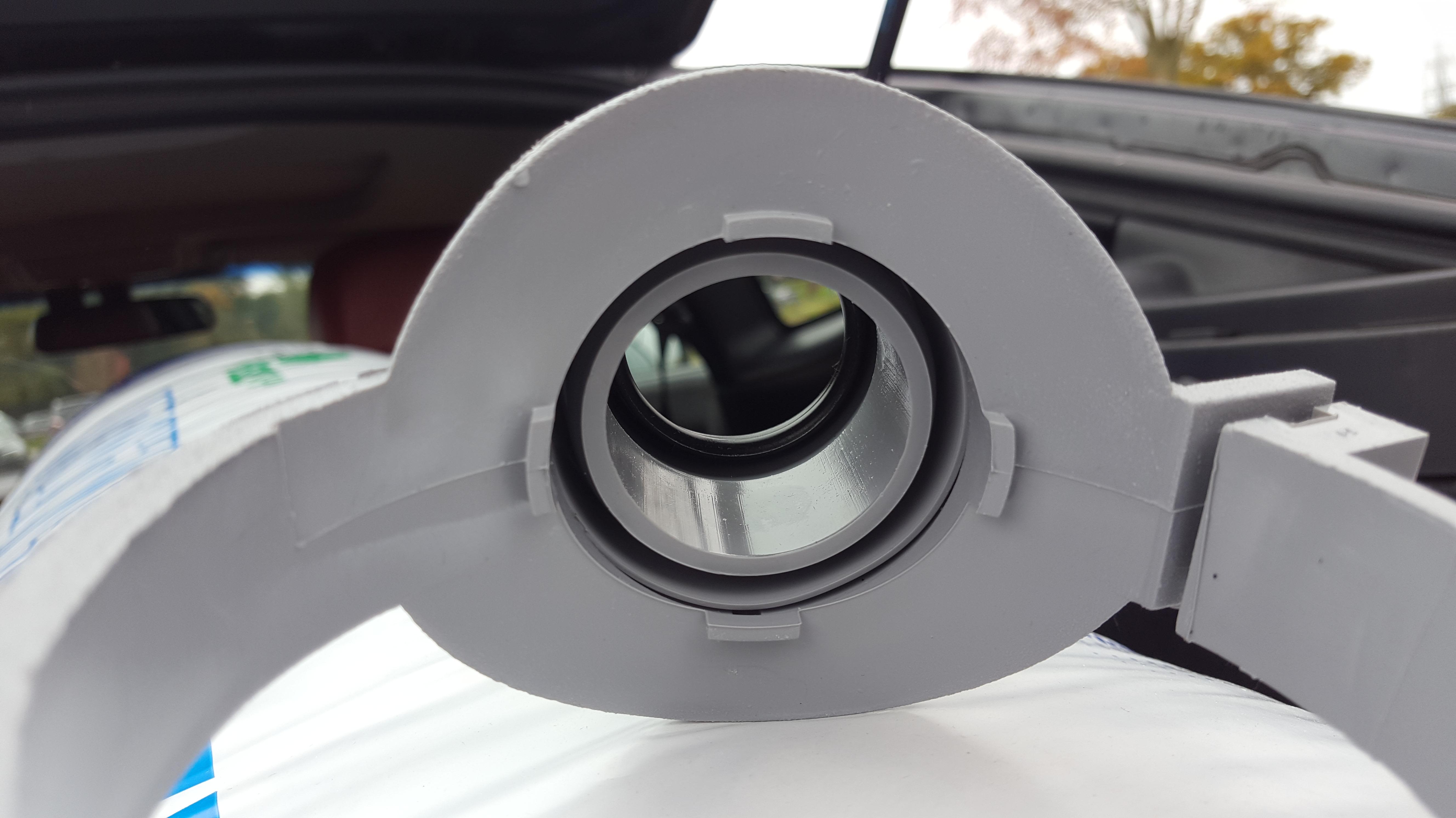

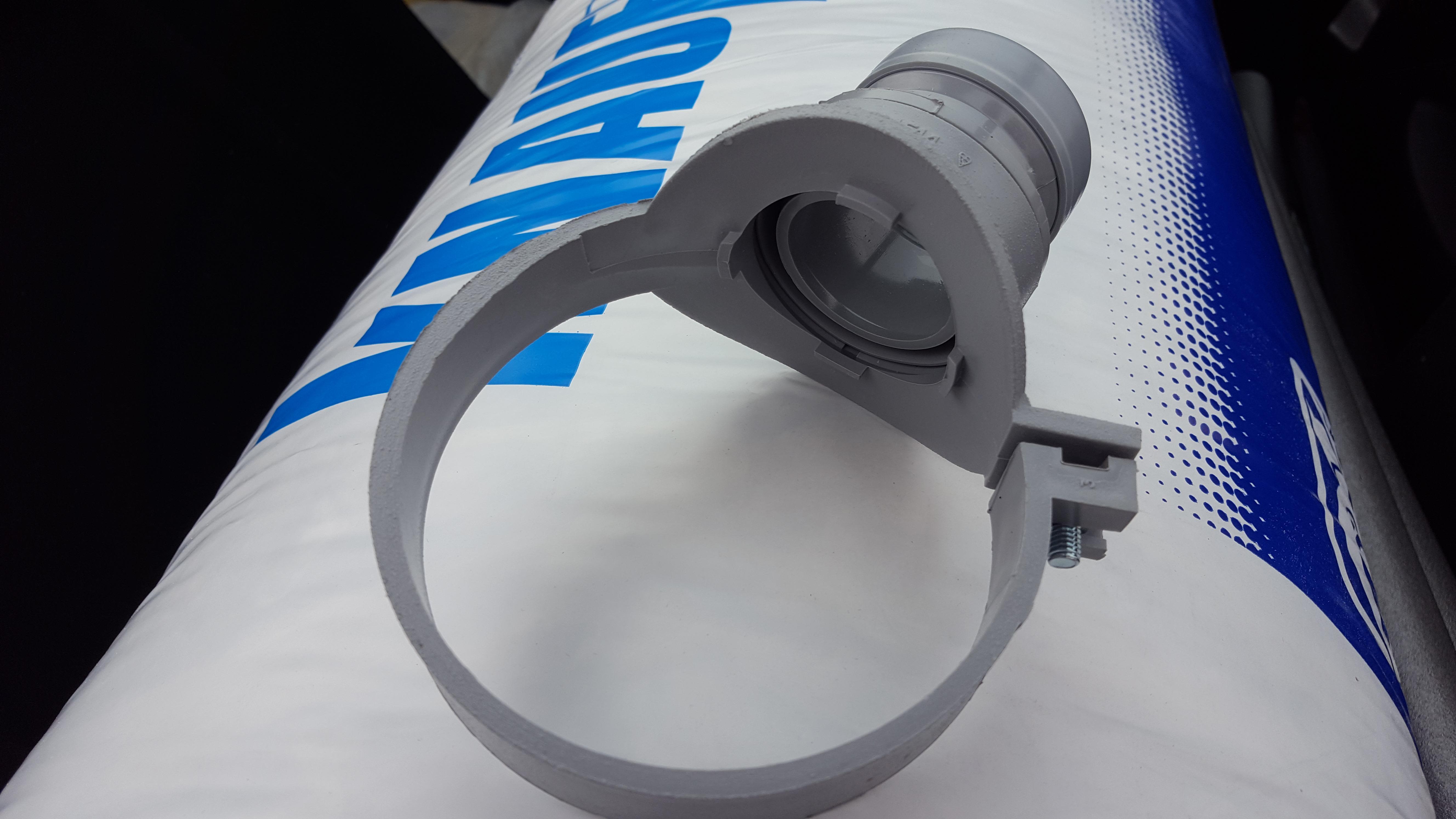

MJNewton Posted November 1, 2019 Share Posted November 1, 2019 (edited) For our new kitchen I need to tap into an internal soil stack in an adjacent to provide drainage to the sink and dishwasher. With it being an existing soils stack (therefore being unable to add a proper branch) I am going for a solvent weld strap boss. I am all too conscious of the fact that I've got one shot at this; and just to make life a bit more difficult access is quite difficult. Oh, and it's my first ever solvent weld. I opted to go for a quality make (Osma), that also matched the make of the existing pipe, and was a little surprised when I picked it up this morning to find that the mating surfaces weren't perfectly smooth. In particular there are mould lines that you can hopefully make out at the 3 and 9 o'clock positions in the second picture below: My understanding was that solvent weld isn't an adhesive but rather loosens the polymer chains of the mating surfaces which, when reformed, bind them together as one. Would non-perfectly-smooth surfaces inhibit this, or is the welding action quite significant in terms of how deep this loosening goes? Perhaps there are gap-filling properties also, or would that bring it back into being an adhesive? I did ask the guy on the plumbing counter if it was definitely okay but I could tell halfway through my question that he either didn't have a clue or couldn't care less either way (perhaps both!). I did wonder if I should smooth it out when a stanley blade, but didn't want to potentially cause a problem when one might not already exist! Any comments? Edited November 1, 2019 by MJNewton Link to comment Share on other sites More sharing options...

MJNewton Posted November 1, 2019 Author Share Posted November 1, 2019 (edited) Thanks everyone; it doesn't sound like my concerns are really concerns afterall. I suppose given that the surface of the soil pipe will be softened then even if the mould lines were going to present a ridge they would just 'bite' into the pipe anyway. I note that whilst the boss adapter (Osma 2S399) will be solvent welded into the strap boss it just has a push-fit connection seal for the incoming 40mm pipe. I was expecting this to be solvent welded also, and perhaps would've preferred this given the joint will eventually be inaccessible. Shouldn't be a problem if properly inserted and supported I suppose. (Good to see it has mould lines too!) Edited November 1, 2019 by MJNewton Link to comment Share on other sites More sharing options...

MJNewton Posted November 3, 2019 Author Share Posted November 3, 2019 I'm still a bit nervous about this job, mainly due to the limited access to the soil pipe and consequences if I don't get the weld good. I stumbled across the McAlpine mechanical stap boss which seems to get good reviews on the Screwfix site, several of which note a preference over the solvent weld variety. Has anyone used one? I am warming to it given I think it'll be a bit more forgiving than the 'one chance, dont mess it up' solvent weld strap boss option... (For those not familiar with it, this photo is of it with the winged installation tool present which is removed after fitting) I figured I could also add a ring of silicone on that mating face for added reassurance over just the expanding doughnut. Link to comment Share on other sites More sharing options...
PeterW Posted November 3, 2019 Share Posted November 3, 2019 Weld will be fine - the trick is to drill the hole slightly over the size of the lugs and a quick smear of glue on the pipe with a reasonable amount on the fitting. I use a clamp to hold the ends of the band together for 20 mins before putting the nut and bolt in - leave for an hour or two before you fit the pipes. Link to comment Share on other sites More sharing options...
