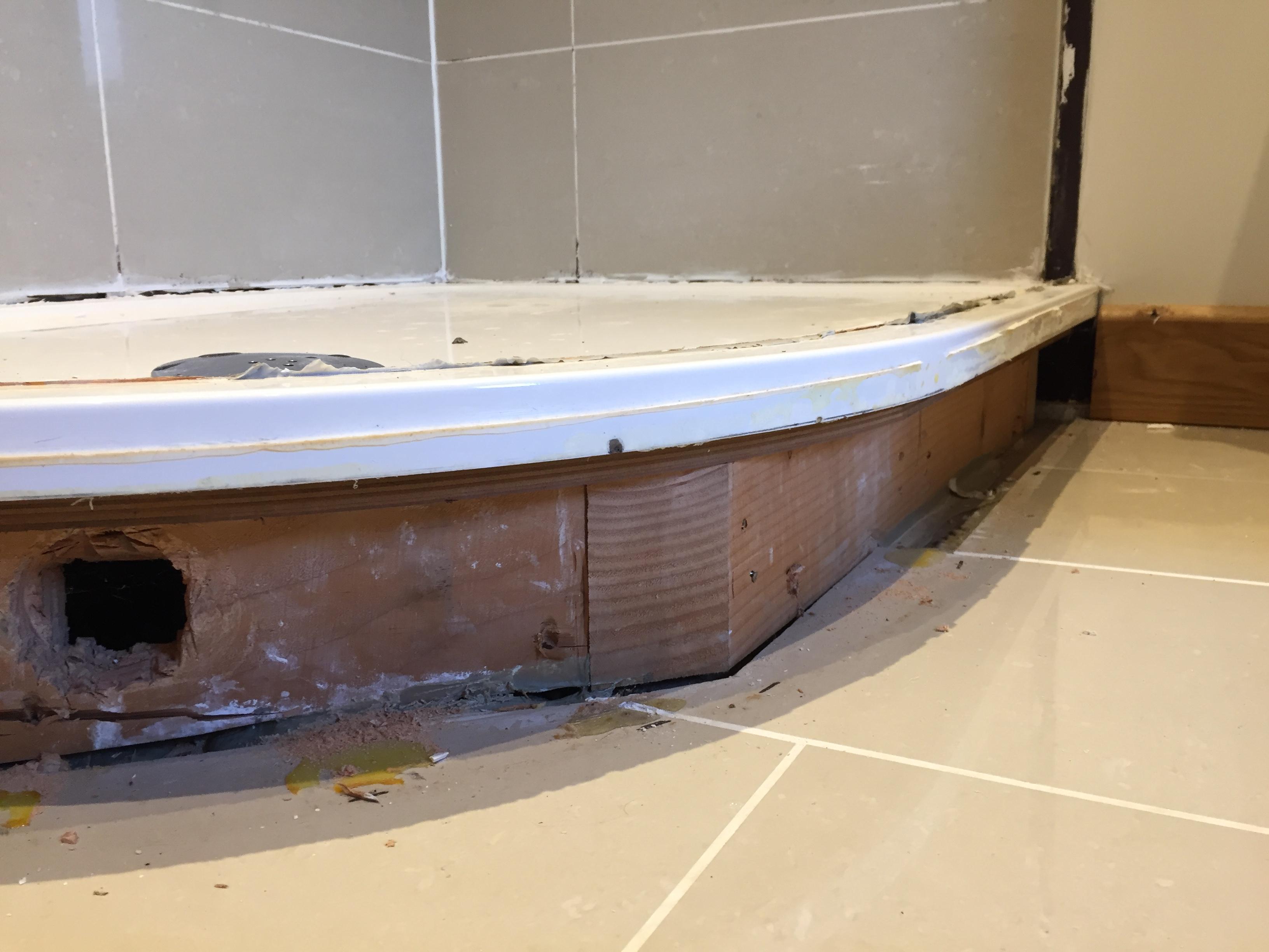

H F Posted October 30, 2019 Author Share Posted October 30, 2019 Next step is for me to remove the shower tray... it’s on a wood frame but can’t make out how it’s fixed to the frame. I assume it’s not screwed in. How are these typically fixed so that I can remove it? Link to comment Share on other sites More sharing options...

H F Posted October 30, 2019 Author Share Posted October 30, 2019 This thing isn’t budging. Advice anyone? Link to comment Share on other sites More sharing options...
Mr Punter Posted October 30, 2019 Share Posted October 30, 2019 Is it stuck down with mastic or Gripfil? If you are not going to use it again I suggest smack with a lump hammer. Wear goggles. Link to comment Share on other sites More sharing options...
Roundtuit Posted October 30, 2019 Share Posted October 30, 2019 5 minutes ago, Mr Punter said: smack with a lump hammer. Wear goggles. +1. Can you disconnect the waste first (through that access hole) just to make sure you dont break anything that doesn't want breaking? It looks like the frame is screwed together; might be less messy to remove some screws and try and knock a piece out to see what's going on. Link to comment Share on other sites More sharing options...
