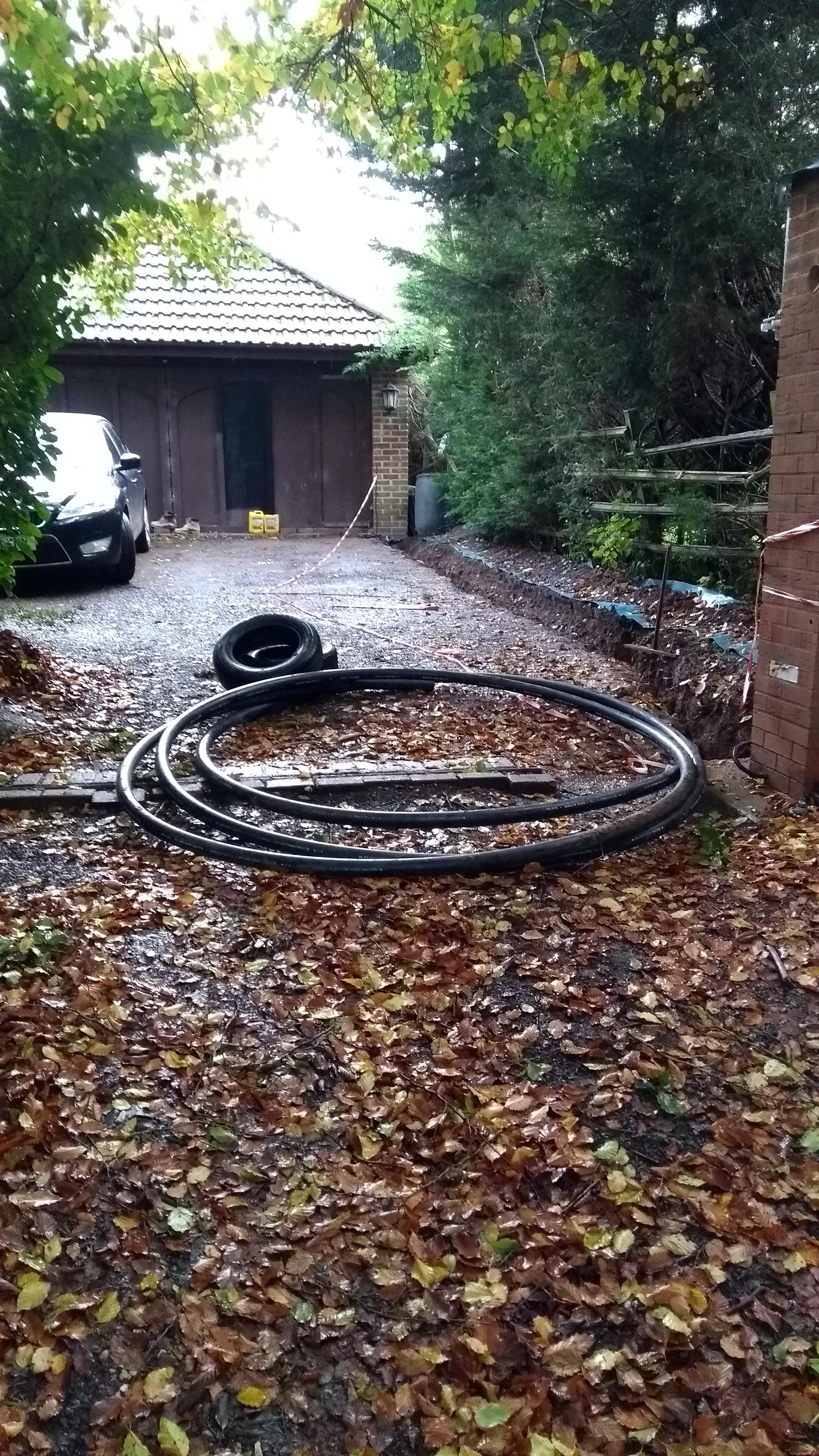

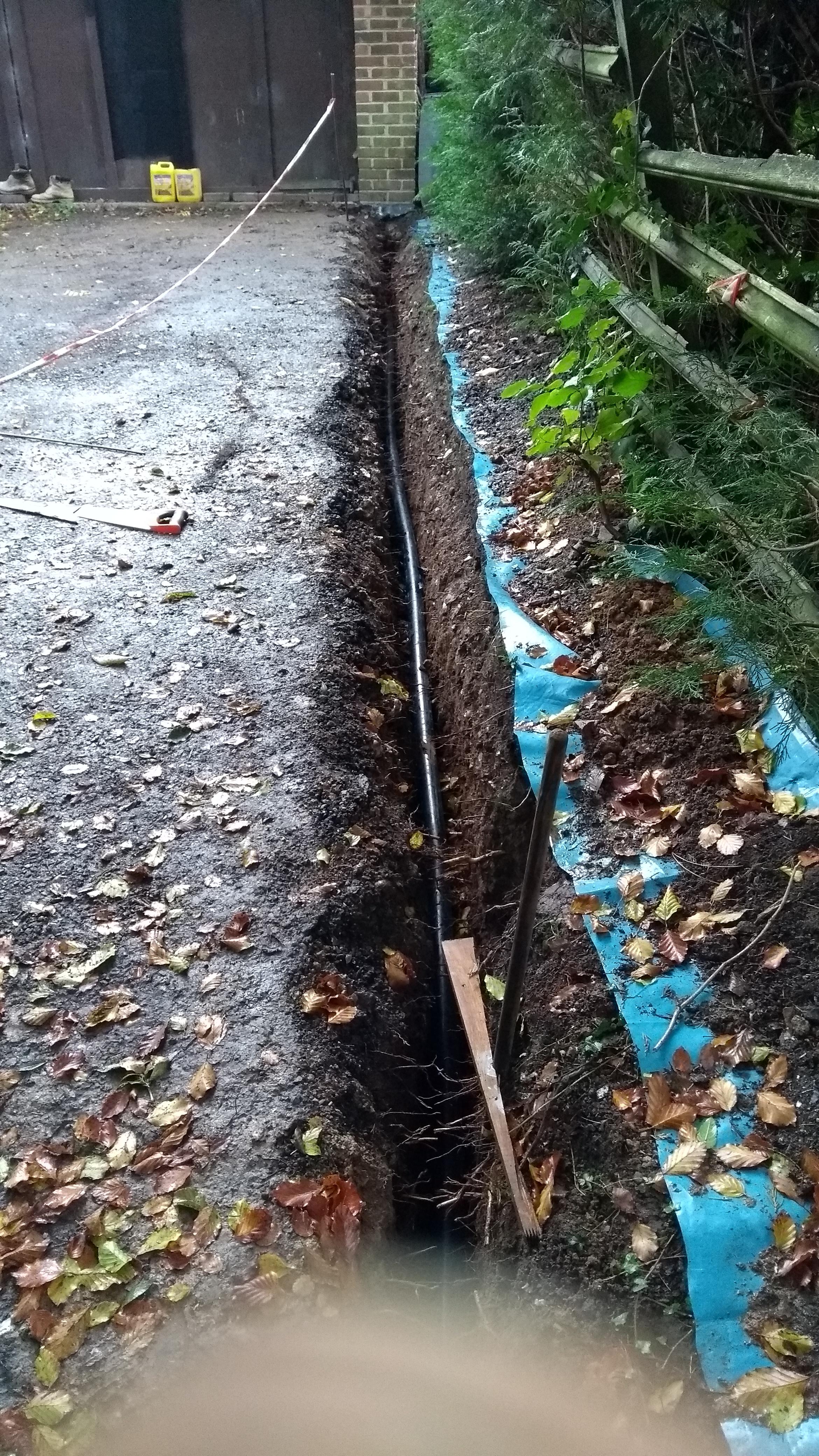

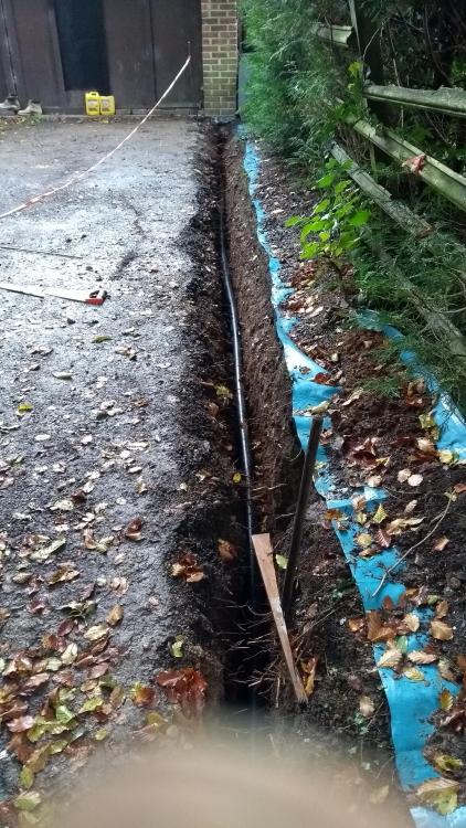

Onoff Posted October 25, 2020 Author Posted October 25, 2020 Got my duct in. Nom. 600mm deep trench, 60mm duct. Need to decide now on whether to put in bases for the future car port. Maybe I make some sacrificial OSB boxes and set them level. Thinking 600mm cubes.
joe90 Posted October 25, 2020 Posted October 25, 2020 2 minutes ago, Onoff said: Thinking 600mm cubes. More than adequate IMO, what are you going to set in the concrete to hold the posts or are you going to bolt them down?
Onoff Posted October 25, 2020 Author Posted October 25, 2020 1 minute ago, joe90 said: More than adequate IMO, what are you going to set in the concrete to hold the posts or are you going to bolt them down? Just cast them level and solid. Drill and resin fix to suit later on. Some form of U channel to take chunky wooden posts. 1

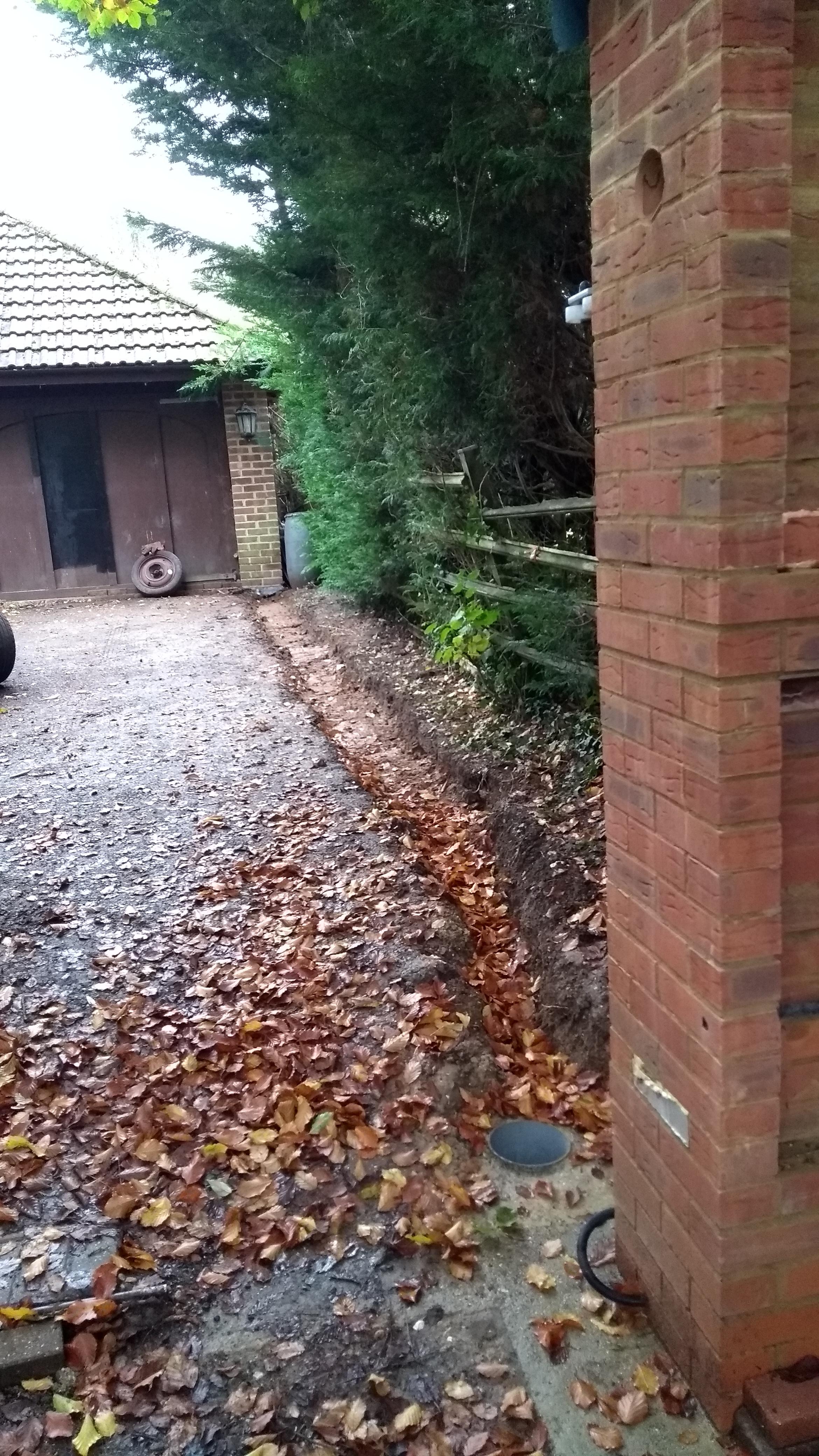

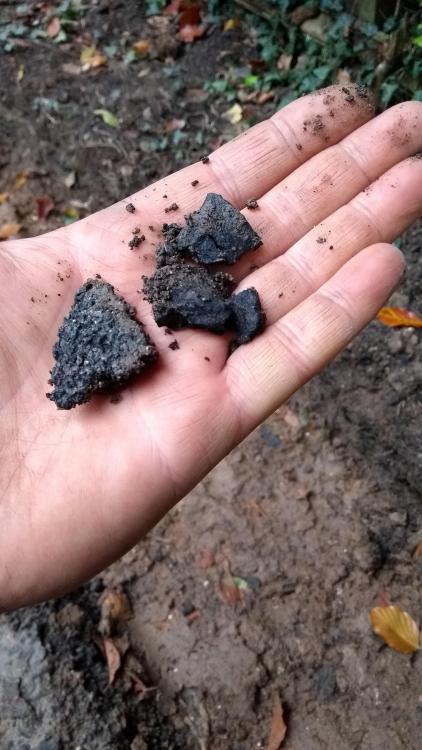

Onoff Posted October 27, 2020 Author Posted October 27, 2020 (edited) I'm filling in and not going to yet worry about car port plinths. When I started to dig my trench I first had to remove a poorly laid line of block paving bedded on a very weak mix. They all came out, more lifted tbh, easily and clean. This paving line sort of defined the edge of the drive. The rest of the drive comprises fairly compact small black stones & bits of "tar", some quite large as in fist size. Think of a load of rejected road materials having been dumped and flattened out. It's definitely not tarmac that's broken up over the years. The worst of it is the rusty nails that's meant many a punctured tyre over the years! The previous owner would it appears empty his wood boiler ash pan on the drive, the ash to fill in the rough drive surface. Now I'm filling the trench in I'm wondering whether to maybe stop 6" short of the surface and fill with Type 1. My worry is if I just fill with the excavated clay/soil, when it gets really wet down here this winter I'll just be churning a rut in the trench line everytime we drive over it. Filling in today, only thing I have to compact the dirt as I go is a 16lb sledge hammer used as a tamper. The trench at its narrowest is only about 4" wide, the width of a mattock blade. Edited October 27, 2020 by Onoff

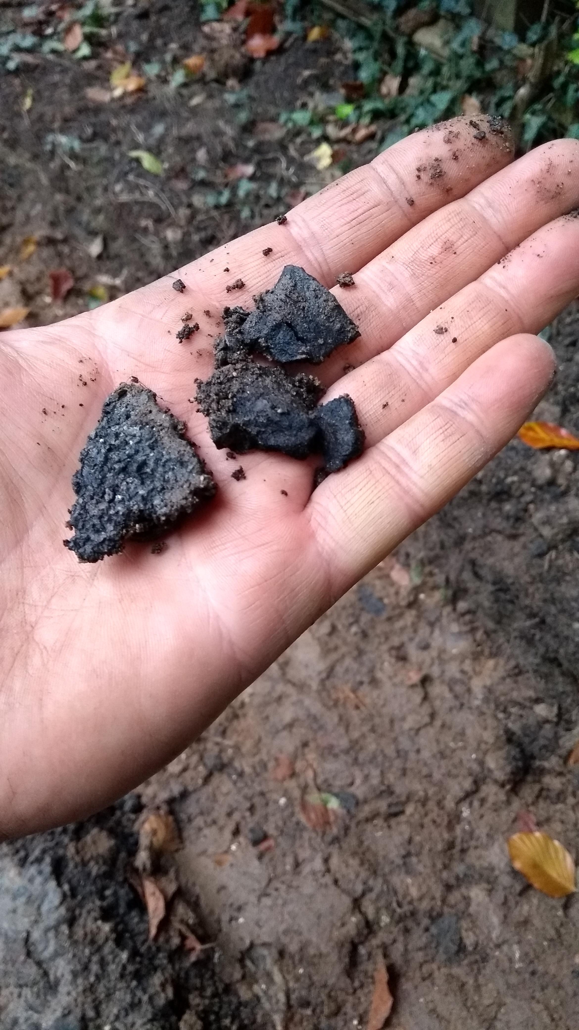

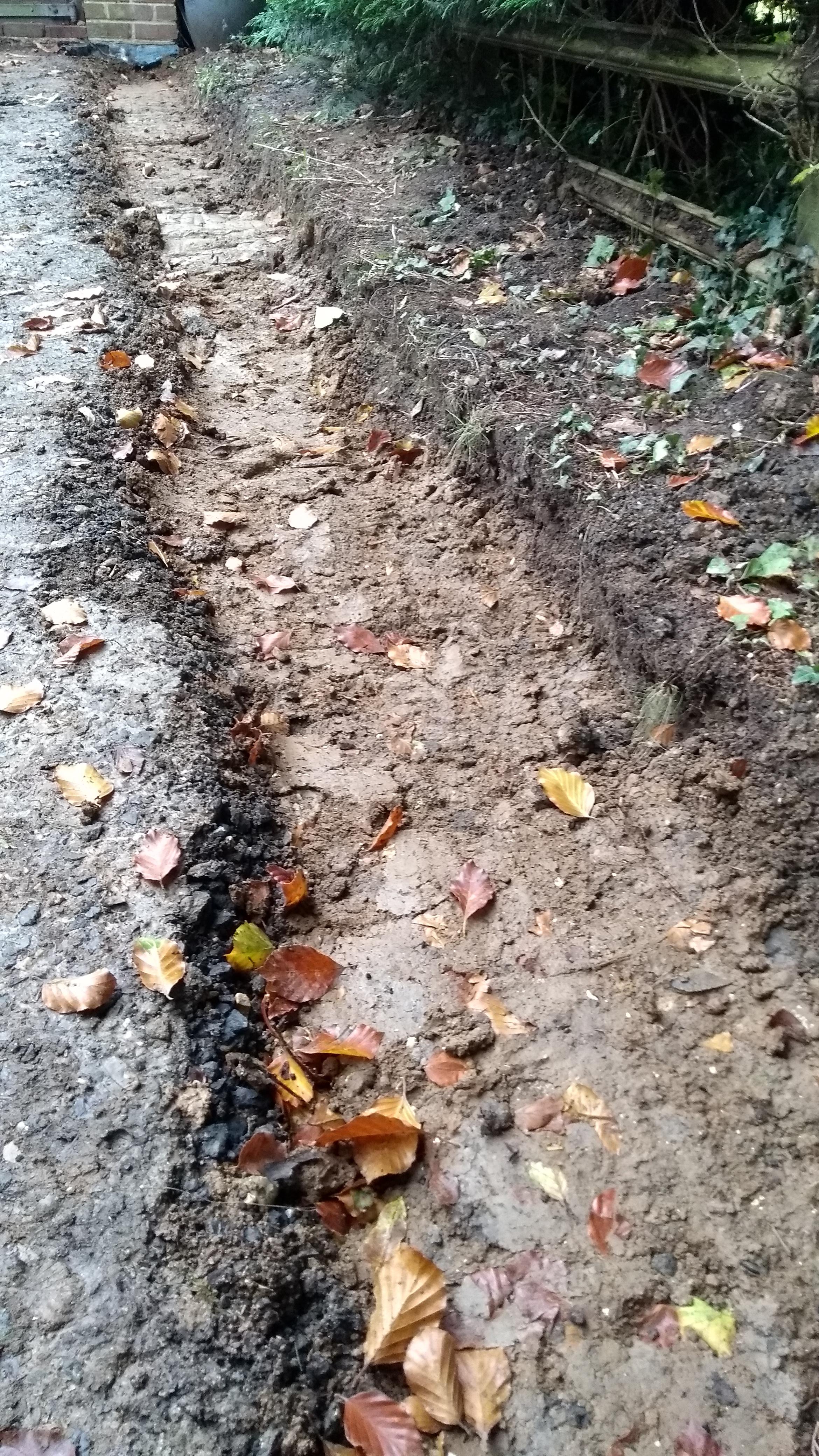

Onoff Posted November 1, 2020 Author Posted November 1, 2020 I've filled in the cable trench I excavated but tbh I think long term I'm just going to churn up the clay if I carry on. (Before there was line of bricks on hardcore). Thinking to fill with something like Type 1 or something "asphalt" based. This is is what's on the rest of the drive but I don't know what it is, any ideas? Looks like it's been tipped and rollered.
Big Jimbo Posted November 1, 2020 Posted November 1, 2020 Looks like it could be road tailings. The tarmac they rip up when they are re doing the road surface. Black gold if you can get hold of it.
Gone West Posted November 1, 2020 Posted November 1, 2020 Road scalpings, what the farmers around here use on their tracks.
joe90 Posted November 1, 2020 Posted November 1, 2020 I used scalpings on my drive and various paths (they were resurfacing the road near me and I paid £50 a lorry load ?) brilliant stuff fir the price (if you can get it!).
Onoff Posted November 1, 2020 Author Posted November 1, 2020 I'll give these people a ring I see they do planings: https://www.sheernessrecycling.co.uk/our-products One of their associated companies is Borough Green Sand Pits just down the road from me.

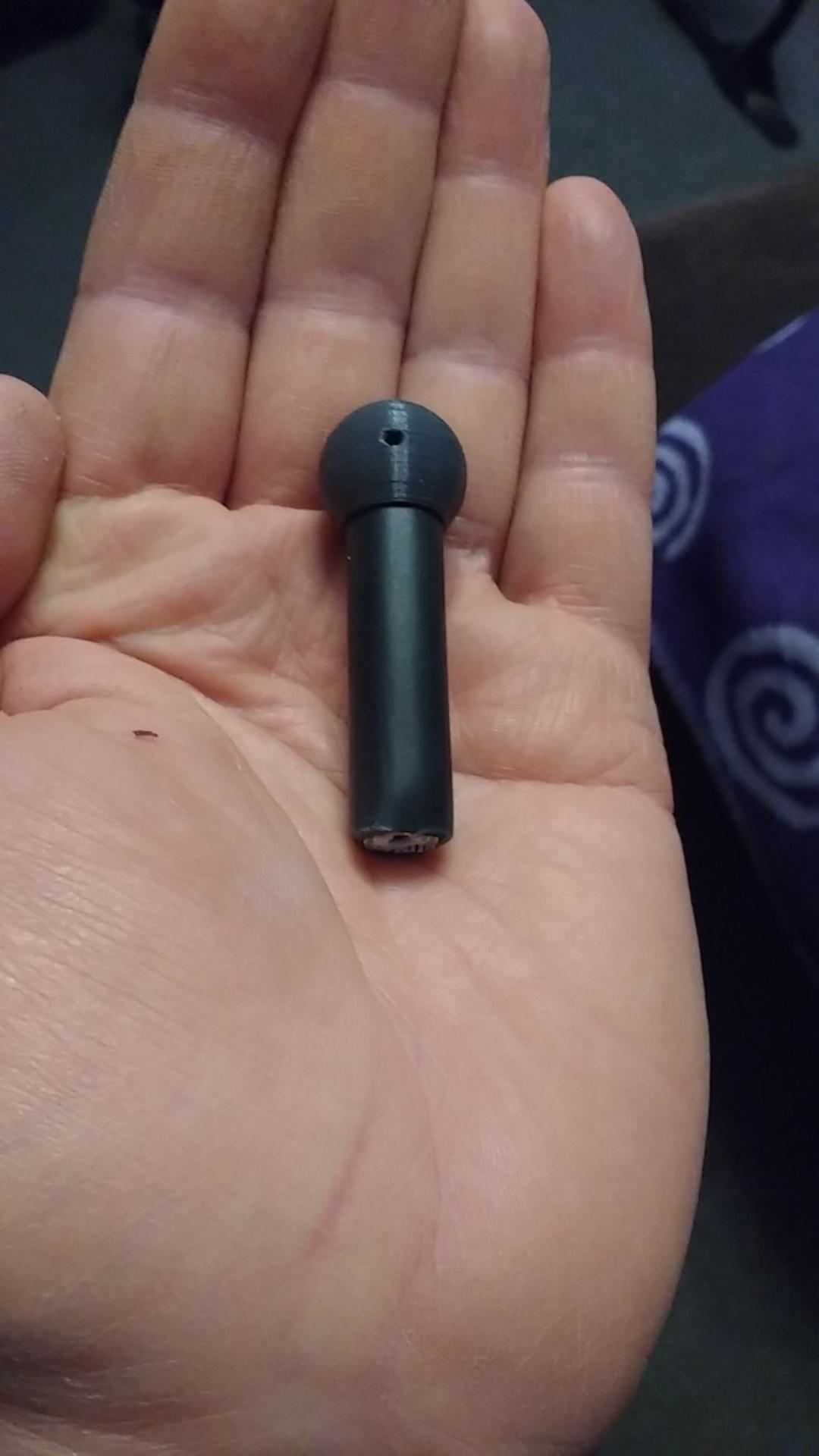

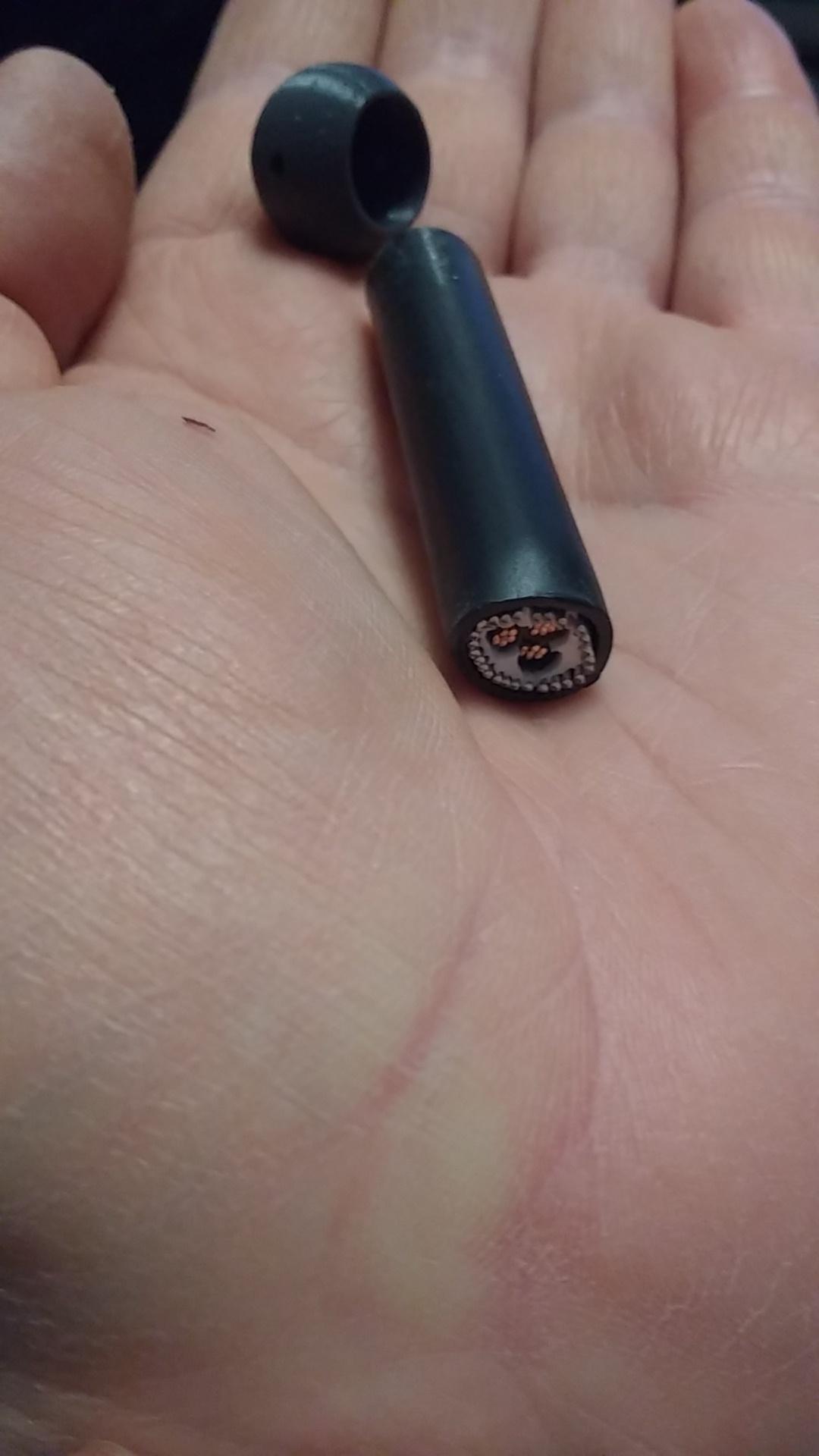

Onoff Posted February 8, 2021 Author Posted February 8, 2021 Got a length of 3-core, 2.5mm SWA down the circa 13m of 60mm smooth bore duct along with some screened, duct grade Cat-5e plus a random, screened 4-core flex for luck. Might drag it all out and put the two small ones in their own 20mm ducts. Pita is the gate end 32mm corrugated I've got going up inside my brick pillars. SWA is just so stiff in this cold. Printed a wee ball to go in the end and act as a guide.
Roys Posted February 9, 2021 Posted February 9, 2021 Keep the coil of SWA in the house next to a radiator for 24hours before you try to use it, cold SWA is horrible to work with warm SWA is a dream. 1
Onoff Posted February 9, 2021 Author Posted February 9, 2021 2 hours ago, Roys said: Keep the coil of SWA in the house next to a radiator for 24hours before you try to use it, cold SWA is horrible to work with warm SWA is a dream. I did! Seen it "snap" on site before...
