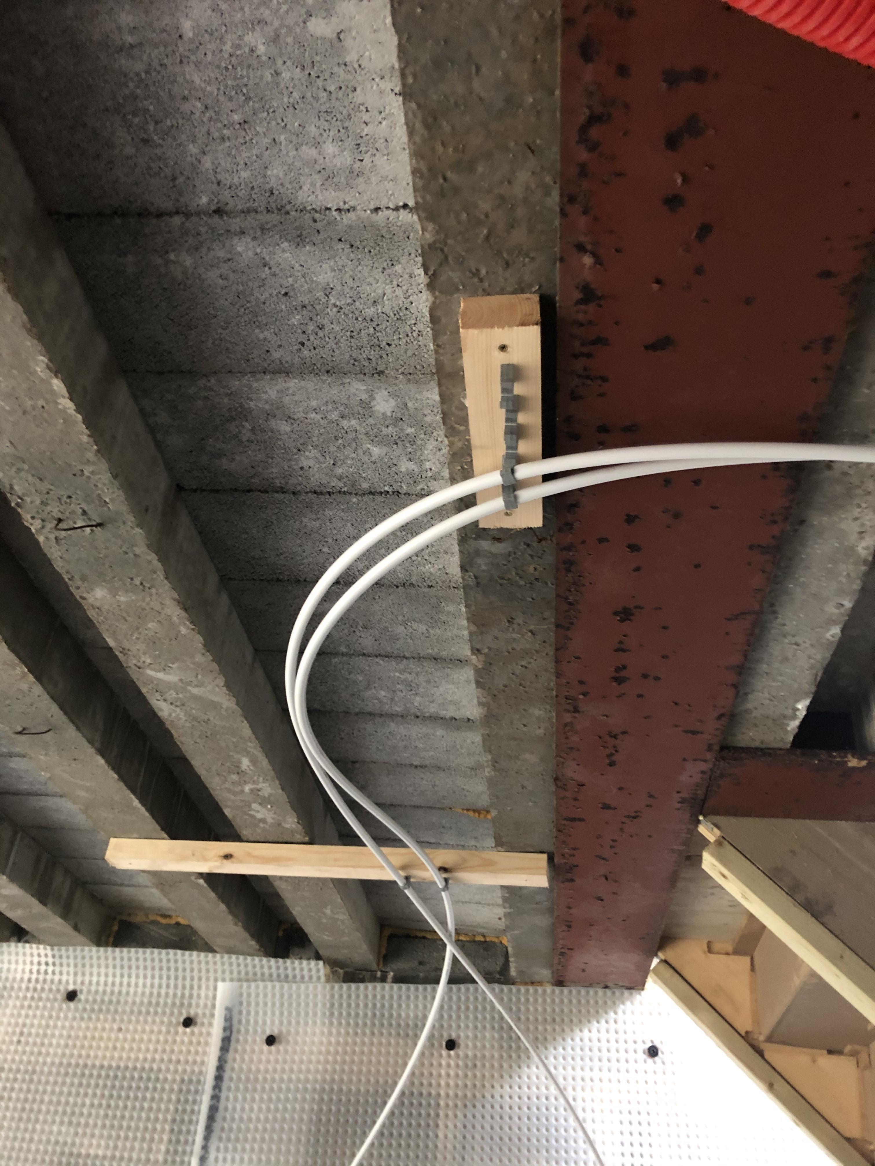

Pocster Posted October 15, 2019 Author Share Posted October 15, 2019 Well it ain’t pretty but timber allows a Hep2o clip per pipe . Going under the render board ‘lines’ the pipe up to run across the ceiling . Not sure how good this will be really . Need to run a ‘ real’ pipe and see ... Link to comment Share on other sites More sharing options...

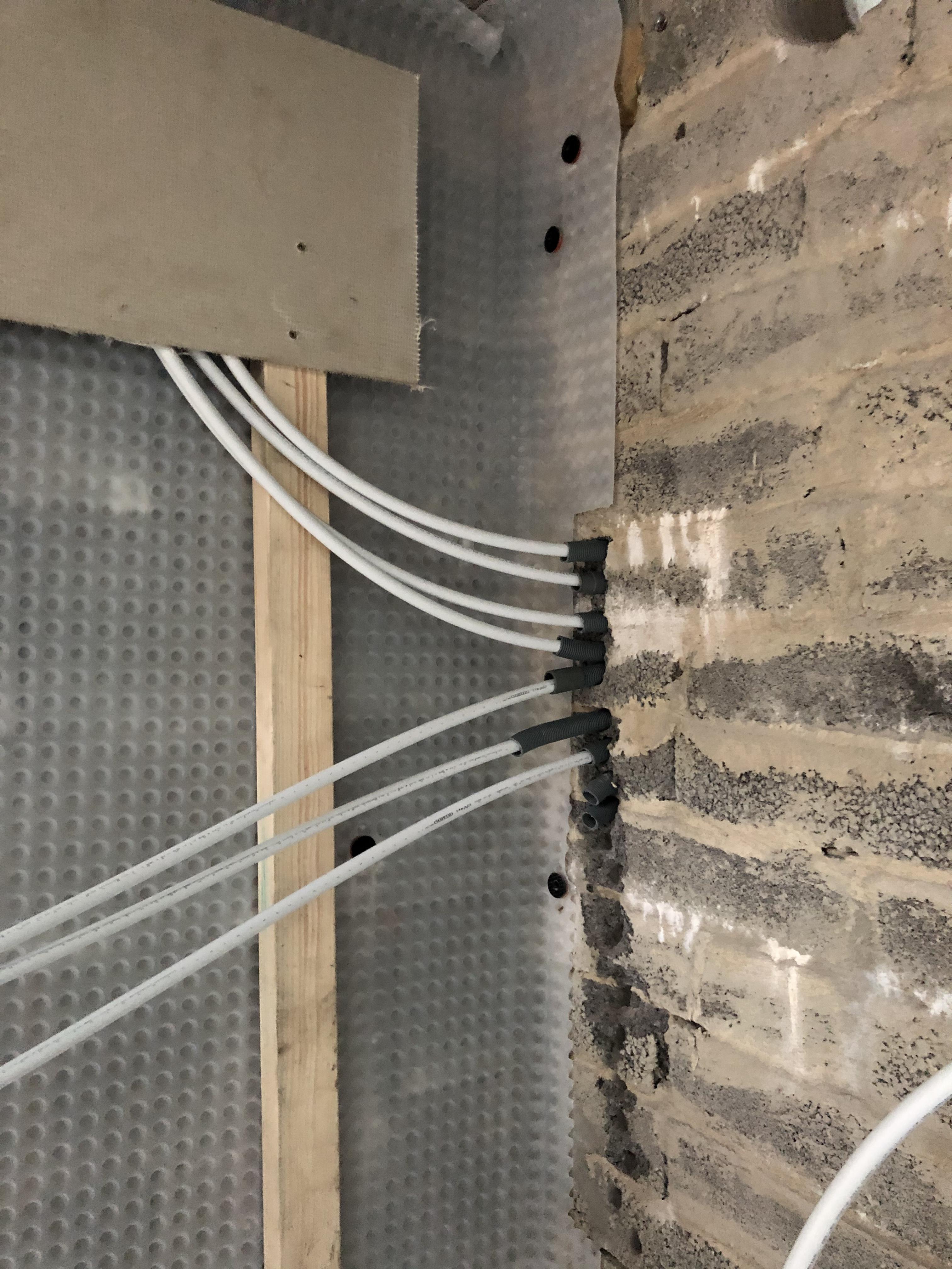

Pocster Posted October 22, 2019 Author Share Posted October 22, 2019 I can confirm that washing machine waste pipe fits lovely in a 25mm hole . 15mm Hep2o glides through ! Was it @Barney12 or @joe90 I need to thank for this tip ? 1 Link to comment Share on other sites More sharing options...

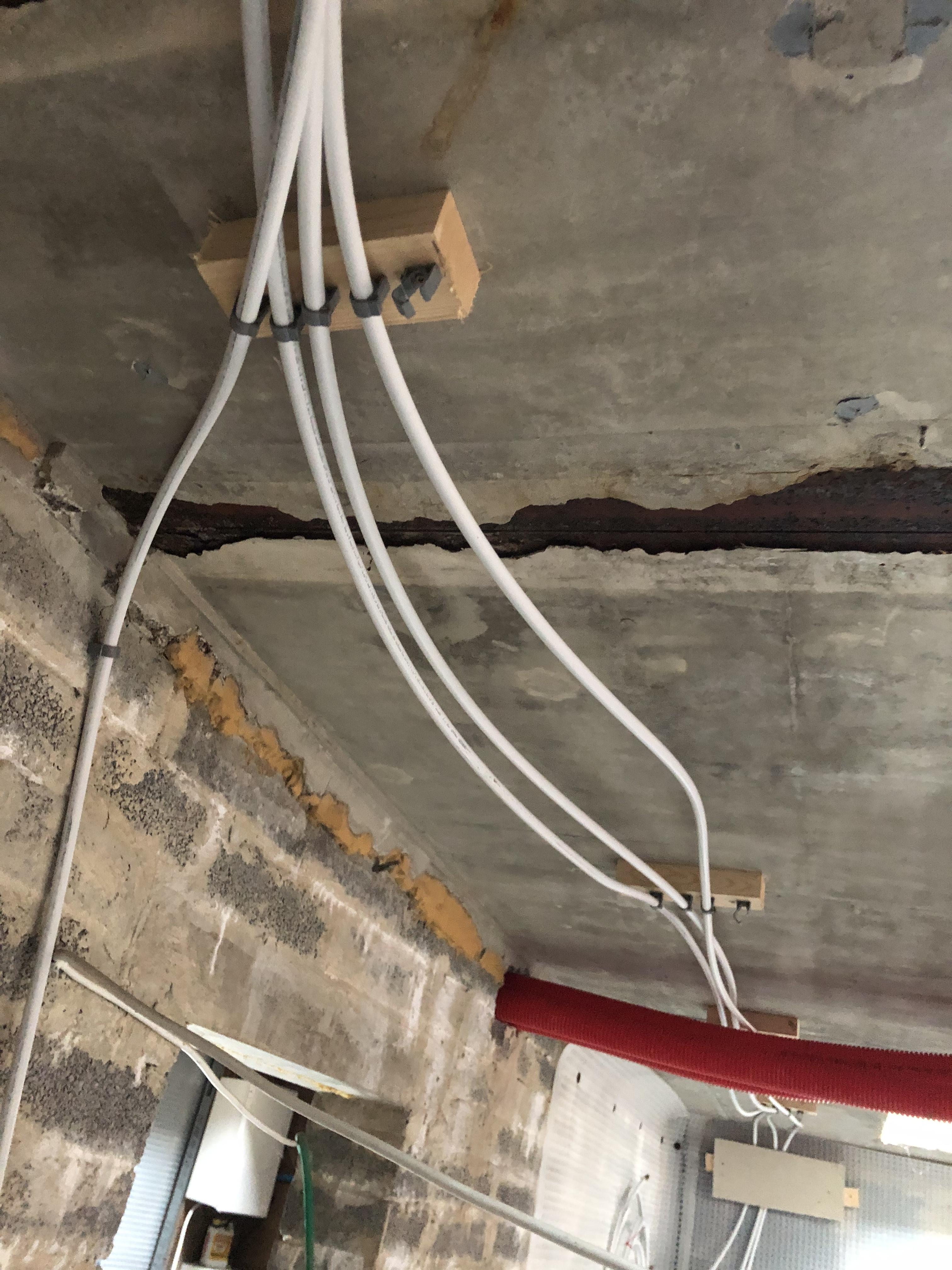

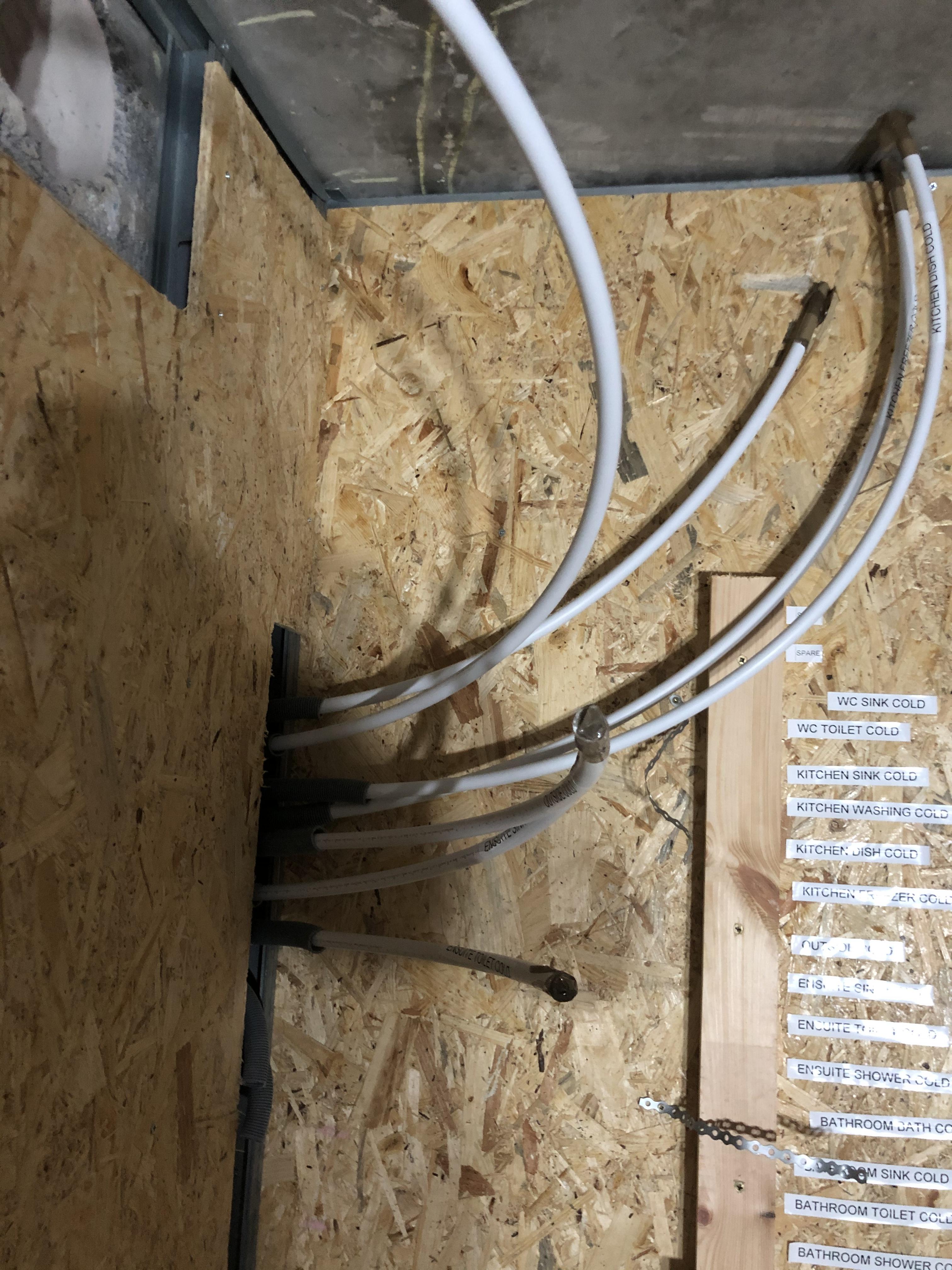

Pocster Posted October 25, 2019 Author Share Posted October 25, 2019 (edited) So I started putting the Hep2o in . Do they need more supports ? . They aren’t going to fall out the clips . But once pressurised will they jump / move as taps go on and off ?? I want some slack as they approach the manifold so I can demount it with relative ease if need be . Edited October 25, 2019 by pocster Link to comment Share on other sites More sharing options...
PeterW Posted October 25, 2019 Share Posted October 25, 2019 Clips every metre.... 2 Link to comment Share on other sites More sharing options...
Pocster Posted October 25, 2019 Author Share Posted October 25, 2019 37 minutes ago, PeterW said: Clips every metre.... Ok . Will add more ! It’s hard work drilling the lintels to get the timber fixed . Link to comment Share on other sites More sharing options...
PeterW Posted October 25, 2019 Share Posted October 25, 2019 One screw and glue them on. CT1 would bond it too, or Stixall. 1 Link to comment Share on other sites More sharing options...

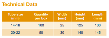

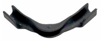

MortarThePoint Posted June 24, 2022 Share Posted June 24, 2022 Has anyone tried using UFH pipe formers with Hep2O? Annoyingly I can't find anywhere that says what the bend radius of these formers is, but they are massively cheaper that the cold bend formers that nobody stocks for Hep2O. I've copied the closest thing I can get to useable data below. I guess the 14-18mm one probably has a bend radius of around 125 - 25/2 = 112mm. Not in spec for the 15mm pipe's minimum bend radius of 120mm. The 20-22mm one is probably around 140 - 30/2 = 125mm but would probably be a bit loose/risky. Link to comment Share on other sites More sharing options...
scottishjohn Posted June 24, 2022 Share Posted June 24, 2022 I maybe be wrong but if you used UFH piping rather than water pipe it has an alluminium core which will make it hold a bend ? no need for formers? or if you want to std water pipe hit it with the hear gun at the corners bend it round a half moonformer made from wood and it will stay bent when it cools Link to comment Share on other sites More sharing options...
MortarThePoint Posted June 24, 2022 Share Posted June 24, 2022 22 minutes ago, scottishjohn said: I maybe be wrong but if you used UFH piping rather than water pipe it has an alluminium core which will make it hold a bend ? no need for formers? or if you want to std water pipe hit it with the hear gun at the corners bend it round a half moonformer made from wood and it will stay bent when it cools I wondered about using UFH pipe for mains water but: am not sure its WRAS (think some of Wunda's old stuff may have been) 16mm so wouldn't fit the fittings probably a nuisance to 'cable' Is heating the pipe and forming it sanctioned by the manufacturer? Link to comment Share on other sites More sharing options...
