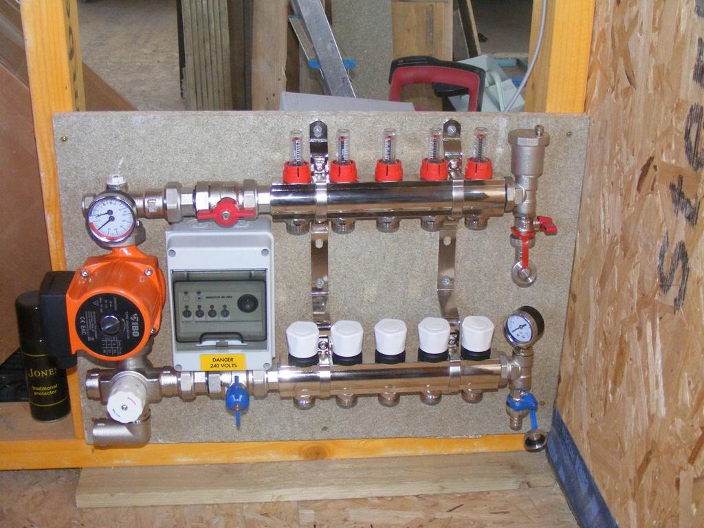

PeterW Posted October 7, 2019 Posted October 7, 2019 19 minutes ago, ProDave said: Ah, so this will only work on some manifolds. Here is mine (before being piped and wired) The blending valve does not have a removable head, so I could not replace it with the Salus unit. You would replace the 5 white heads at the bottom with the Salus heads - that would control the delta T by flow rate and you just open the flow valves up to full.
dpmiller Posted October 7, 2019 Posted October 7, 2019 but regardless of differental across each loop surely you're still at the whim of the TMV to set the flow supply temp. I've specced two manifolds for ours- one for towel rails and rads with a Reliance mixer like @ProDave has, bit the UFH looms utilise one with a capillary sensed blender (and bypass circuit) like @JSHarris shows. It's got a low temp head on too, many capillary heads don't go down low enough for UFH purposes.
Jeremy Harris Posted October 7, 2019 Posted October 7, 2019 57 minutes ago, dpmiller said: but regardless of differental across each loop surely you're still at the whim of the TMV to set the flow supply temp. I've specced two manifolds for ours- one for towel rails and rads with a Reliance mixer like @ProDave has, bit the UFH looms utilise one with a capillary sensed blender (and bypass circuit) like @JSHarris shows. It's got a low temp head on too, many capillary heads don't go down low enough for UFH purposes. Yes, but that is no longer critical in determining how the system responds, as the Salus actuators do all the fine control. The incoming flow temperature can therefore vary over a wider range without having much impact on response. Prior to fitting these actuators our system would sometimes behave itself, with the flow running at around the 25° to 26°C that it was set too, but sometimes it would jump up to 30°C or more, due to variations around the set temperature within the thermostatic valve. Now it doesn't really matter if the thermostatic valve doesn't run down at around the 25° to 26°C point needed for accurate control, as the system works just fine with that set to ~30°C and the Salus actuators making the fine adjustments. I can't see why this wouldn't work with any sort of mixer valve, as all that matters is that the flow temperature is in the right ball park. A degree or two flow temperature variation from the thermostatic valve natural variation at low settings no longer seems to have any impact on how the system behaves.

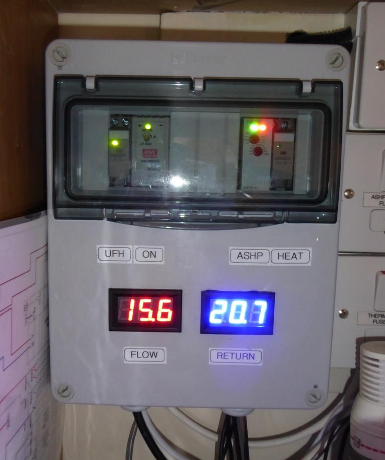

Dan F Posted April 18, 2020 Posted April 18, 2020 7 minutes ago, Jeremy Harris said: The flow remains the flow, but is cool, rather than warm, so in cooling mode, instead of the return being 4 deg C cooler than the flow, it's 4 deg warmer. I was surprised to find that these actuators worked the same in cooling mode, but I guess it's just a function of them not caring which way around the sensors are clipped on. That's pretty neat. Are you monitoring temps yourself somehow, or do these tell you temps? Not questioning your conclusion, just wondering how you know..

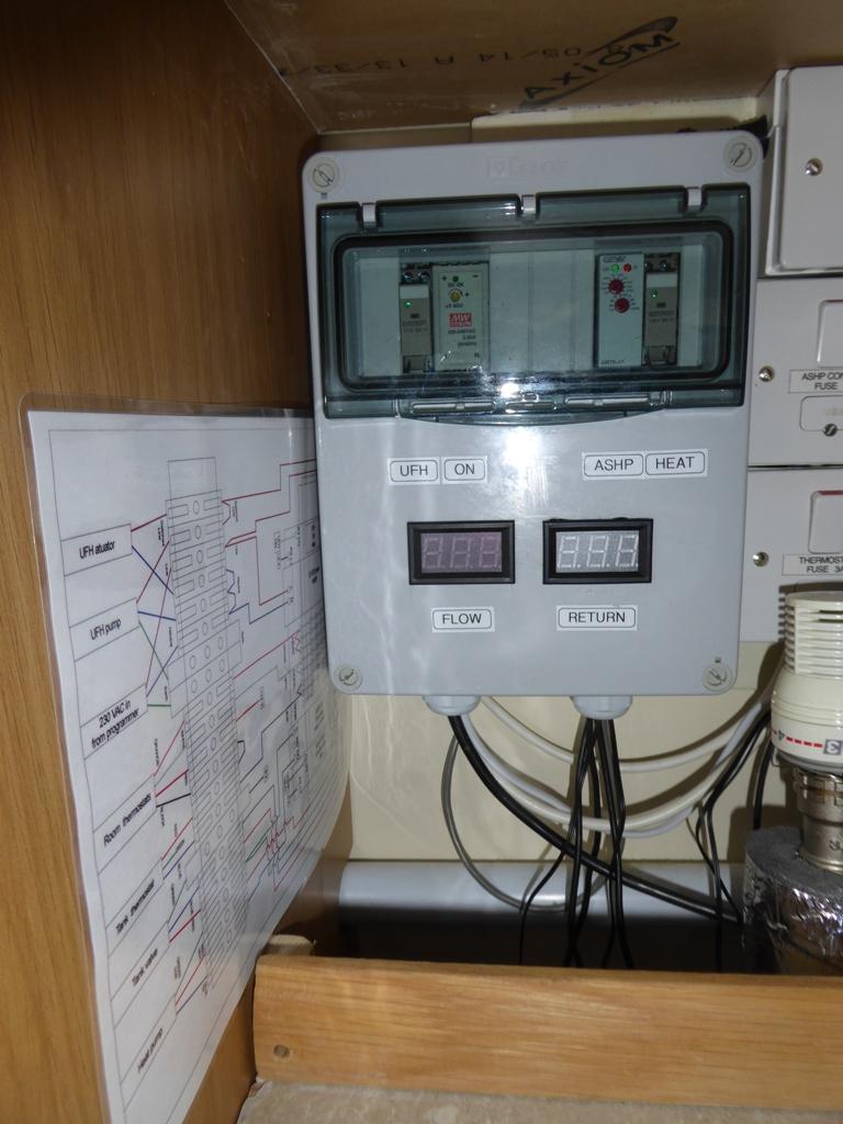

Jeremy Harris Posted April 18, 2020 Posted April 18, 2020 14 minutes ago, Dan Feist said: That's pretty neat. Are you monitoring temps yourself somehow, or do these tell you temps? Not questioning your conclusion, just wondering how you know.. I log the temperatures on the house data logging system, but also have a couple of digital displays on the UFH wiring centre, so can use these to do a quick check:
Jeremy Harris Posted April 19, 2020 Posted April 19, 2020 Just taken a photo with the floor cooling running, which shows the flow temperature cooler than the return: 1
