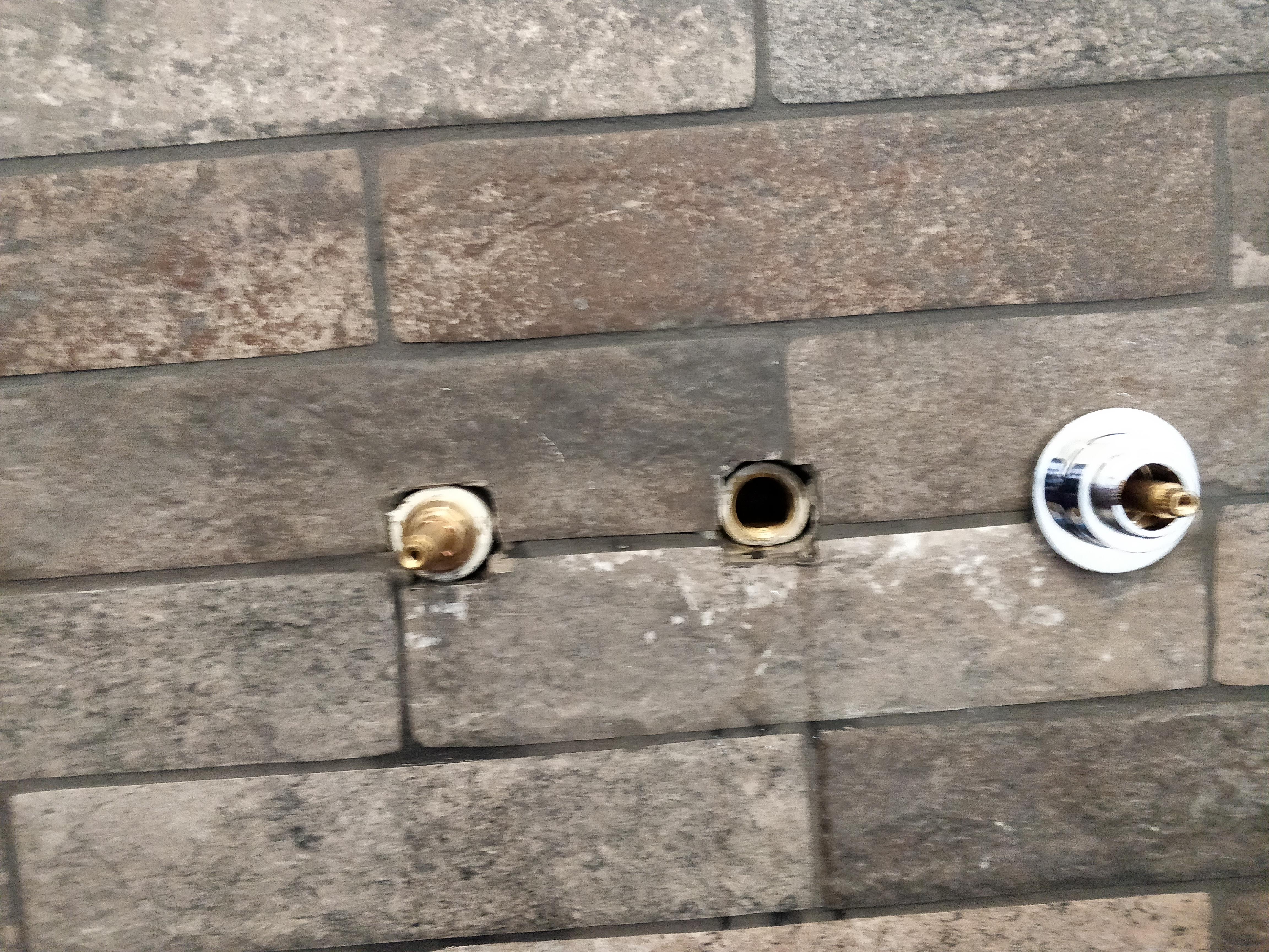

The tiles are too tight to the tap body currently. I can't get the chrome cover to thread at all on the hot tap because the tiles won't let it. The spout can't get in past the tiles far enough to catch a thread.
Tap brassware installed too deep and at an angle it seems.
Plastered over too thick.
Tiler didn't have or ask for tapware just to make sure.
Whatever of all of them I need to get my tap fitted.

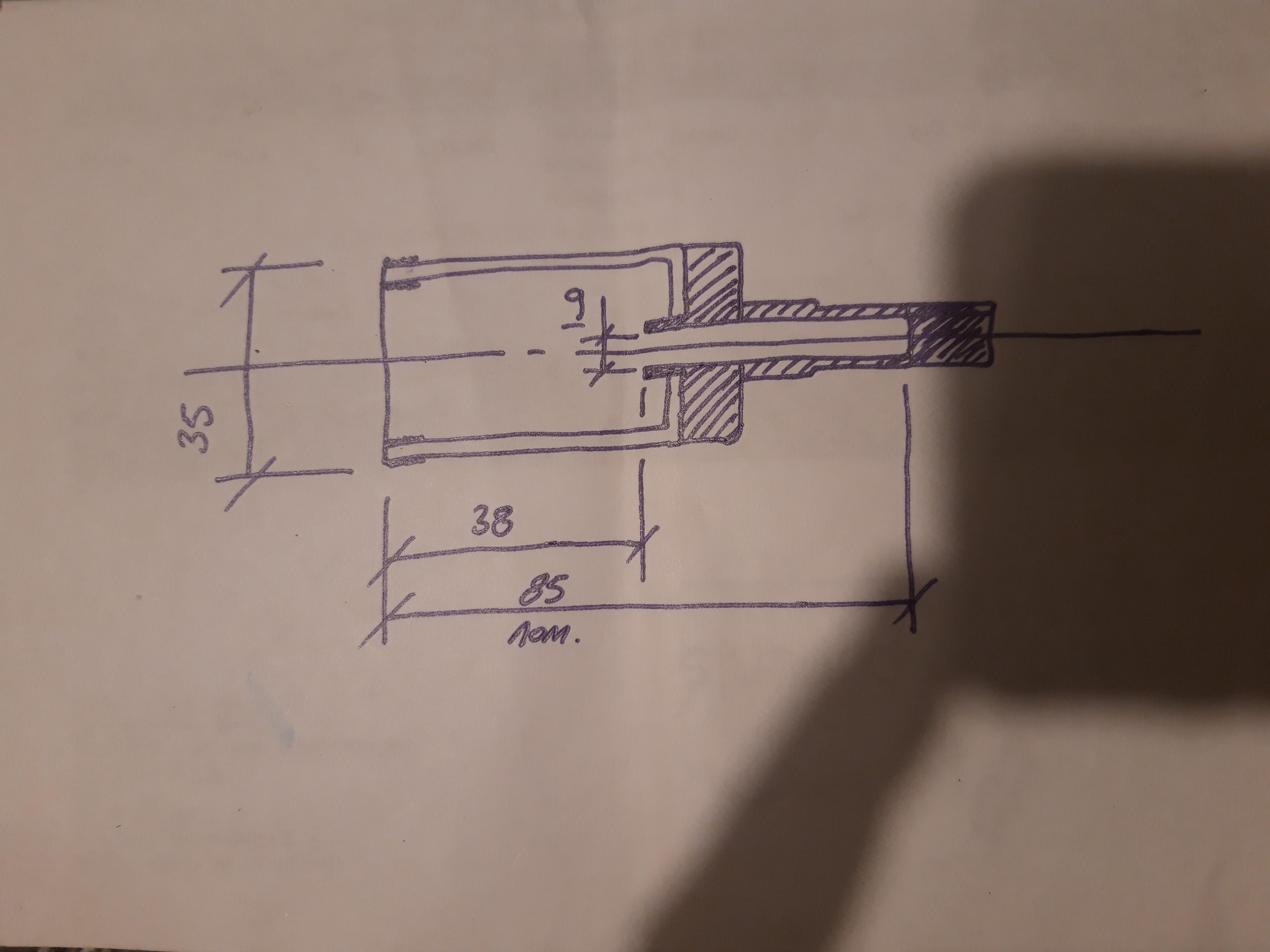

Measure from face of tile to end of spindle and I'll see if it'll work. I can drill right up the centre of the arbour in the lathe if necessary.

If you can measure the spindle dia accurately (think mine was 9mm from memory) and the diameter you need for the screw in bit I could make something up here and post I'm sure. Got loads of spare arbours and would happily give you one of my diamond hole saws just for the challenge of making it / to see the job done right.
Do the cylindrical bits screw on first like this:
20190128_191244
Then a cover plate pushes on? (Horseshoe of silicone, open at the bottom):
20190128_191501
20190128_191607
Cylindrical screw on for the tap and then a round washer shroud to cover it up. The spout just screws straight in and also has a round washer shroud.
Spindle length to tile is 44mm, spindle diameter I measured as 10mm but need to do a more accurate measure. 35mm hole cutter will do both holes I believe.

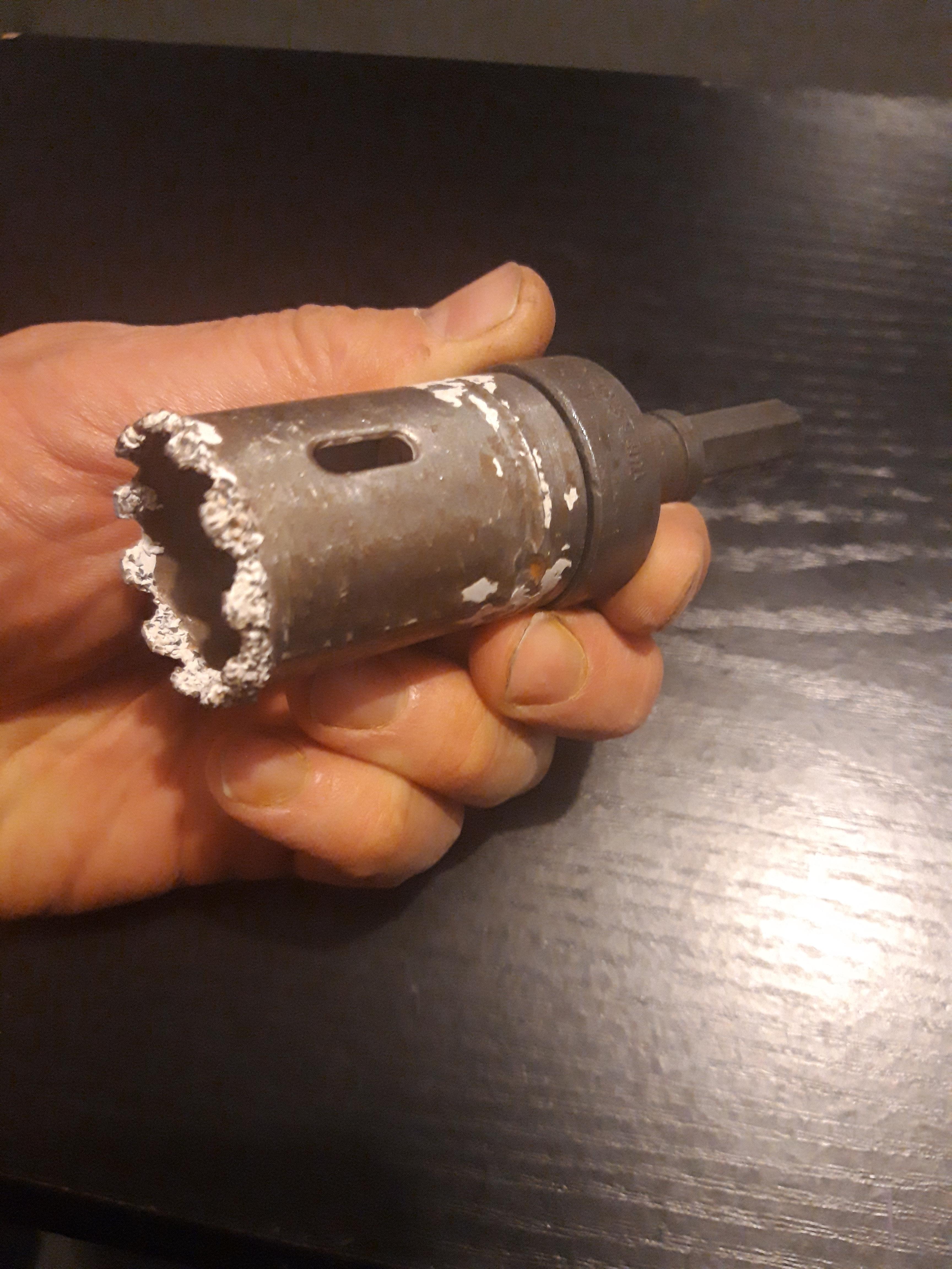

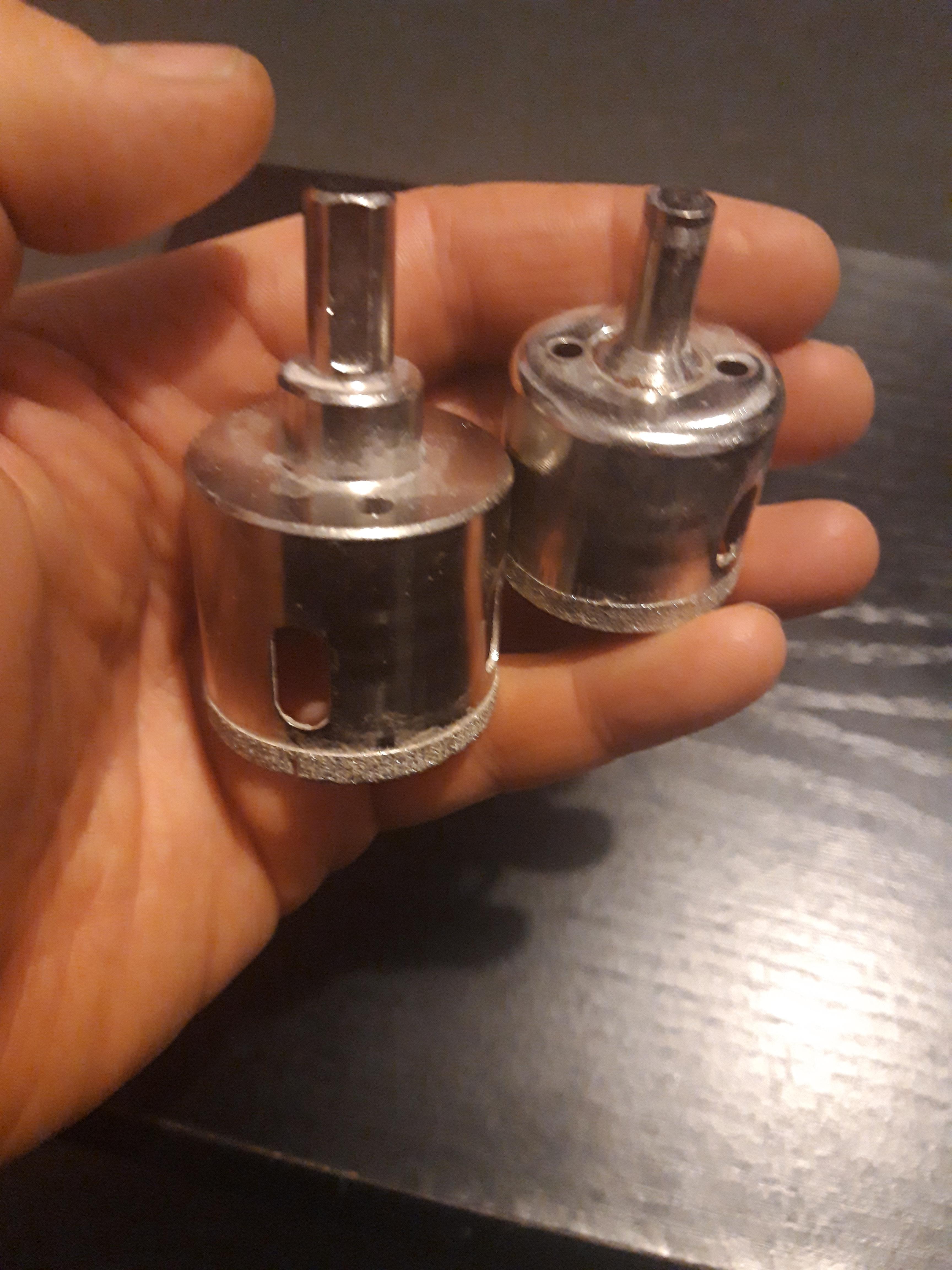

@vfrdave, would a 40mm diamond hole saw be OK? I have 35 and 40 but the 40 is "meatier" hence will I think be easier to drill in the lathe and graft to the Starrett arbour. I'll do them both. The 40 dia is also longer.
Don't get your hopes up btw! ? These things are made of some sort of Chinesium!
Thinking some more...would this do, 35mm dia carbide edged holesaw on a Starrett arbour (drilled to go over the spindle)?
Its one of these:
https://www.toolstation.com/tungsten-carbide-grit-holesaw/p73155

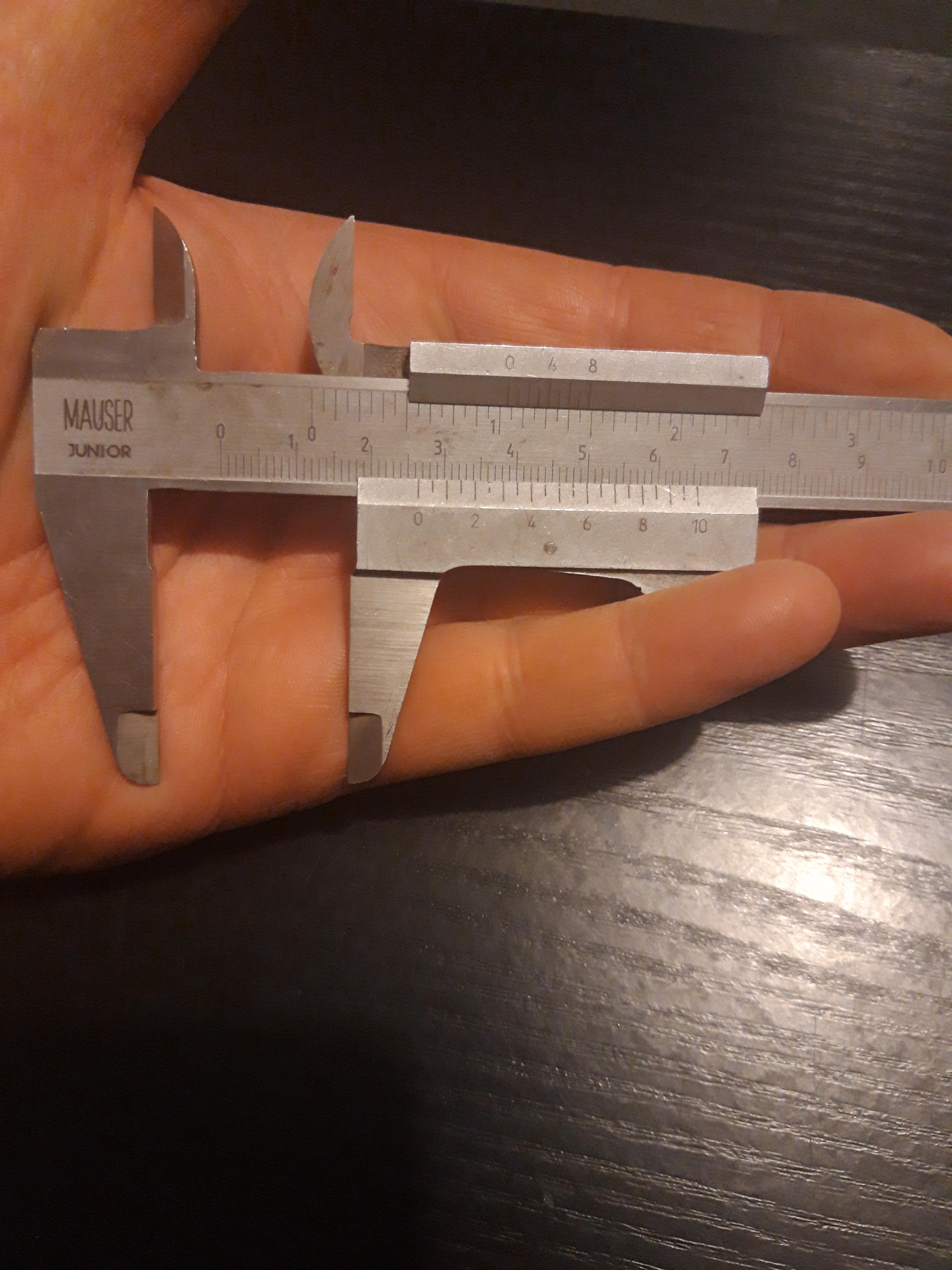

This is the Vernier I use. Stainless steel made by Mauser. It's outlasted all my digital ones:

9 minutes ago, dpmiller said:
...closer to home Dave, I've a carbide crust holesaw in the car, and it's somewhere between 35 and 40m IIRC. I'll check it in the morning...
It's centering it over the spindle that's the issue now that the fittings are in behind the tiles. I can post my drilled one Monday morning if he wants. Mine is drilled 9mm diameter btw about 85mm in from the end of the grit edge.
If you can be more accurate on the spindle size I can drill it bigger before I post.

So I don't have a fancy Vernier to measure the spindle. I have checked it with an adjustable spanner and it seems to land between 9&10mm.
Link to comment
Share on other sites
I'll quite happily drill one arbour at 9.5 and one at 10 to go with the 9 I've already done and post but it seems a bit mad. You can get a cheap vernier for a couple of quid:
https://www.ebay.co.uk/i/153593884476?
Spend a tenner and you'll get a full stainless one. Aldi and Lidl often do them.
