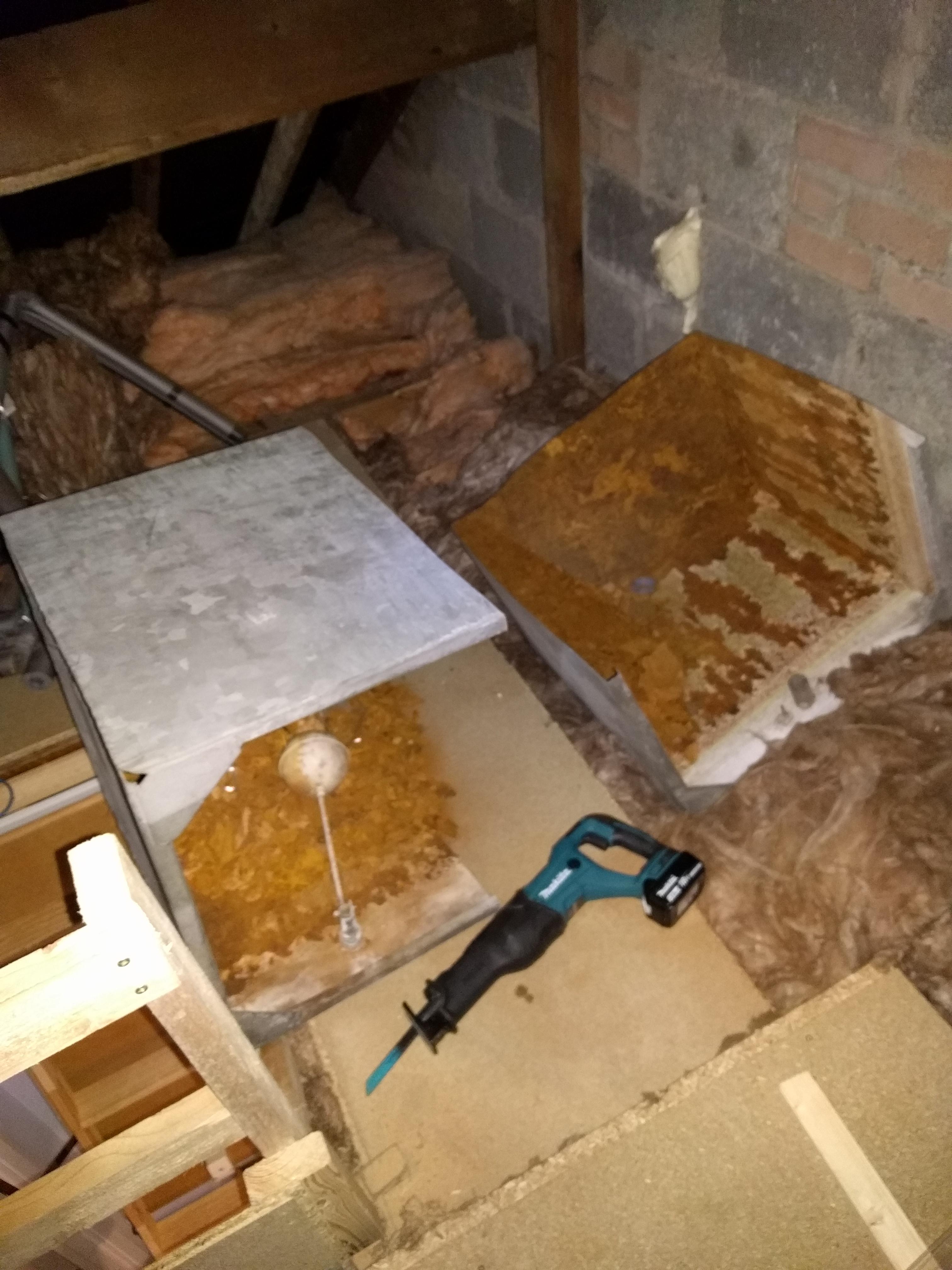

Conor Posted October 2, 2019 Posted October 2, 2019 We've an old galvanized steel header tank in our attic that I need to remove. It's about twice the size of the loft hatch so you can see where this is going... I tried to drag it our from the eaves the other day and it's bloody heavy! The steel it probably 1-1.5mm thick. What is the best way to cut it up? I've a small grinder but I'm doubtful it could do the job, plus it's a small, unventilated space with exposed, rough, dry timbers.... Any ideas? Something like this manage the job? https://www.screwfix.com/p/makita-djr186z-18v-li-ion-lxt-cordless-reciprocating-saw-bare/8334r C.

Carrerahill Posted October 2, 2019 Posted October 2, 2019 (edited) 1 hour ago, Conor said: We've an old galvanized steel header tank in our attic that I need to remove. It's about twice the size of the loft hatch so you can see where this is going... I tried to drag it our from the eaves the other day and it's bloody heavy! The steel it probably 1-1.5mm thick. What is the best way to cut it up? I've a small grinder but I'm doubtful it could do the job, plus it's a small, unventilated space with exposed, rough, dry timbers.... Any ideas? Something like this manage the job? https://www.screwfix.com/p/makita-djr186z-18v-li-ion-lxt-cordless-reciprocating-saw-bare/8334r C. If it was me, I would probably use an angle grinder, however, as you alluded to, if it is in your loft and sparks go flying I would be concerned, I have started many a fire with an angle grinder, nothing serious but a piece of paper or my trouser leg (seriously). I think therefore it would be a good quality metal jigsaw blade or if you get that recip saw a good fresh blade in that - just something that doesn't send sparks flying, for any heavier bits you could use a grinder but use a thin disc (1mm) and control the spray of sparks into the tank if you can. Also, the zinc when heated through cutting etc. will give of zinc fumes which will give you welders flu, you will not generate much heat or flying dust with a jiggy but still, wear a mask, it makes you feel awful for a day or so. Edited October 2, 2019 by Carrerahill

bassanclan Posted October 2, 2019 Posted October 2, 2019 Angle grinder with a ultra thin metal blade, (have a few handy) if you are worried about fire take a damp towel up with you. I've just been cutting 2mm galvanised steel with a cheapo 110mm screwfix grinder and its fine 1

Onoff Posted October 2, 2019 Posted October 2, 2019 Galvanising fumes are horrible and potentially hazardous with any "hot" cut aside from the sparks issue. Recip saw would be my goto, even then with a mask. Less hot swarf of all the processes. Remember having to chop out incorrect bolts on a roof years ago with a recip saw. Only thing we could use because of the rubber roof.

Conor Posted October 9, 2019 Author Posted October 9, 2019 1 hour ago, vfrdave said: @Conor did you get it cut up, don't leave us hanging 56 minutes ago, scottishjohn said: nice to see there are some principled people left in the world where their word is their bond 5min job on Sunday night. Easy peasy. Just need to clean out the rust and debris and lift it down. Luckily only needed to cut it in half to make it small enough to fit through the hatch. But the Makita saw I bought cut through it no bother, would happily cut it again. 1
