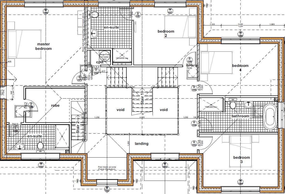

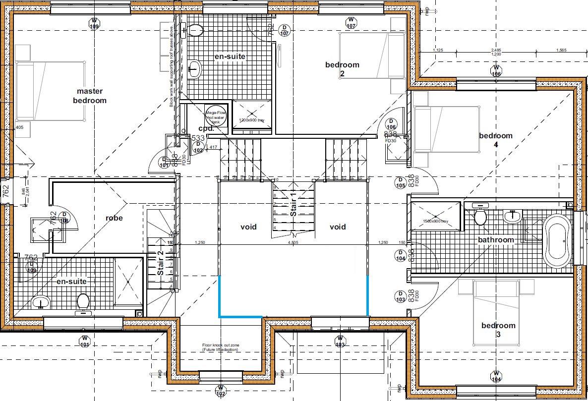

Vijay Posted September 26, 2019 Posted September 26, 2019 Just wondered if you guys can see any reason I couldn't remove one part of my gallery landing. I thought about it a long time ago as I wanted a direct view up from the front door as soon as you walked in, rather than seeing the underside of a walkway. I've attached a pic of how the landing is now and one of how I would like to do it (in blue). "Stairs 2" go up to the rooms in the loft.
Oz07 Posted September 26, 2019 Posted September 26, 2019 Probably easier to do way no.2 anyway. Not sure how it will effect the usability/feng shui?
ProDave Posted September 26, 2019 Posted September 26, 2019 So the only way to get from the master, to the other bedrooms, would be descend half a flight and go back up again?
ToughButterCup Posted September 26, 2019 Posted September 26, 2019 1 hour ago, Vijay said: Just wondered if you guys can see any reason I couldn't remove one part of my gallery landing. [...] No. The effect you talk about - drawing your eye upward - is exactly why we have had our landing designed as you suggest.
Vijay Posted September 26, 2019 Author Posted September 26, 2019 48 minutes ago, ProDave said: So the only way to get from the master, to the other bedrooms, would be descend half a flight and go back up again? Yep 19 minutes ago, AnonymousBosch said: No. The effect you talk about - drawing your eye upward - is exactly why we have had our landing designed as you suggest. Even reducing that part of the landing to 800, you would only see the last 1/4 of the gallery landing ceiling. Glad I've asked and not alone in thinking about it
Lesgrandepotato Posted September 26, 2019 Posted September 26, 2019 Seems reasonable we specified the walk round spaces at a min of 140 to include book cases on the walls. Suggest you consider the same. Then you have a reading nook at the front.
AliG Posted September 26, 2019 Posted September 26, 2019 (edited) Nothing stopping you doing it, probably easier to build. But I wouldn't, people are unlikely to look directly up when they come through the front door, their eyes will be drawn to the stairs and it is double height there. Meanwhile the first floor landing will feel a lot more cramped after the change. Also is there a games room or something in the roof? People in beds 2-4 will have to go down then up the stairs to get there. I also think the little corner in front of the square bay could look awkward. You could reduce the width to 900mm ish if you want a bigger double height space but I would keep the landing. Edited September 26, 2019 by AliG

Vijay Posted September 26, 2019 Author Posted September 26, 2019 I guess this is the difficult thing with self build, you have to imagine it and walk through it it your mind a thousand times. Not sure exactly what the loft rooms are going to be yet, but yes I know it would mean going down and up stairs to cross over and would also mean it would also mean going past the master bedroom door each time which is obviously a downside................................ Even reducing the front part of the landing to 800 doesn't massively reduce the amount you see - I've marked up my hallway in my house today to help me see the sight lines The thought of having walk on glazing at the front had crossed my mind but just not convinced about it. I may just leave out the steel that supports the front and put it in if I decide at a later date...........................

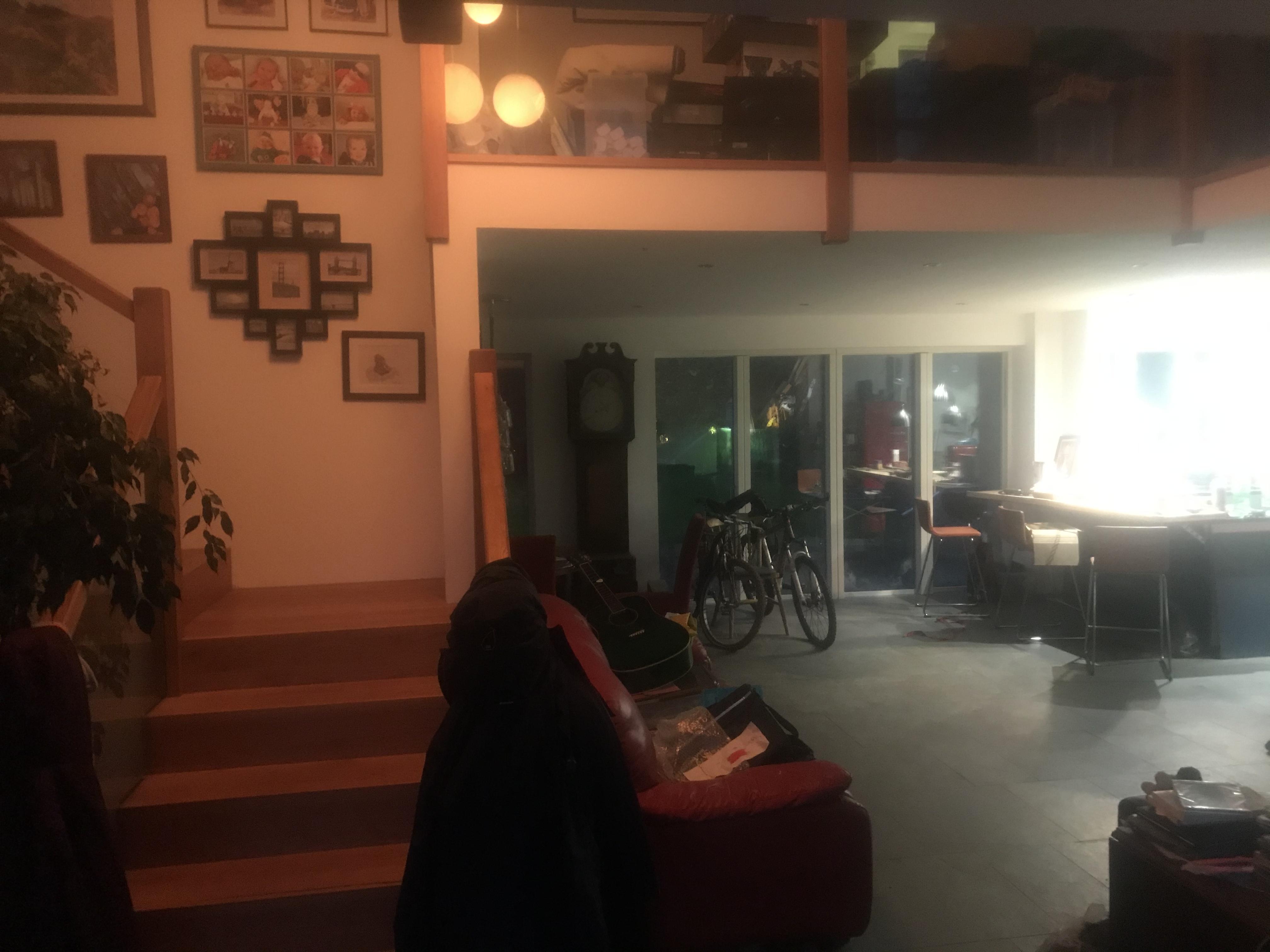

ToughButterCup Posted September 27, 2019 Posted September 27, 2019 15 hours ago, AliG said: [...] But I wouldn't, people are unlikely to look directly up when they come through the front door, their eyes will be drawn to the stairs and it is double height there. [...] Good point. Hadn't thought of that. When people walk in to our place, they automatically look up - because there is a large window for people to look through. Thats the difference
Vijay Posted September 27, 2019 Author Posted September 27, 2019 26 minutes ago, AnonymousBosch said: Good point. Hadn't thought of that. When people walk in to our place, they automatically look up - because there is a large window for people to look through. Thats the difference Do you mean the window is above the door or in front of it? Any pics?

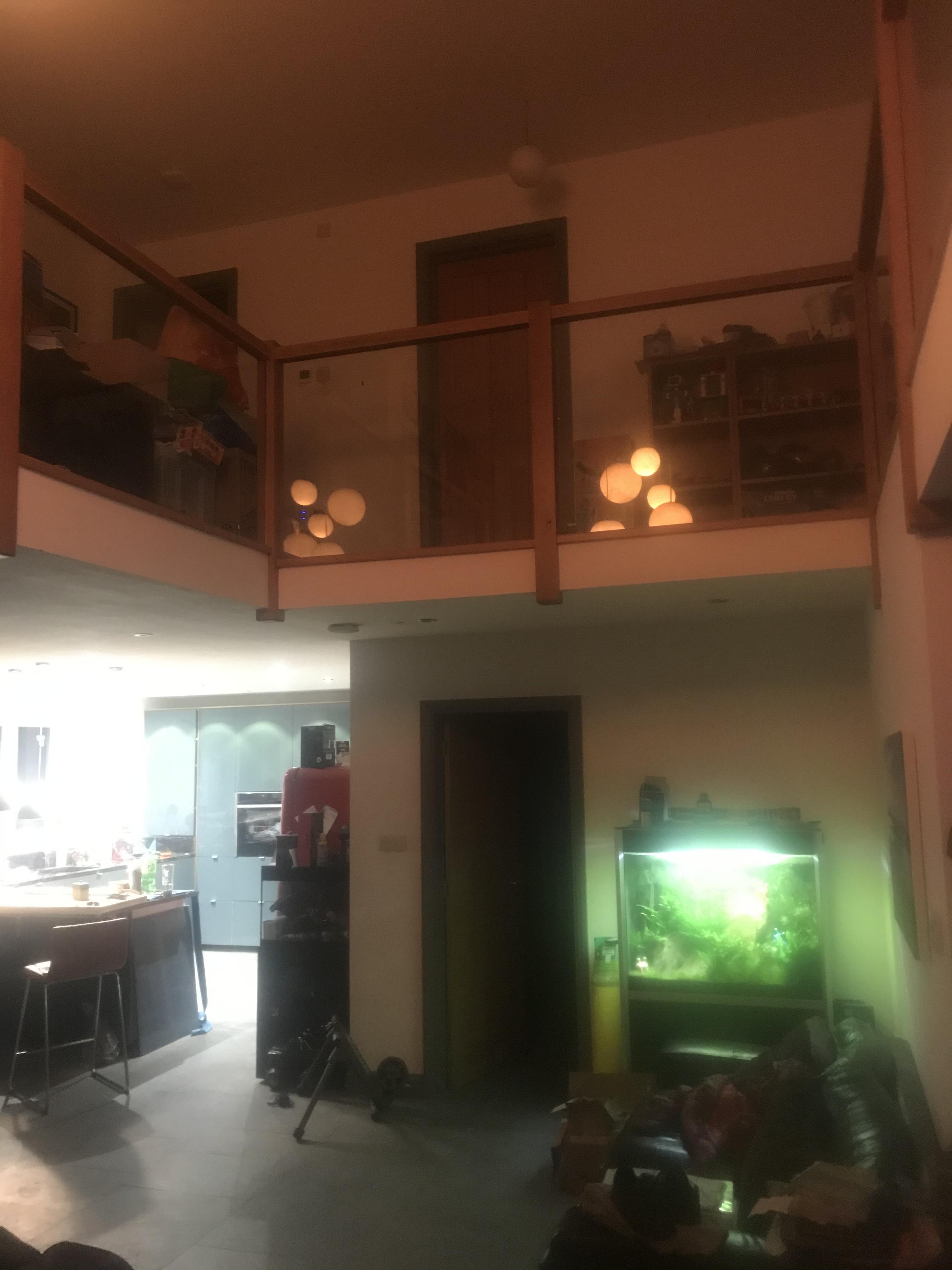

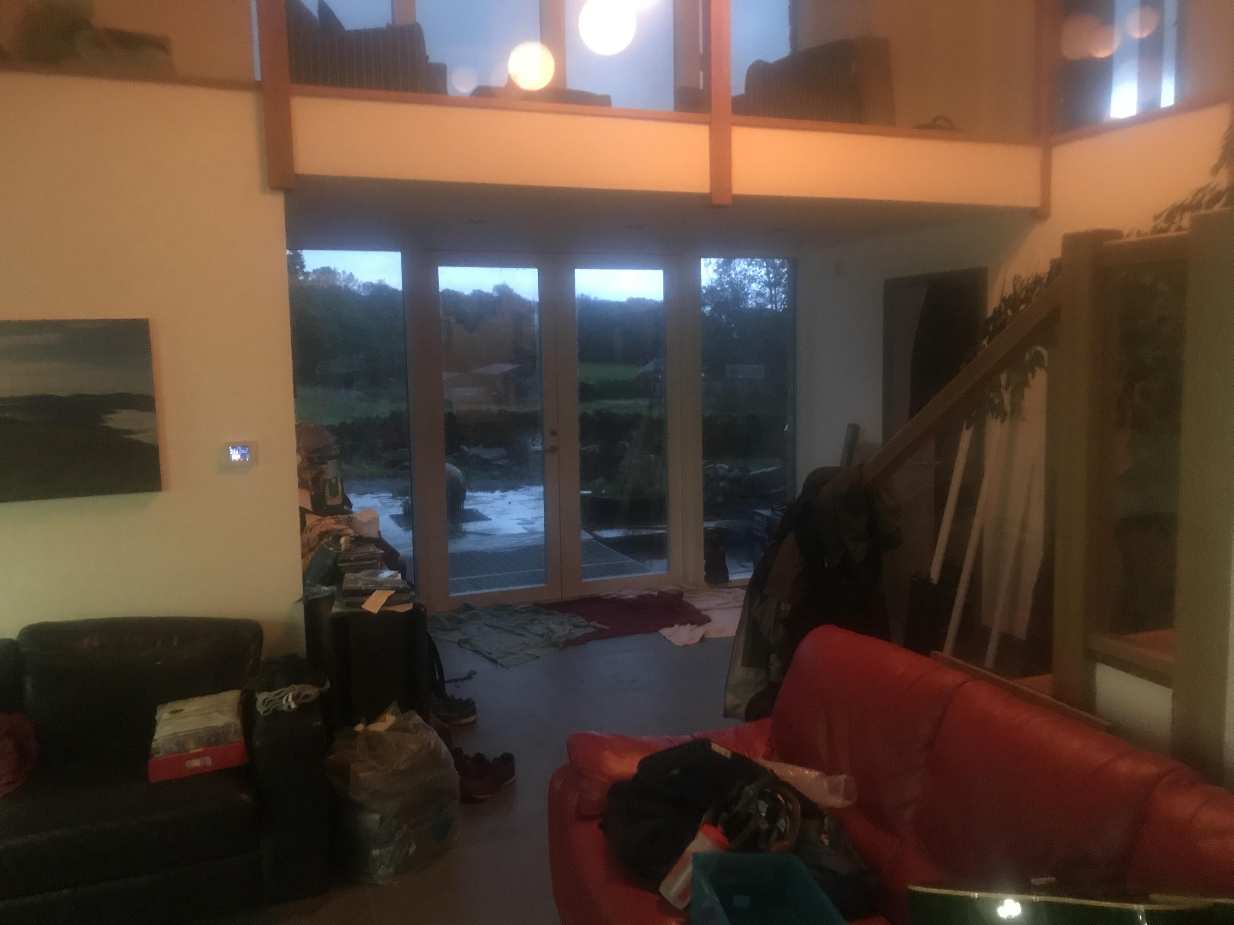

Lesgrandepotato Posted September 27, 2019 Posted September 27, 2019 Apologies for the mess. It’s 2 metres wide coming in with a 6 by 3 void. You sense the space without needing it to be immediately open.
Vijay Posted September 28, 2019 Author Posted September 28, 2019 I like that but does it get that sense of space cos it looks more open planned? If you took a pic as soon as you were at the door, isn't most of the double height ceiling blocked though from the landing above the door?
Lesgrandepotato Posted September 28, 2019 Posted September 28, 2019 It is yes, but you can see from the far side it’s there. You may be right about the effect of the wider space.

Vijay Posted October 10, 2019 Author Posted October 10, 2019 Just wanted to say thanks for helping me see sense. I was looking at it wrongly, take 1 or so steps in from the door and you practically see straight up to the double height ceiling. No one is going to stand at the door and look up, it's natural to walk in The only thing I'm considering (and it probably won't happen) is reducing that part of the land to 800 or 1000mm - but as I said, probably will just keep it at 1250mm to match the rest of the landing
