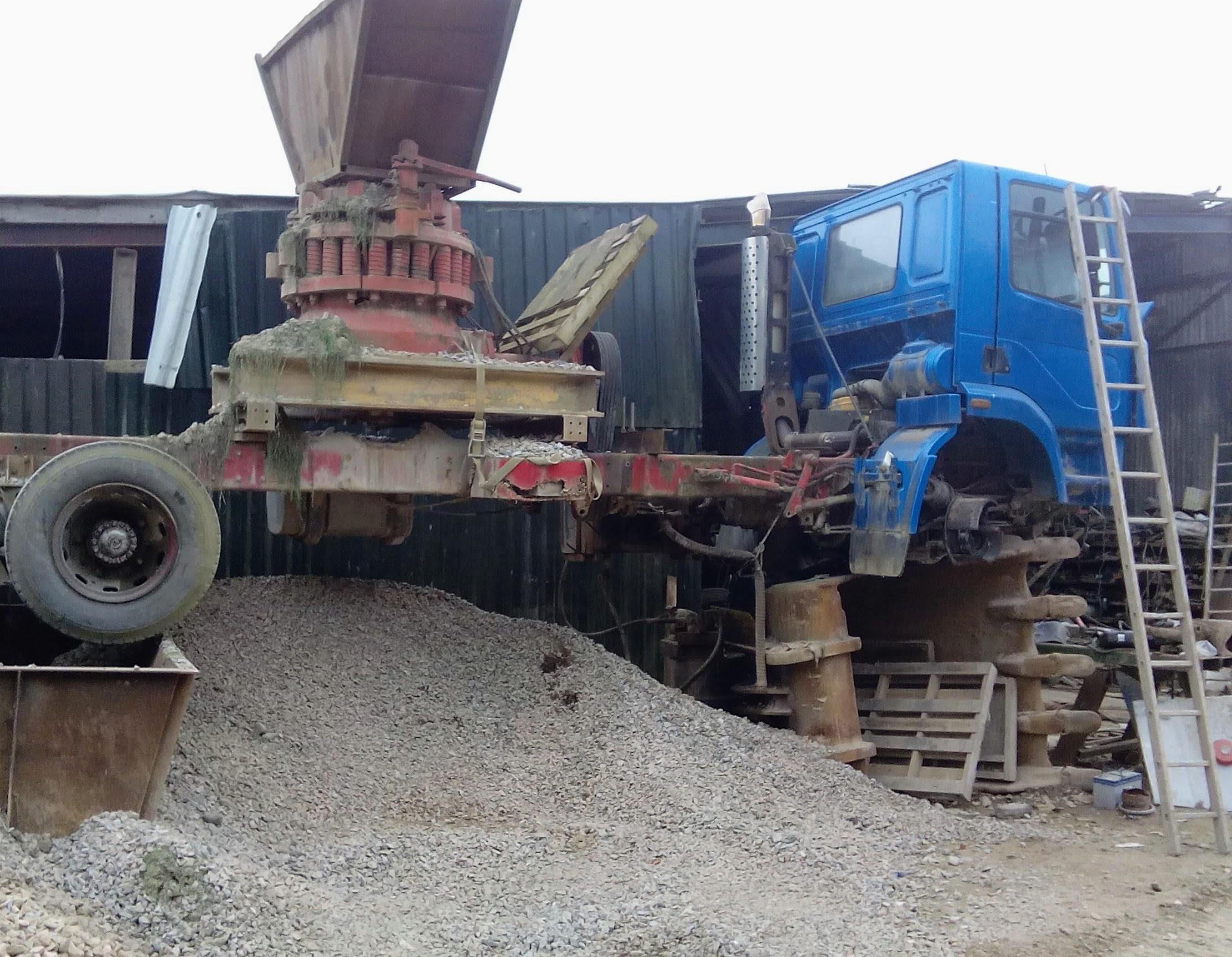

ToughButterCup Posted September 27, 2019 Posted September 27, 2019 2 minutes ago, pocster said: Or just some simple shuttering and a few barrows of concrete ... I'm knackered enough to wince at the word barrow, & now the quack tells me I have an arthritic shoulder : but thanks for the thought. A couple of years ago, I bumped into a local who makes concrete like this .... one of the most interesting guys I have ever talked to: cheerful as a Lottery Winner. Top bloke - for a self builder. I can feel a little visit coming on. If you've driven past Lancaster on the M6, you driven past his 'yard' 50 meters from it in fact. 1
Pocster Posted September 27, 2019 Author Posted September 27, 2019 1 minute ago, AnonymousBosch said: I'm knackered enough to wince at the word barrow, & now the quack tells me I have an arthritic shoulder : but thanks for the thought. A couple of years ago, I bumped into a local who makes concrete like this .... one of the most interesting guys I have ever talked to: cheerful as a Lottery Winner. Top bloke - for a self builder. I can feel a little visit coming on. If you've driven past Lancaster on the M6, you driven past his 'yard' 50 meters from it in fact. Coorrrrr ! Puts @Onoff inventions to shame !
ToughButterCup Posted September 27, 2019 Posted September 27, 2019 1 minute ago, pocster said: Coorrrrr ! Puts @Onoff inventions to shame ! Aaah tell thee lad, aahve sin sum stooof up at 'is place as 'd mek yer ears droop wi' jealousy. Sum on it, well ..... it'd tek thee breath. (tr. kill you) 1
