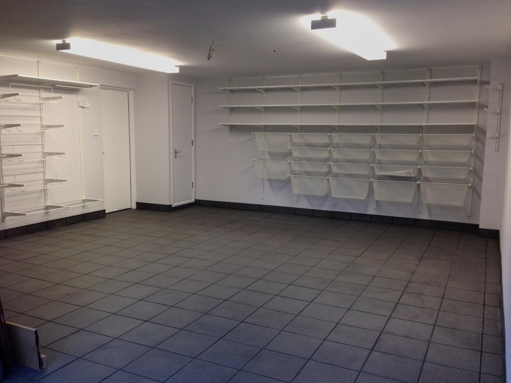

May 23, 201610 yr I have approx. 50 sq m of floor tiling with no skirting, approx. 25-30 linear metres. This is ground floor including a WC and utility but not bathroom type wet environments, although she does like to mop the floors a lot. Sticking stuff to a wall whilst still being supported by the floor seems like something that just might be within my skill set but I have a few questions. 1) These are 600x600 9mm thick, concrete grey, porcelain tiles, am I likely to be able to a good enough cut edge to just cut the tiles into strips to use or should I only use the existing 4 finished edges? 2) I was thinking of using 100mm high. Sound right? 3) I’m going to need a cutter for these and as I have no other tiling to do, hiring may be more cost effective. What is a recommended cutter for large format tiles to get a good edge along the complete length every time? Butts not mitres at corners. 4) What’s the preferred technique? Just butter them and stick them on? Will use a reputable ready mix for this to save me the hassle of mixing on the job. I think I’ll need a 15-20mm depth in some spots so may need to use a bit more adhesive to fully fill the gap and paint the tops. I would use tile spacers under the strips and between them. I would try to match up with the floor grout lines even though that will be more work. 5) Grout or sealant in the gap between floor and upstand? I was going to grout.

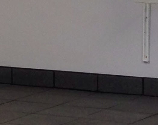

September 7, 201610 yr Author As my bathroom is left needing some plastering (and some Tiling in the future), I being forced to turn my attention back to this. this is an example of what my wife is expecting albeit on a granite floor. She he doesn't want a trim along the top, just the gap filled and a fillet to join to the wall. i am also thinking of getting a electric saw for this now too rather than hire a straight cutter due to likely time on job and the other job of tiling a window cill

September 8, 201610 yr Are you tiling the floor first? Hope so. This was in my mates brand new Persimmon home. 13 bags of self leveller needed over a new liquid screed.....WTF. And the cloakroom. Stick the skirting tiles on with slow set powder tile adhesive. Use a straight edge to keep them as straight as possible, and a boat level to keep them vertical. Put insulation tape on the top edge of the tile as masking, and to stop your filler knife marking the tile, and use a hard filler to put a 90o edge between the tile and the wall. When you come to plaster, you'll then have a slight gap 3-5mm at accept the skim without encroaching on the top edge of the tile. Fwiw, tiled skirting all the way for me. ?
September 8, 201610 yr Author 1 hour ago, Nickfromwales said: Are you tiling the floor first? Hope so. This was in my mates brand new Persimmon home. 13 bags of self leveller needed over a new liquid screed.....WTF. And the cloakroom. Stick the skirting tiles on with slow set powder tile adhesive. Use a straight edge to keep them as straight as possible, and a boat level to keep them vertical. Put insulation tape on the top edge of the tile as masking, and to stop your filler knife marking the tile, and use a hard filler to put a 90o edge between the tile and the wall. When you come to plaster, you'll then have a slight gap 3-5mm at accept the skim without encroaching on the top edge of the tile. Fwiw, tiled skirting all the way for me. ? Er, it's tiled already. The plaster has been skimmed but really needs going back to the brick and redoing but I didn't want to lose space from the already narrow hallway with 2" dot and dab. All the plaster will have to come off at some stage but that stage isn't anytime soon. No point leaving gaps behind the skirt. It's a question of taking them off and trying to clean off the old adhesive to re-stick.
