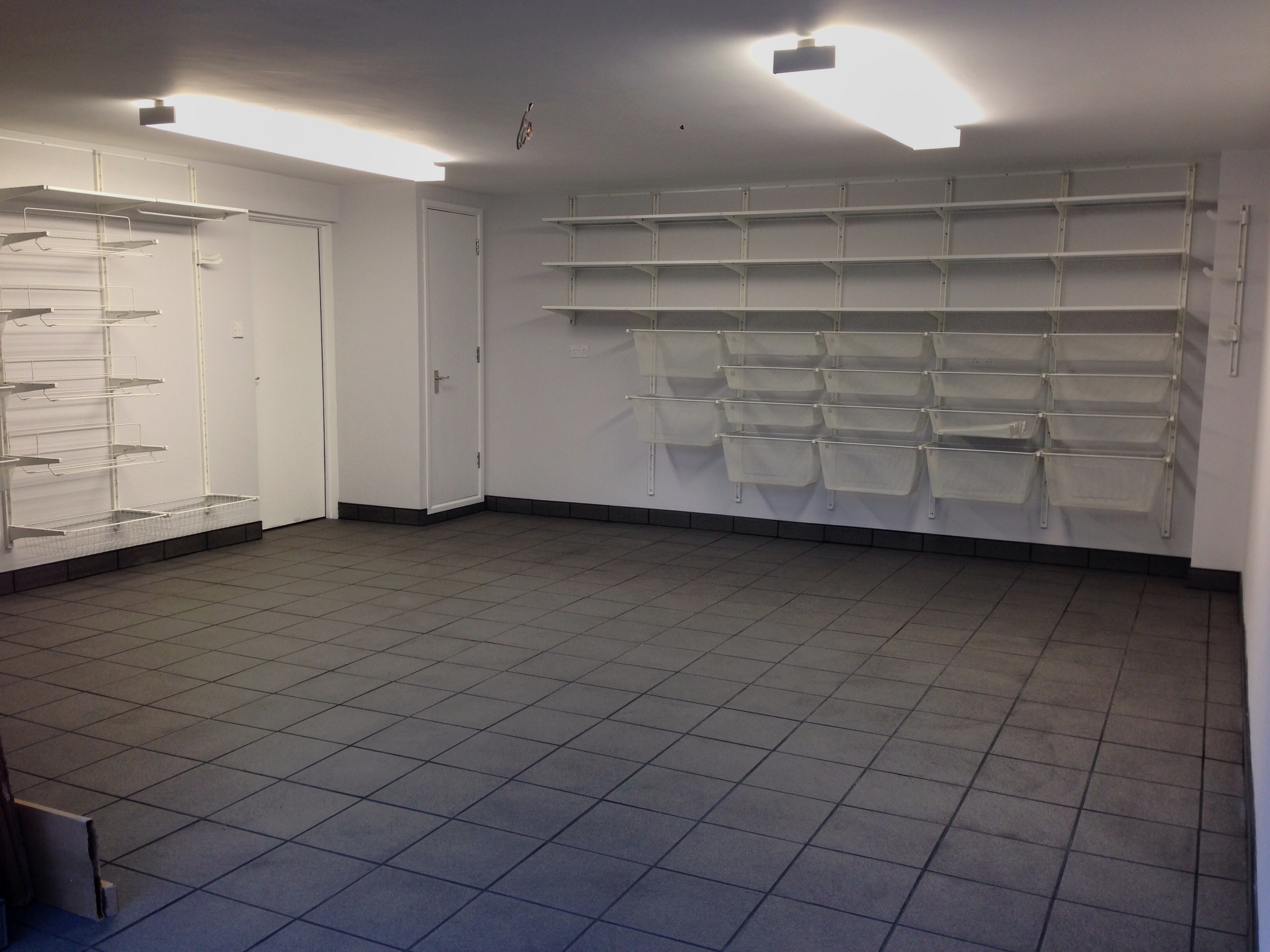

  • I created a tiled skirting in the garage. I don't have a close up pic to hand unfortunately but the second image below is a zoom. It was just a cut tile with a PVC tile trim on top. Looks fine. B
It was just a cut tile with a PVC tile trim on top. Looks fine. But, it is a garage so slightly more industrial!
As an aside screeding, tiling and grouting that floor nearly broke my knees :( The tiles were the "rock" commercial jobbies that they use in car show rooms. To top it all I bought them on line and they delivered on a pallet. delivery truck couldn't make it down the lane so I had to hand ball each pack over 150m. Far too much like hard work :)

That looks grand, Barney.
I wish my garage looked that posh ?

I have been pondering this idea of tiled skirting. The more I am reading here, the more I am thinking that over time the skirting looks tatty as it gets chipped at corners etc and it's annoying to repaint. Tiles might be harder/more expensive day one but more durable.
The guys who did my bathroom used a very long scribe cutter like Nick suggests. We have porcelain stone look tiles and I struggled to tell the cut edges from the factory edges. Not sure it would be the same on polished tiles. I wouldn't want to see an edge trim whether it be metal or plastic on a tiled skirting, I think that would ruin the effect.
