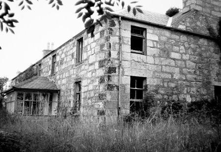

Ok heres a question
cut stone granite house circa 1800+ in scotland
wall 28" thick
outside cut stone wall is pefect --really  it is perfect even trees that have tried to grow out of bottom have not moved anything in 50years of it not having a roof
could you remove the very thick rubble wall behind it - would it stand up
the ides would be to spray inside of this wall with closed cell foam after building a timber frame inside it
foam is to water proof it and bond it to timber frame  and so get modern insulated house but keeping room sizes as they are
I have been told there will be long bits of granite in outer wall to tie it to  the internal  rubble wall
picture is 1975 --no roof now

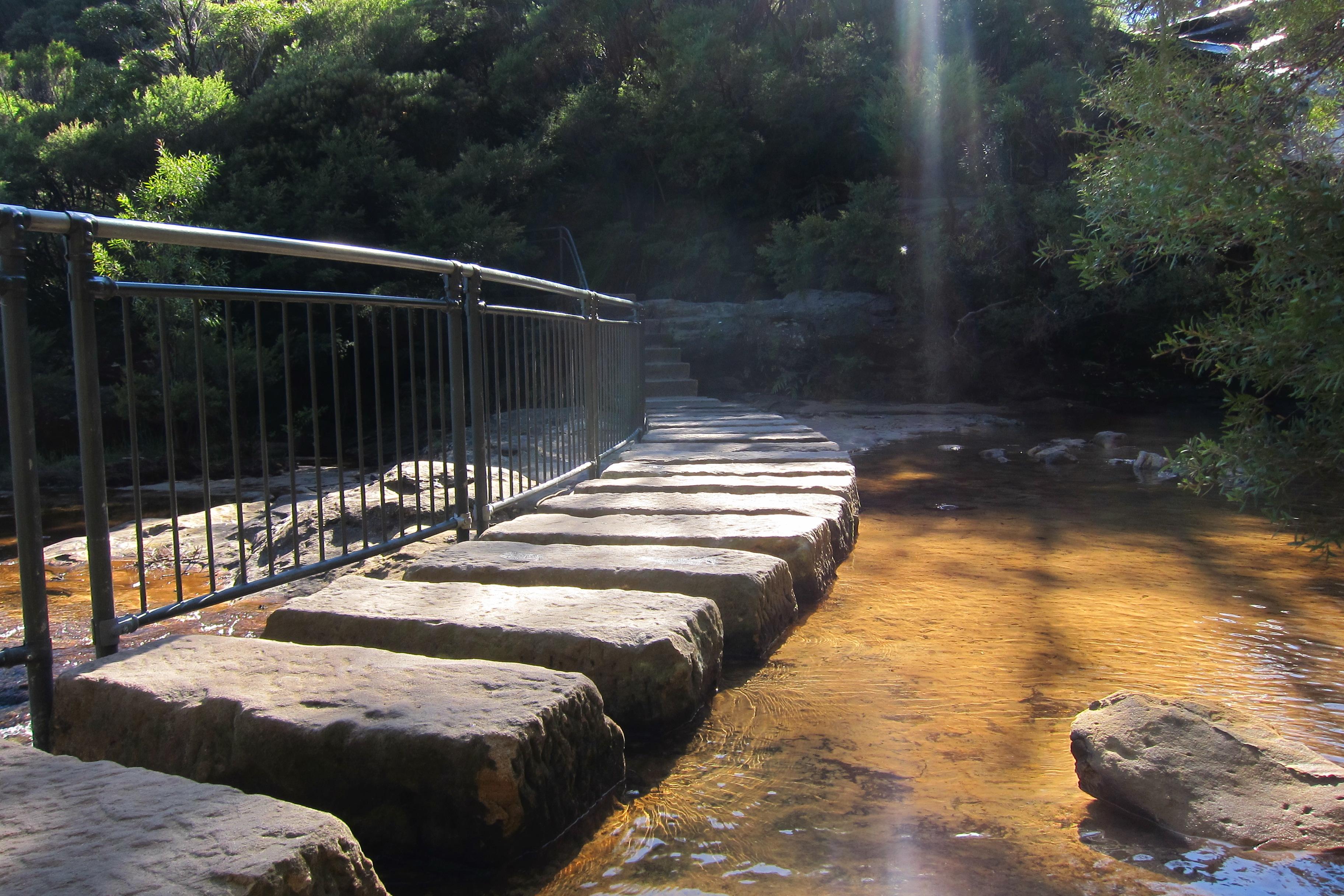

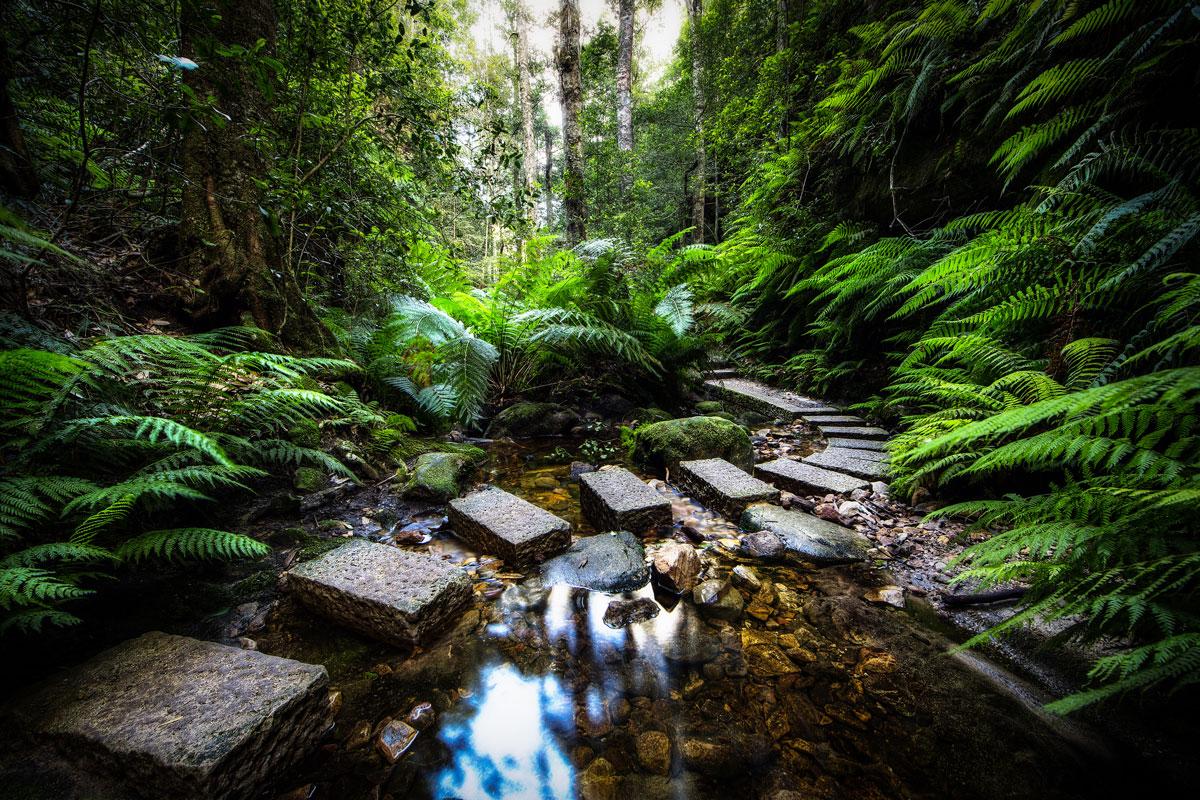

Welcome and greetings from a fellow stonemason, I was also a leading expert in my field of the restoration and re building  of heritage walking tracks in environmentally sensitive areas, 10 years in Scotland and 10 in Australia. It’s a great forum with some seriously knowledgable and more importantly helpful folk and I know your filling a gap in the knowledge base so it’s great to have you on board. Just a few pics of my type of work (tiny sample....) look forward to following your progress.
Edited by Cpd

Hi there, I would have to say that there is a very real chance that there are stones extending from the front, to the rear of the masonry. Subject to any constraints, the removal of a few test areas would confirm this. The economy of labour dictates that whilst there is a need to square off the perpends, and the base and top of the stones, the rear's would probarbly be left quite ruough and of random length made up with rubble to the internal dimensions. In my experienece, the lengths of those stones into the building can be quite varaible and inter-dependant. Also, I would have thought that internally, there may be timberwork being supported, not by the exterior stones, but by the internal rubblework. Is there an issue with damp- insulation? Sorry to be vague, but come back to me. Steve.

Very nice work, I felt an immediate sense of calm just looking at those pictures. Ancient paths and pathways are a wonderful part of our ancient narrative. I think there are a few ancient stone bridges in Cornwall, or pathways, or stones crossing various rivers at various paces. Wonderful stuff, thanks for sharing!

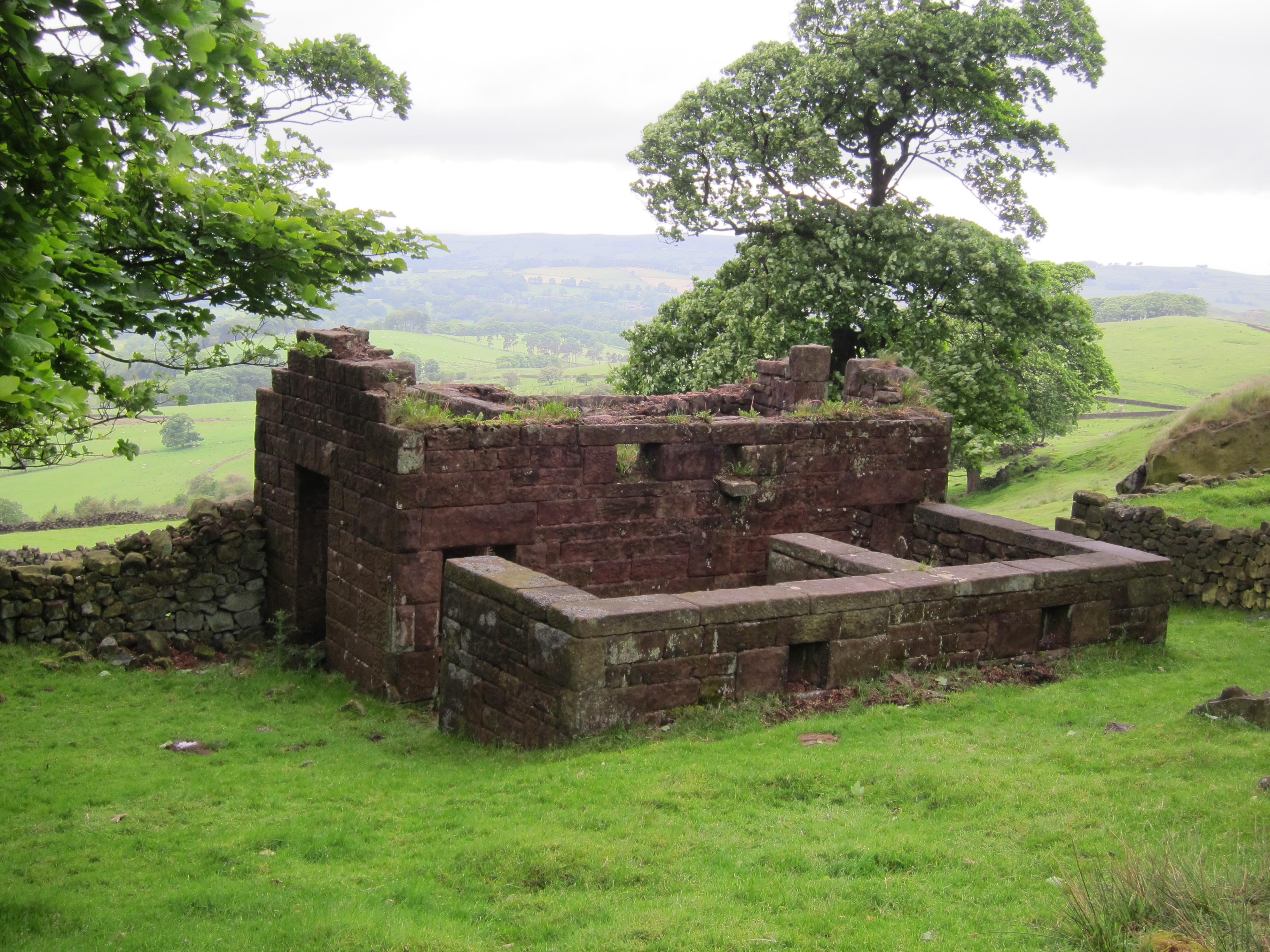

When I was in the Peak District I came across this amazing ruin, this was just the piggery the main house ruins were to the right. It’s not often i fall in love with a place but this really was something very special. No habitable building anywhere nearby, just completely deserted and remote. If I had wanted to live in this area I would have moved heaven and earth to see if it was possible to get it !

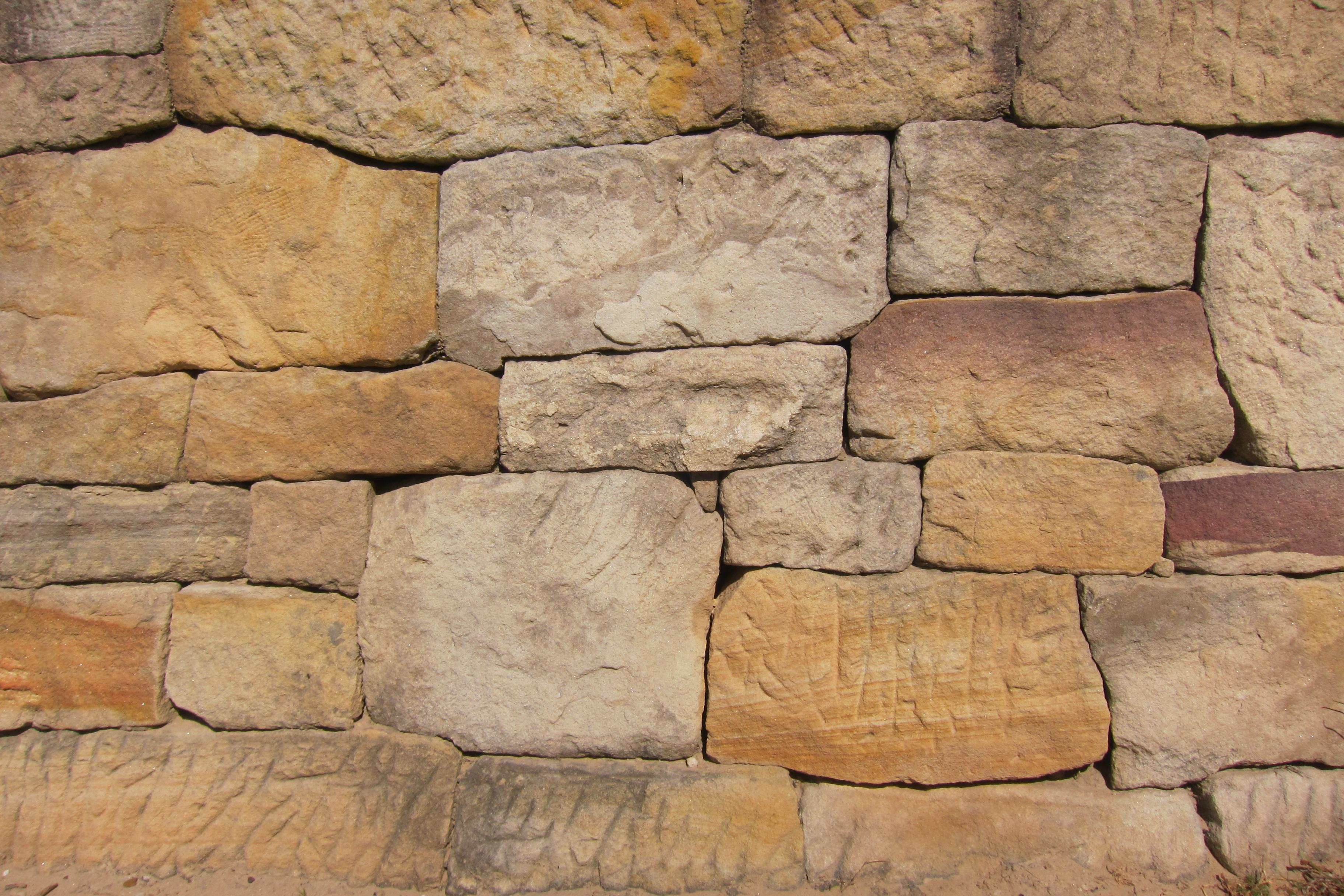

That is a posh piggery and what wonderful Ashlar work too!  It's easy to forget how much time and effort went into making agricultural buildings fit for the estate they occupied. It would be a lovely building to build. The photo I have enclosed is a similary delicious use of stone and Ashalr work, just down the road.  This is also in Sandstone and like your ruin- looks good enought to eat!
