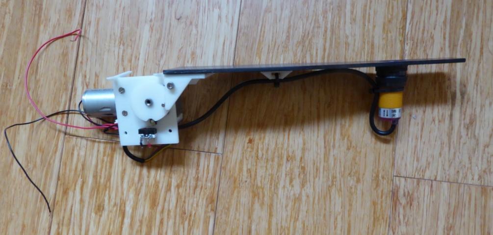

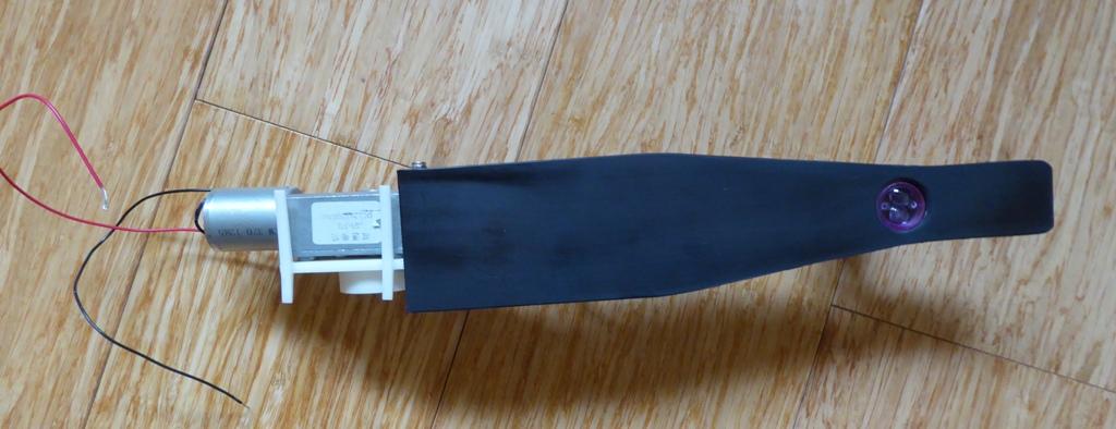

Jeremy Harris Posted October 8, 2019 Author Posted October 8, 2019 2 minutes ago, Bitpipe said: Once again @JSHarris you're coming up short of expectations. I would expect you to cobble together (from your shed of ex MOD spares) individual mouse trackers to monitor their return. Either that or blast them into space with a hobby rocket. BTW our cat is so lazy it would end up sleeping in the bucket with the mice as company. You're going to love the Mk 2 live capture mousetrap. Here's a sneak preview: The black arm can pivot downwards when the locking pin moves out of the way. This is triggered by a mouse crossing the IR proximity sensor towards the end of the arm, whilst trying to reach the peanut butter at the very end. When the arm drops, the mouse falls down into the bottom of the deep (empty) bucket and the mechanism recycles to the "cocked and ready" position, ready for the next mouse. I 3D printed the mechanism, and just need to print up a housing, plus a mount for the LCD counter module I've bought. The LCD display will be mounted remotely so that I can quickly check how many, if any, mice have been caught, so that I know when I need to empty the bucket. I might try marking the captured mice somehow, just so that I can be sure the same ones aren't coming back, although 1/2 mile seems a long trek for any mouse, especially as they also have to cross the stream. 4
