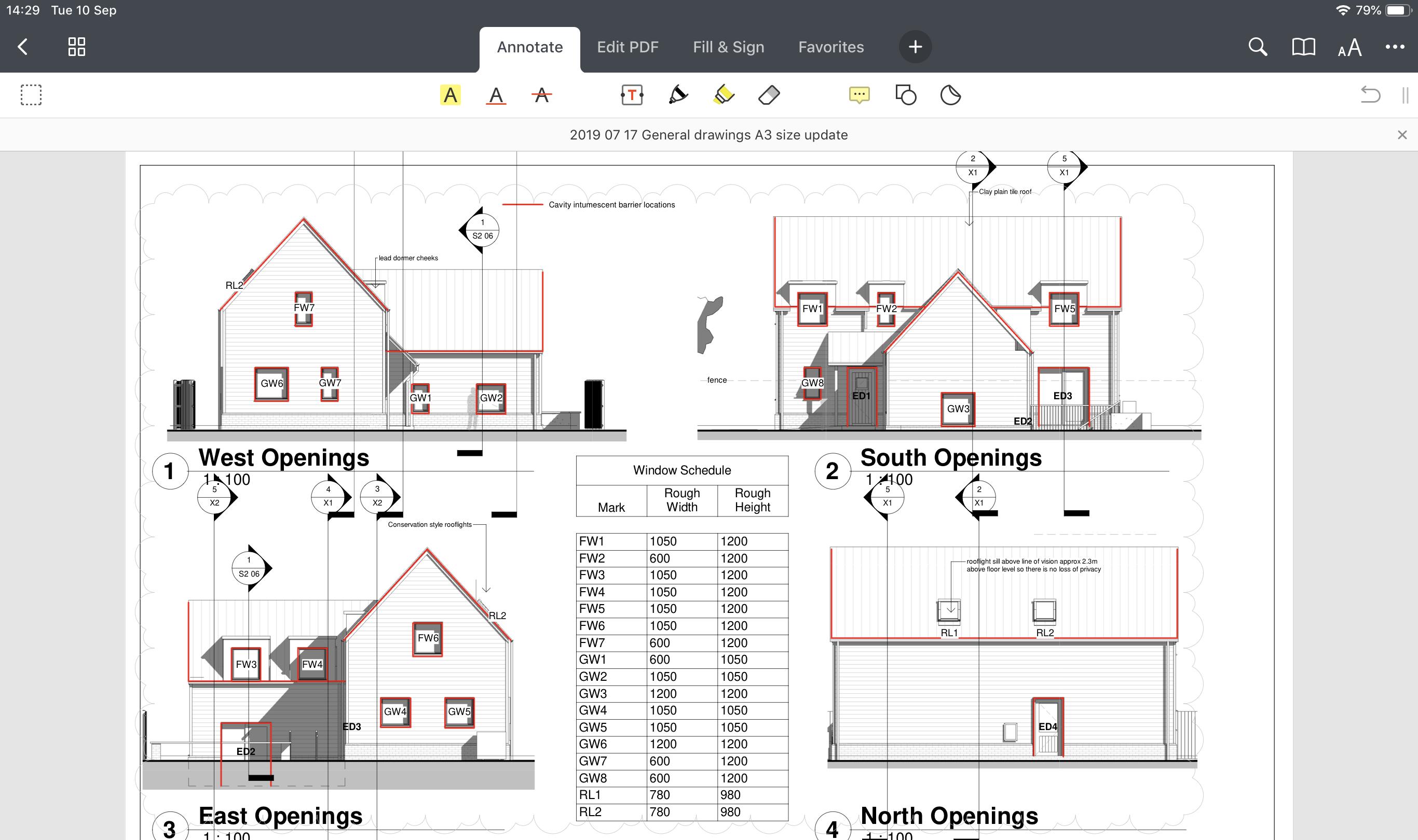

Cambs Posted September 10, 2019 Posted September 10, 2019 17 hours ago, nod said: I do a lot of fire checking on TF and others While the fireproofing is good on commercial Houses are not so good The main objective when fireproofing is to keep the fire out of the cavity The main problem is insulation Gypsun and Hilti have some great products But they are hardly ever used on houses If I was to build a TF house I would close off all window and door cavity’s with Gyp fire batt Extra cost 100s and I’d include a horizontal brake around the perimeter to check any fire reaching the roof space We are going to put intumescent barriers in the cavity and having all of the exterior timbers factory treated with HR Prof to stop spread fo fire. We need to do this anyway for at least part of the building due to proximity to the boundary and adjacent properties.
Jeremy Harris Posted September 10, 2019 Posted September 10, 2019 Worth noting that some TF houses have cavities fully filled with fire-resistant insulation, plus plasterboard provides a bit of protection from fire reaching the timber frame. Offhand I seem to remember plasterboard as lasting about 20 minutes or so before fire started to break through. BRE did some tests years ago, and I remember reading through them back when we were looking at build methods.
Ralph Posted September 10, 2019 Posted September 10, 2019 Just now, JSHarris said: Offhand I seem to remember plasterboard as lasting about 20 minutes or so before fire started to break through. From what I remember Scotframe quote a 60 minute fire resistance, 30 minutes per sheet. I would also have thought that having the cavity completely filled with injected insulation would help on the closed panel systems. 1
Jeremy Harris Posted September 10, 2019 Posted September 10, 2019 5 minutes ago, Ralph said: From what I remember Scotframe quote a 60 minute fire resistance, 30 minutes per sheet. I would also have thought that having the cavity completely filled with injected insulation would help on the closed panel systems. Yes, full fill cellulose pretty much stops fire dead, as the stuff won't sustain flames, and it tends to stop air getting to stuff that could burn. I did a couple of tests on some left over cellulose, using a blowtorch, and all it seemed to do was go black and char, it wouldn't actually burn when I took the blow torch away.
Ferdinand Posted September 10, 2019 Posted September 10, 2019 (edited) Some more on this. I had a phone call this morning with a mate who lives a mile away. It seems that the flats were probably the social housing element of a large long term development, which was done between about 20 years ago and ten years ago - with the flats being the later elements. So no excuse of "old building". (Medium rise timber frame was researched in the 1990s and famously tested at full scale in the Airship Hanger at Cardington. They then did a further project about Restoring Timber Frame After Fire on the testbed which they had just burnt down. Nothing like recycling.) According to him, there is basically little or nothing left. I expect it to be about detailing and precautions to predict from the consequences of poor detailing. I would hope the consequences will be: - Sprinklers in medium rise TF flats (assuming in high rise because of Grenfell). Medium rise TF is 4-8 stories. - More detailed mandatory supervision in multi-home blocks. - Perhaps sprinklers in TF above x storeys, where x may be 3 or 4. Ferdinand Edited September 10, 2019 by Ferdinand
