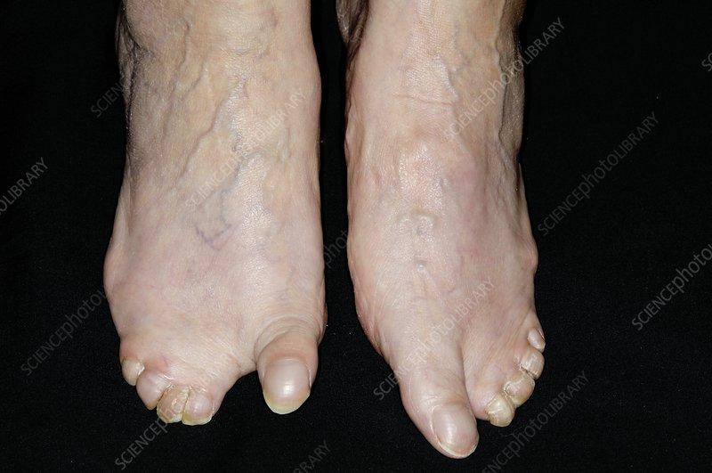

ToughButterCup Posted August 28, 2019 Author Share Posted August 28, 2019 1 hour ago, dpmiller said: it's my perception that a perfectly-smooth tile is grippier when wet than the dimpled non-slip things used round municipal swimming pools. I'd love a photo of the soles of your twinkle-toes. You got summat I want - like really really want (man). Link to comment Share on other sites More sharing options...

SteamyTea Posted August 28, 2019 Share Posted August 28, 2019 4 minutes ago, AnonymousBosch said: I'd love a photo of the soles of your twinkle-toes Pervert. These are popular in Penwith. Goes well with flip-flops. Link to comment Share on other sites More sharing options...
