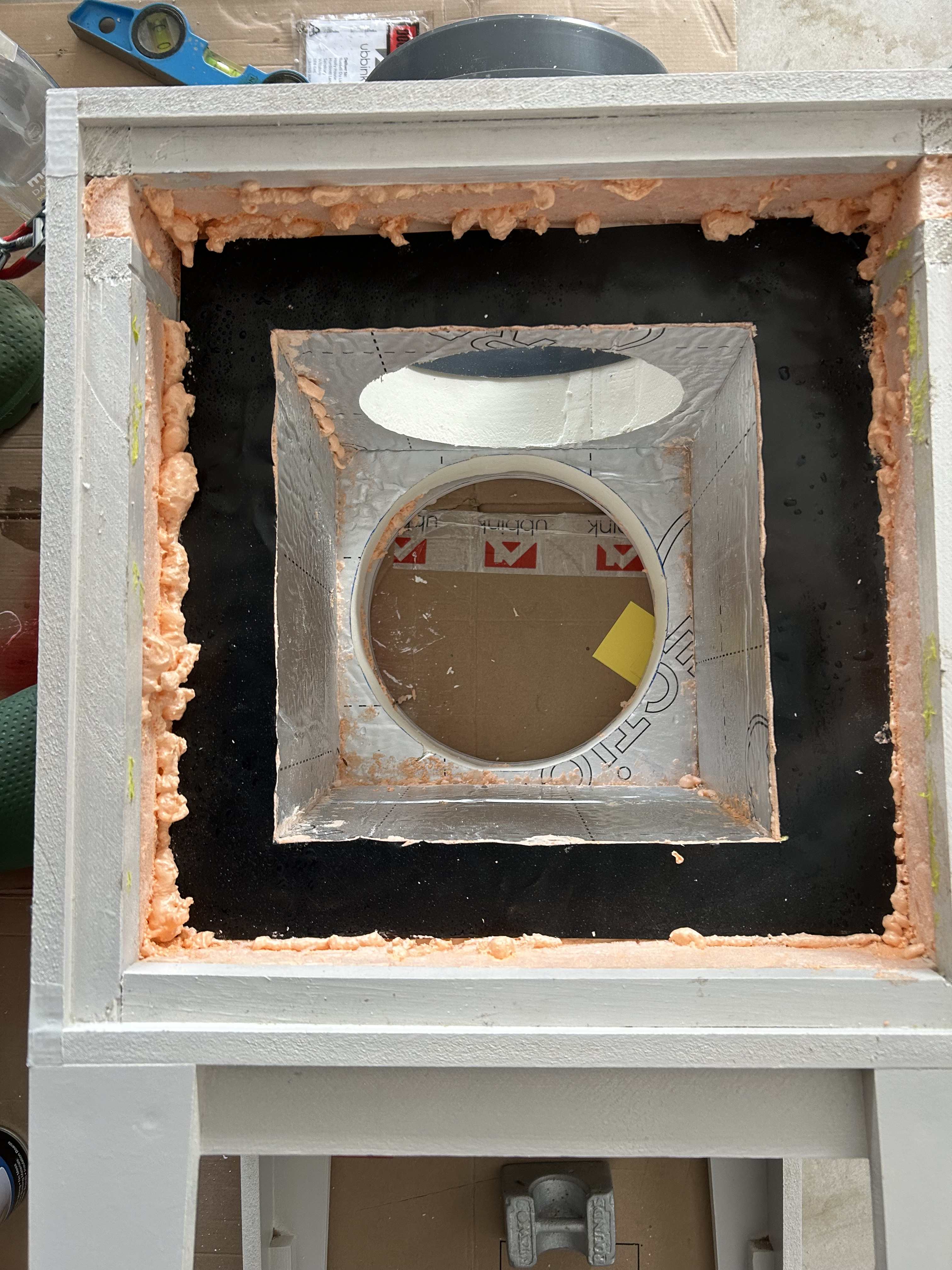

I was thinking I could do with something like a ply backed PIR - which of course I've now discovered does exist!
As I have a sheet of insulation left over from the garage build I think I'll experiment with the local reinforcement idea, or maybe make my own PIR backed plywood sections, or perhaps a combination of the two.
What would be the best way of adhering foil backed insulation to plywood?
Spray foam, allow to flash off and not stick fingers when touching and squish together (dampen surface first). Bit like foaming plasterboard to the wall.
Or you can use double sided tape, the decent scrim stuff used for sticking vapour membrane together.

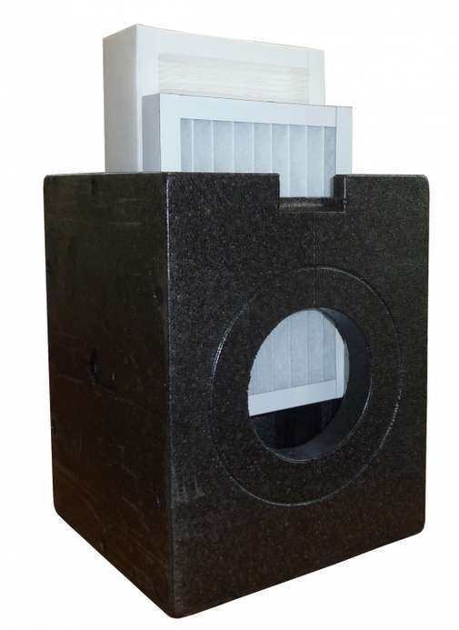

If you're willing to forego the DIY & the 90° bend, you may be able to buy them.
The Zehnder IsoBox, for example, is made from EPP, has a DN160 connection & can take a pre-filter, a carbon filter, or both. Or a DIY filter, I guess. Paul used to sell them in the UK.
I guess that other manufactures may make similar for larger ducts.

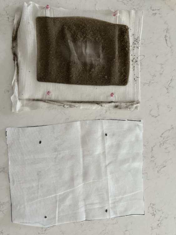

Hi all,
New member here. I read this thread with interest, as my new MVHR F7 filter became black with muck and flies in just a few weeks (ugh).

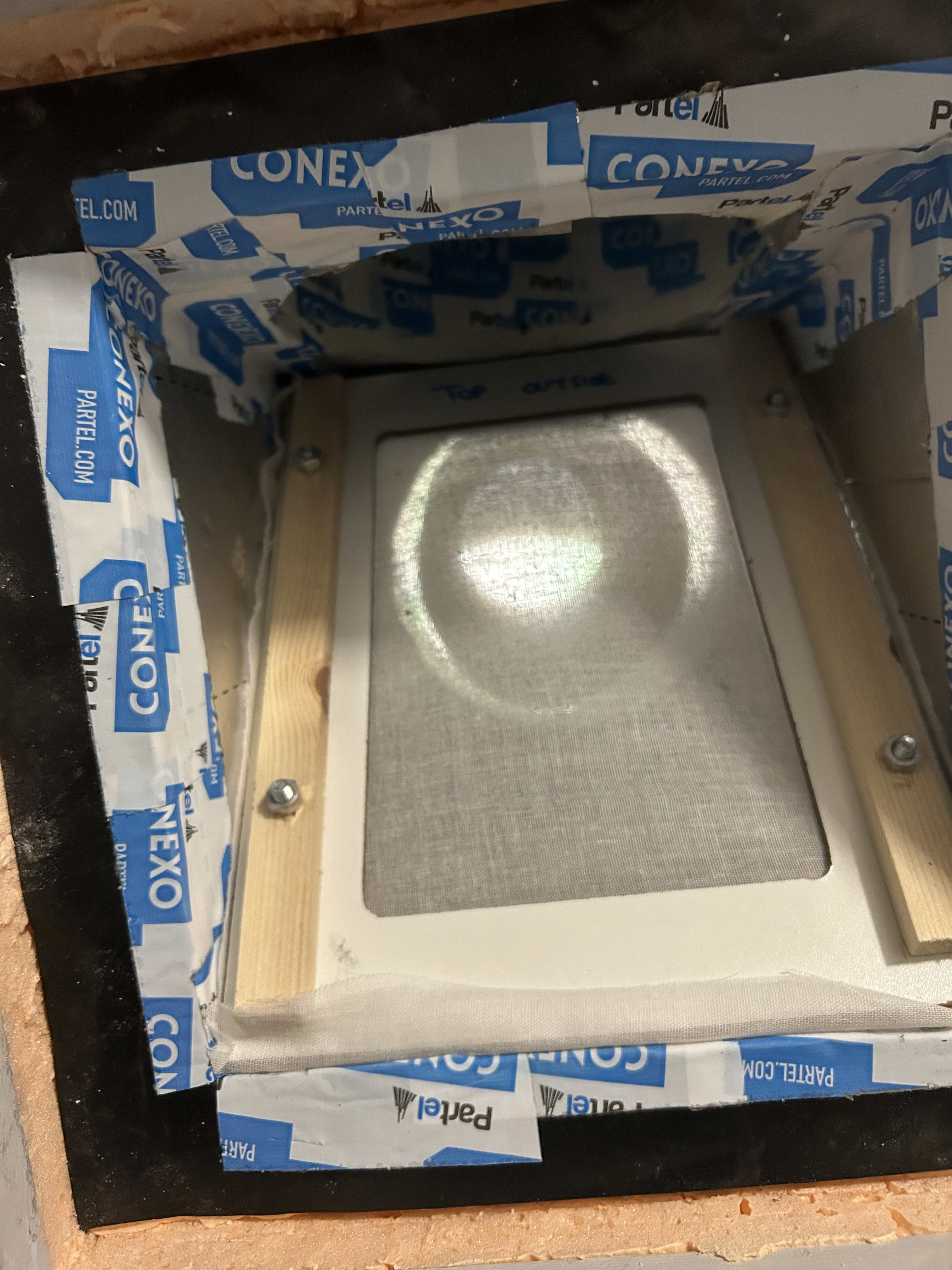

One question I had for @Russdl while looking at the photo of the grime-covered filter was, have you considered putting it in the box at 45 degrees? From the photo it looks like nearly all the air flow across the mesh is through a circle which is against the duct that's behind it. But with the mesh at 45 degrees you'd have a much larger air flow surface area (the diagonal of the side of the box, by the width of the box) which should mean less pressure drop, and a longer time before it becomes clogged. (Just my 2p's worth - I wish I had space for such a big pre-filter!)
As it happens, that is exactly what I did during the mid life refurb!
It is so much better, shame I couldn’t work it/you weren’t available when I made the Mk1!
I’ve also increased the insulation and air tightness with some left over bits and pieces. My pre filter material is now some fine mesh muslin material that costs pence and works like a charm.

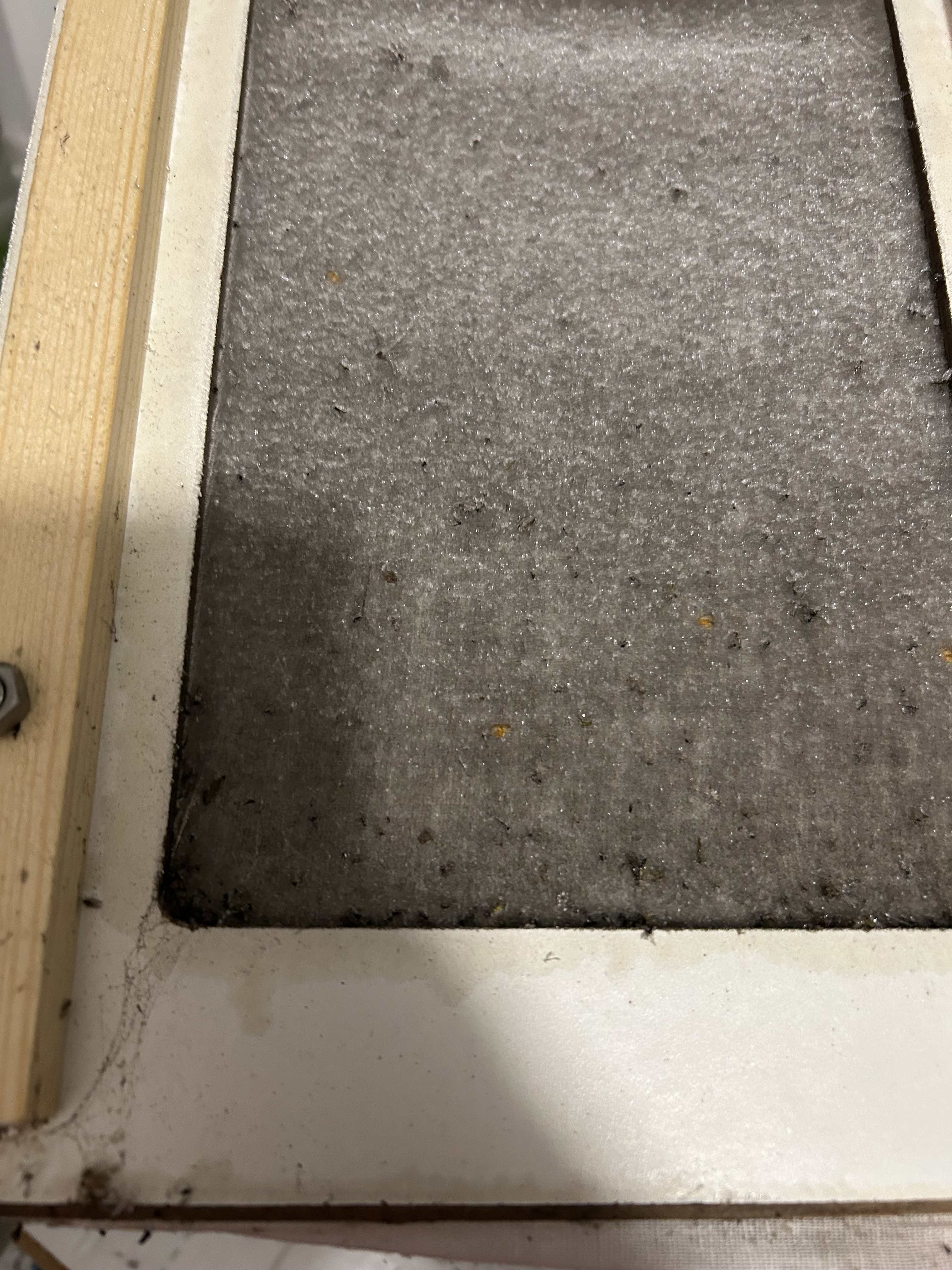

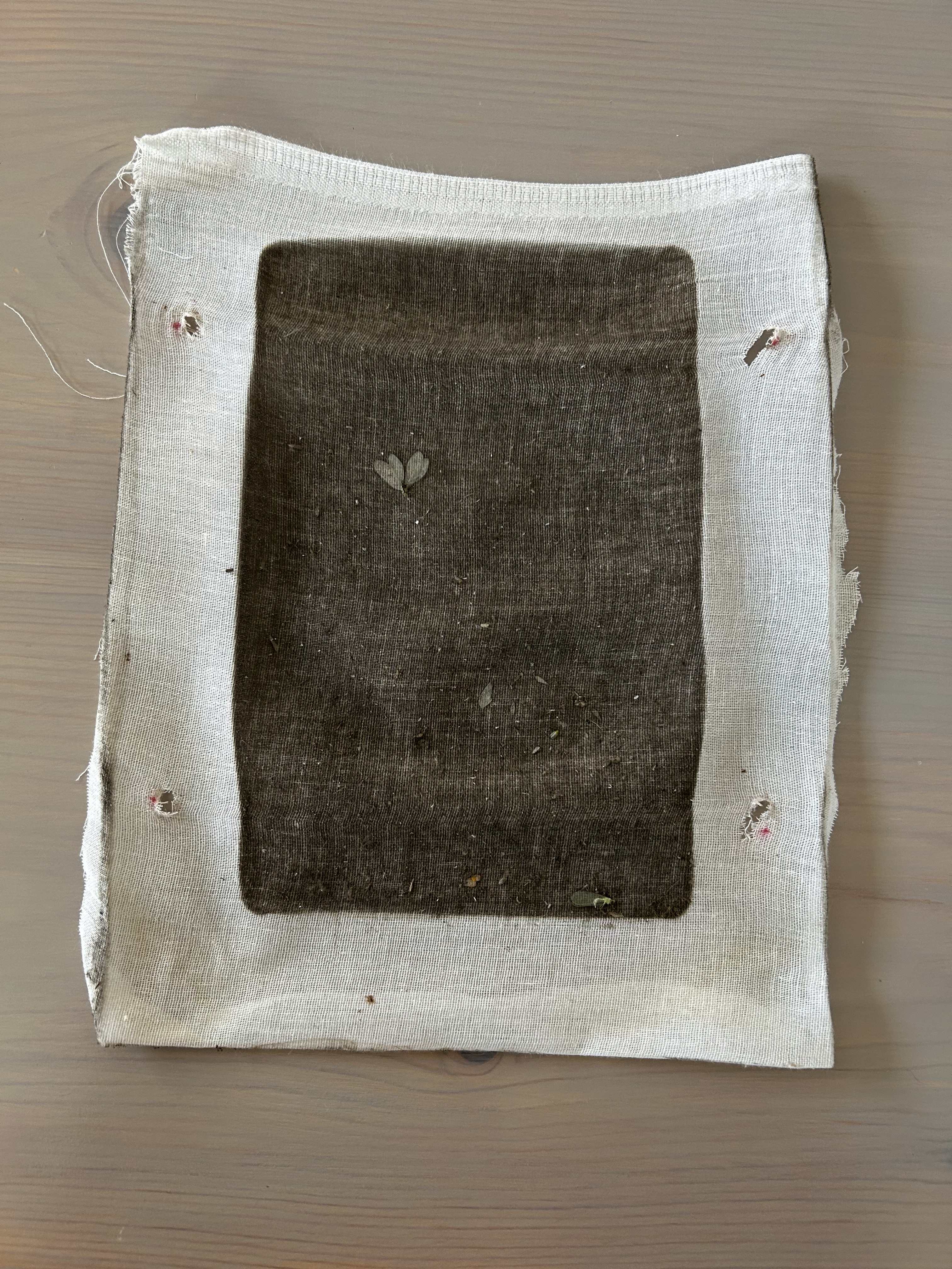

3 months after commissioning the new and improved Mk2 Pre Filter box it was time to change the filter material.
The muslin seems to be doing a grand job and the increase in useable filter surface area is being fully exploited by dust and flies.
Wow, that filter really is doing its job well! That colour change really is astounding.
I was quite taken aback by how dirty it got in what was a relatively short period of time.
I suspect the farming going on close by may have contributed significant dust. It’ll be interesting to see what the new filter is like in three months time with very little farm activity.

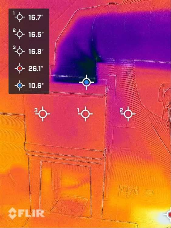

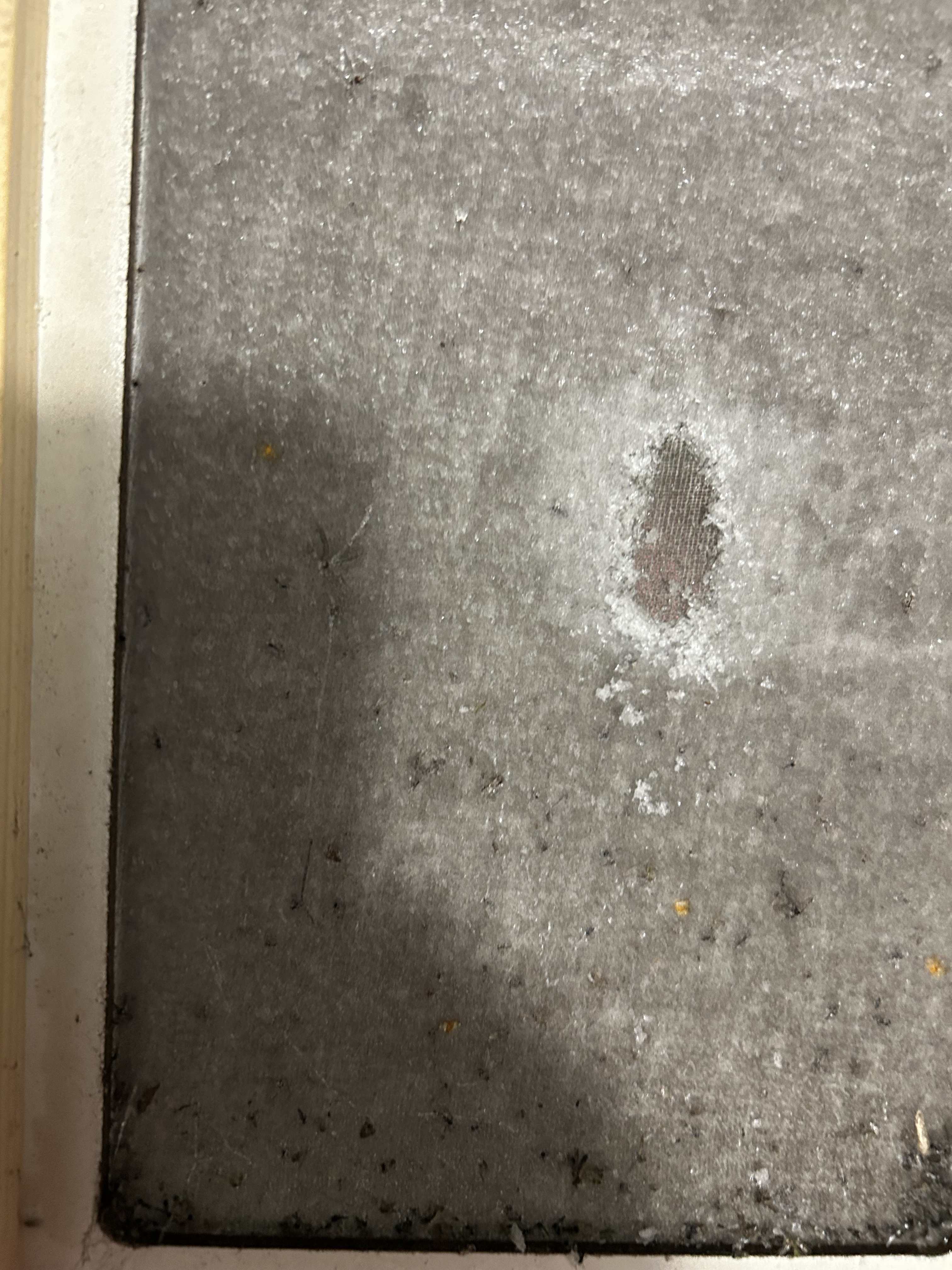

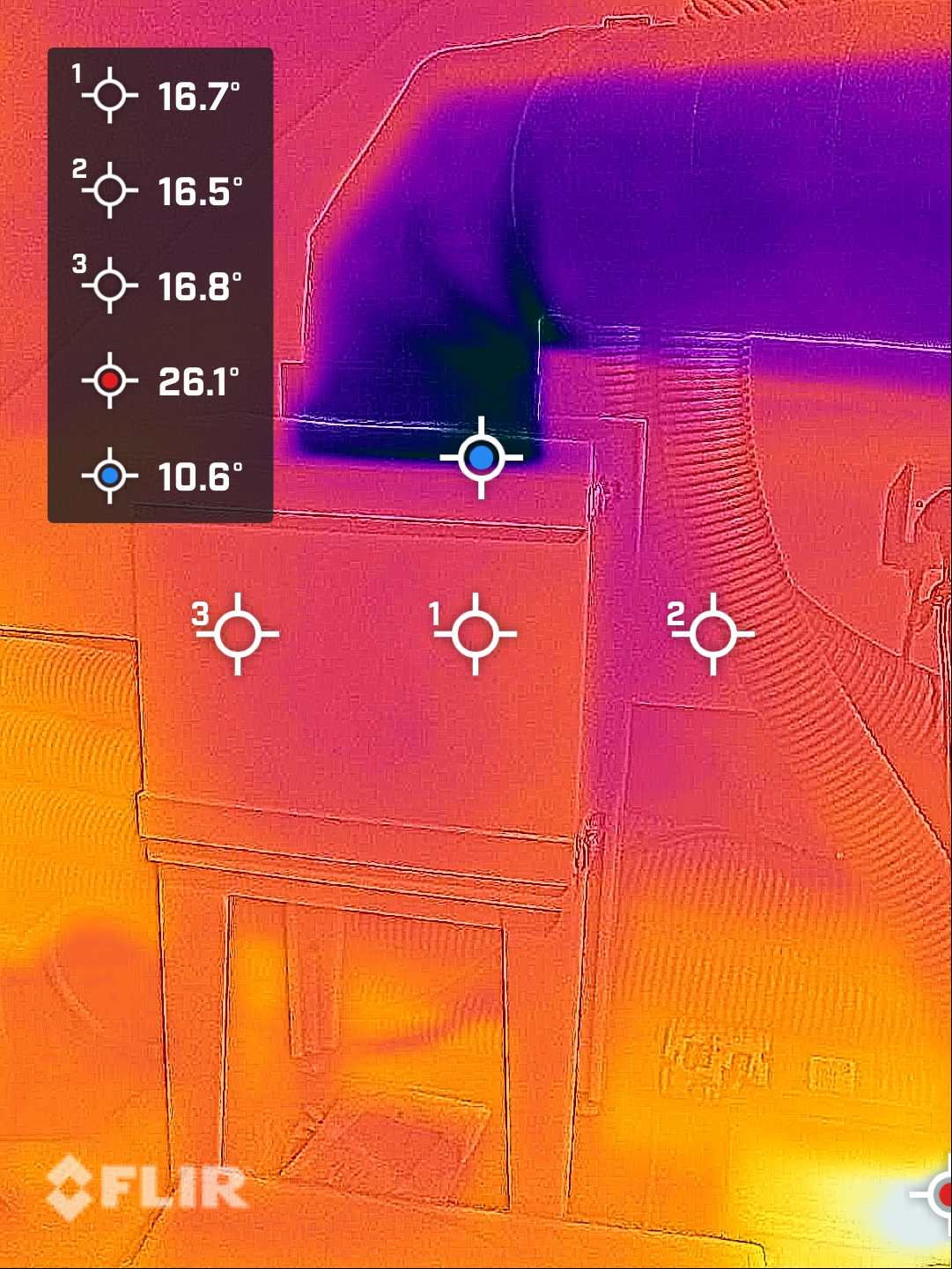

It’s chilly and foggy outside and the ‘Mk2’ insulated pre filter box is performing admirably. The Ubink insulated ducting being the coldest thing in the MVHR room now.
It did seem to seem to be noisier/running faster than normal. I had my suspicions that the pre filter mesh may be getting clogged again, I also had my suspicion that freezing fog may be having an adverse affect on the air permeability of the fine mesh…
Turns out the freezing fog was playing a major role in restricting air flow.

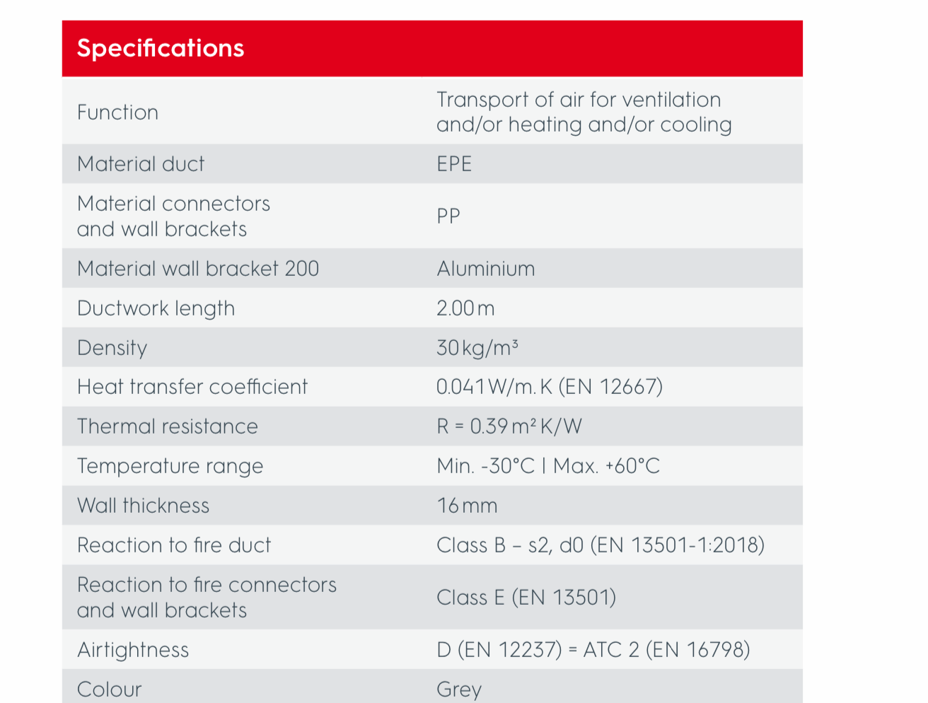

I am a little surprised by the thermal performance of the Ubbink insulated ducts.
Is this the Aerofoam product? Thermal Spec is 0.041W/m.K
The Zehnder insulated ducts were too big for my plant room, but I did buy a 1 metre length. Their U-value is 0.035W/m.K
What was the outside temp when you took the photo? 0°C?
The insulation on the filter box is great.
I’ve used 32mm armaflex with steel spiral ducting, I hope that performs. System still not commissioned, so will have to wait to get a similar thermal image.
Yep, this stuff.
It was around -2 when I took the photo and been negative temps for about 8hrs I think.
I didn’t think +10 was too bad but I haven’t done the sums (Steamy will do those I suspect).
Actually the foam is probably a degree or so warmer than the +10, that coldest spot is the plastic Ubbink connector.
