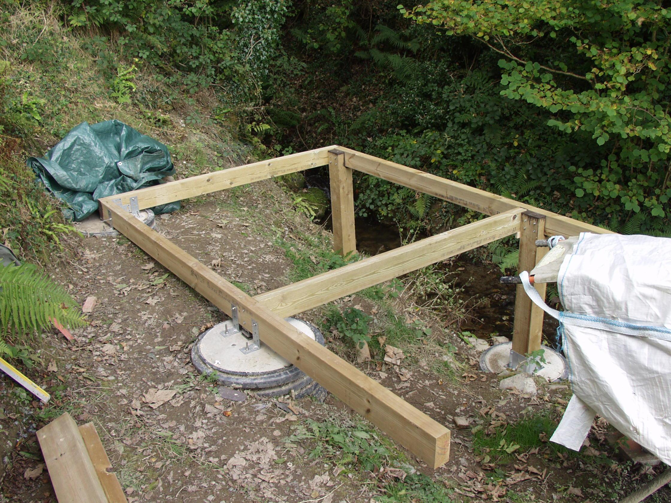

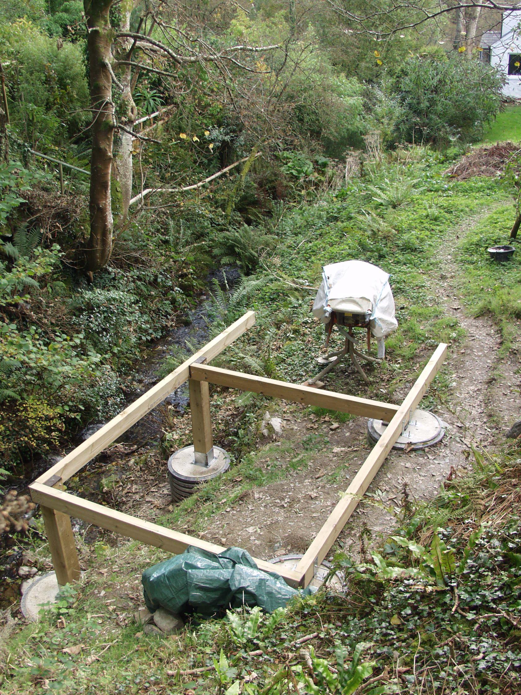

zoothorn Posted October 22, 2019 Author Posted October 22, 2019 On 10/10/2019 at 20:31, Onoff said: I whacked in loads of concrete screws with my 110V Makita SDS with a chuck adapter in and a Torx bit in it. Seemed to work. I'm really struggling & I'm finding this project extremely difficult. Ive got my L two beams, pillars cut/ notched in shoes, & the 2nd long beam on the pillars. All dry run. Its taken 2 full days to do just this, (4th front beam just cut & end cuprinol'd so another day to dry) & I just cannot get the pillars plumb. I can get diagonal lengths equal, but not the distance between the long beams by 1/2": why this is so is a mystery. The main problem is the pillar shoes on the pads. They're not stable & rock on one corner. So the only way of getting them to sit more or less solidly (IE with the shoes flat enough on pads) is slightly tilted. Its not noticeably so, but the level-bubble is end of its liquid on both sides. As to the resin thing- which I'm considering trying at least a few brackets into concrete by end of week, on the top pads: I have a total of 16 fix points with 12mm holes @ depth of 100mm (for my 10mm dia bars) 8x for 'L' shape brackets (top pads), 8x for the pillar shoes (btm pads). How do I progress using the tube of fisher? I mean I have no idea how much of the stuff I'll use for 4 holes, let alone 16. Are 16 too many? how long to set/ continue with job & fix the bracket on?

Declan52 Posted October 23, 2019 Posted October 23, 2019 You can't try to put the rest of the frame up unless you get the uprights plumb. Further down the line this will cause more and more issues so fix it first. What are we talking, a 2 mm gap or a 20mm gap to make the shoe sit level and plumb?? Your idea about lifting the bolt up should work but the threads have to be clean or you won't get the nut of.
zoothorn Posted October 23, 2019 Author Posted October 23, 2019 1 hour ago, Declan52 said: You can't try to put the rest of the frame up unless you get the uprights plumb. Further down the line this will cause more and more issues so fix it first. What are we talking, a 2 mm gap or a 20mm gap to make the shoe sit level and plumb?? Your idea about lifting the bolt up should work but the threads have to be clean or you won't get the nut of. Actually the back post is happy slightly non-plumb & back beam 1 & the long side beam sitting on its notch are solid: I mean yes prob talking 5 mm's not 20mm/ IE.. it looks ok. Other beam rocks a bit even so (uneven underneath) but I hope once shoe base forced to pad with nut pressure, bending it a mite on cnrs.. it might get solid. Its a damn tricky proposition for me, to get all the pillars & beams plumb & spot-on level doing this 1st time.. I'm gonna have to compromise a bit or I'll just never get the damn thing up. I was thinking of wrapping masking tape round nut underside to protect it & thread top bit from the resin.
zoothorn Posted October 23, 2019 Author Posted October 23, 2019 @Declan52 can you cut off excess resin @ the top, once its set? is this the idea.. or to wipe off after inserting the rod? And the tube of fisher resin: I have 2 nozzles, but no info as to why/ how to use. Can you remind me how, if I can, make best use of the 2? without knowing how this stuff behaves & "sets in nozzle".. Im going at this in a bit of a panic, blind as it were. I have only 1 shot at this so must prep best I can.. holes 1-2cm too deep isn't ideal but can't rectify. Tbh thunderbolts were the route I should've gone I think.
Declan52 Posted October 23, 2019 Posted October 23, 2019 Cut a small bit of the tip of the nozzle so you have more control over the amount that comes out. As it expands you can either wipe it off or let it expand fully before you clean it. I would do it a pad at a time. Squirt into the hole and drop the bolt then watch it expand and once it's stopped a quick wipe then onto the next one and just repeat. Your having major issues putting bolts into soft timber so concrete wouldn't have been any easier.

zoothorn Posted October 23, 2019 Author Posted October 23, 2019 Somewhat of a disaster- resin went in ok but cleaning the holes before was almost impossible I found.. tho did my best (5 hours cleaning them ny'day & today) so my hole depth decreaced from 9.5cm to ~ 6cm & so bar protruding/ needed cutting off (as impossible to drill a perfectly vertical hole) > deburring with angle grinder > one nut stuck solid > bar shifted in resin trying to undo it, or force it down. A mare of a day.
zoothorn Posted October 24, 2019 Author Posted October 24, 2019 @Declan52 or @PeterW or @Onoff Done my outer frame at last.. & I'm onto my joists. What distance between joists across would you suggest? if I have the hanger brackets, & I need to add a centre noggin, I need to get a hammer in between joists to fix the brackets. Or is the idea fix the centre noggin brackets (I assume noggins don't need to be staggered) onto the joists, one each side of the middle, before joists are lowered into place-? Thanks. Pics of it when time.. rush on b4 the rain hits t'nite for 2 days.
zoothorn Posted October 24, 2019 Author Posted October 24, 2019 I have a distance of 217cm to span both ways. Is it 400mm centre marks or something, or is that figure for pB?
zoothorn Posted October 24, 2019 Author Posted October 24, 2019 @Onoff @Declan52 @PeterW .. I need to do my 6x2 joists asap, so if you could help on what figure to space them at (I have 2170mm to span).. thanks alot chaps. 1
